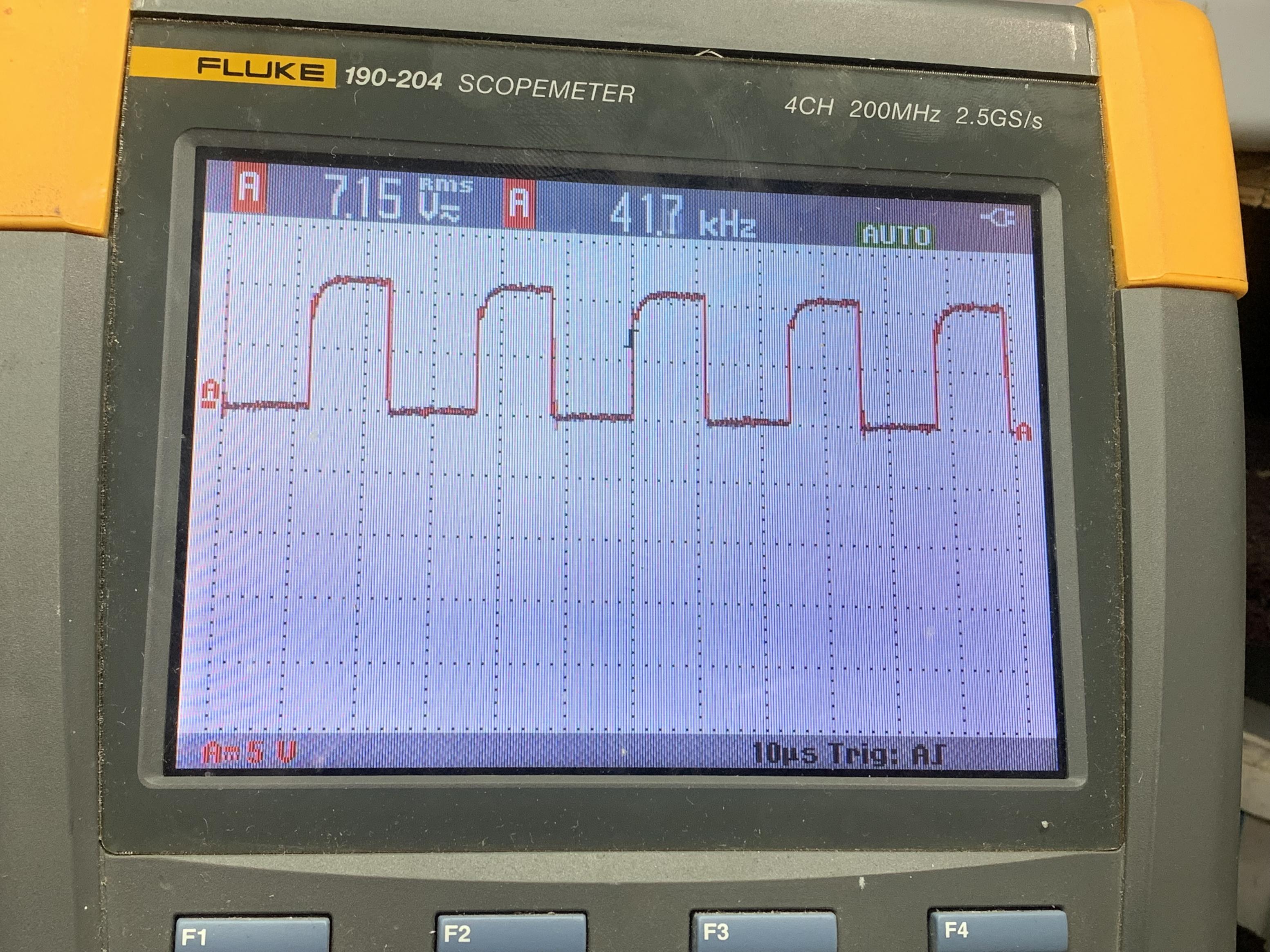

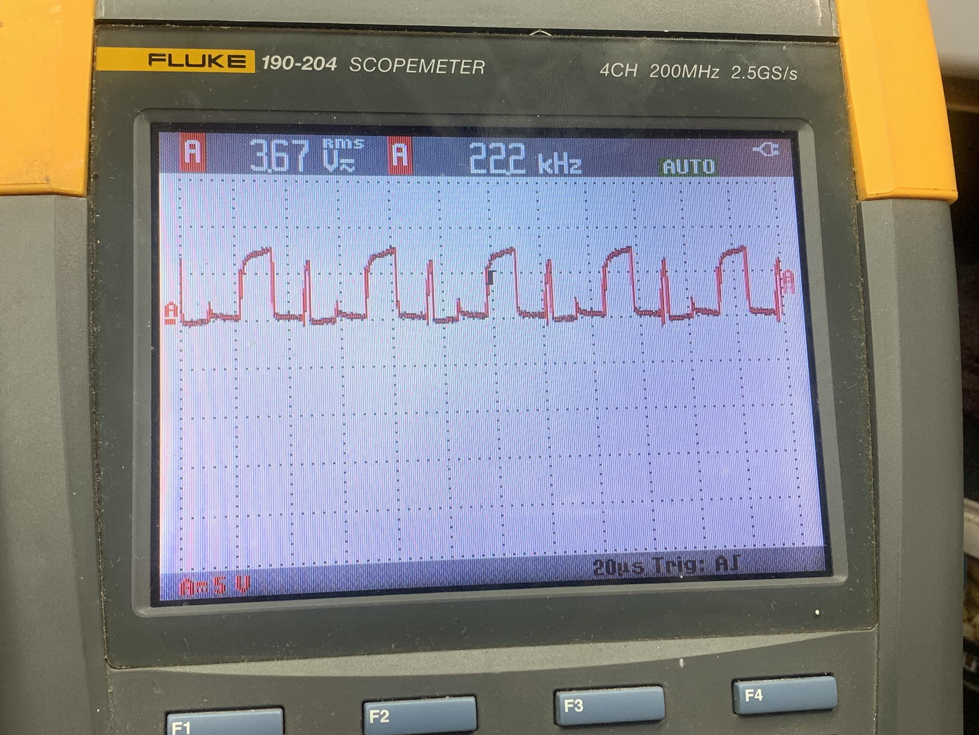

looking at the gate drives, I got a somewhat irregular waveform on both lowsides FETs G-S, I checked through the drive components in circuit and they tested ok, both IR2010S have clean square waves entering. I replaced both drivers and this remedied only one low side gate drive the other remained the same.
I've attached a pic of the suspicious waveform, the scope is reading this as roughly half the freq (22.2khz) of the other sides of the bridge (41.8khz). The drivers are new Mouser units and I used as minimal heat as possible.
Would this warrant another replacement driver? or another of the drive components?

I replaced only the driver for the half bridge with the "lower" oscillating freq, but no change.

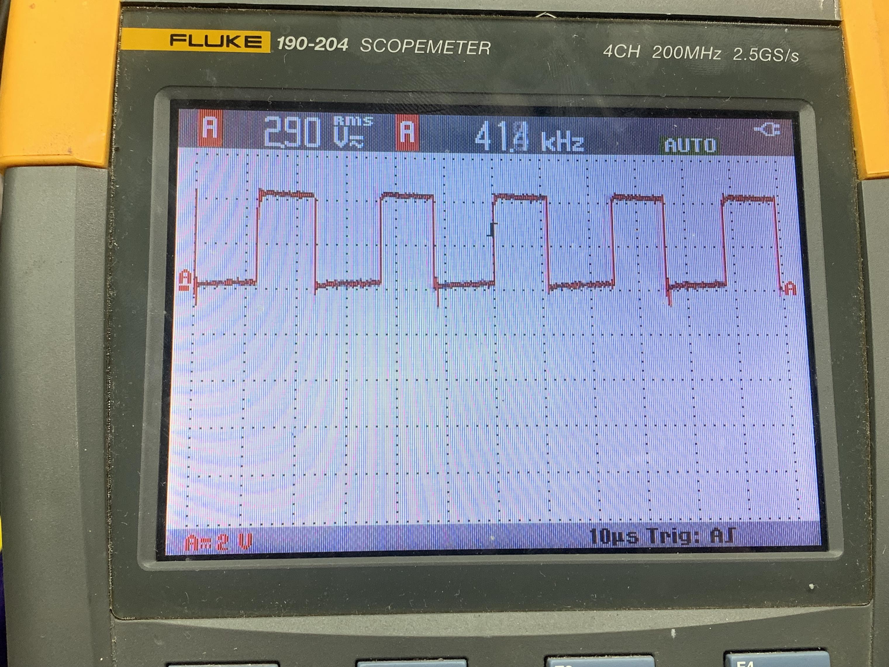

I pulled both FETs : FET2 and FET19 (IRFP4768), and checked out of circuit, both tested ok, installed one at a time and amplifier produces a clean gate drive now with correct 41khz oscillation. I swapped around the FETs to confirm this one is defective and it confirmed it.
The offset now settles around 100mv, however I still have the -3v turn on thump which quickly settles and the protect LED is lit dim.
