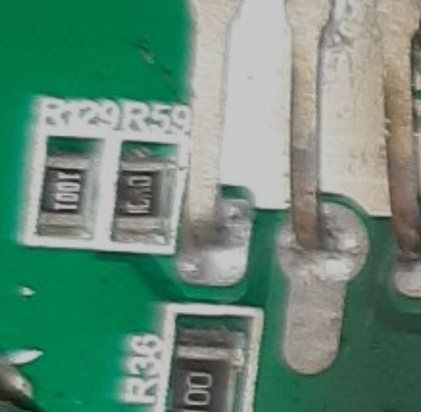

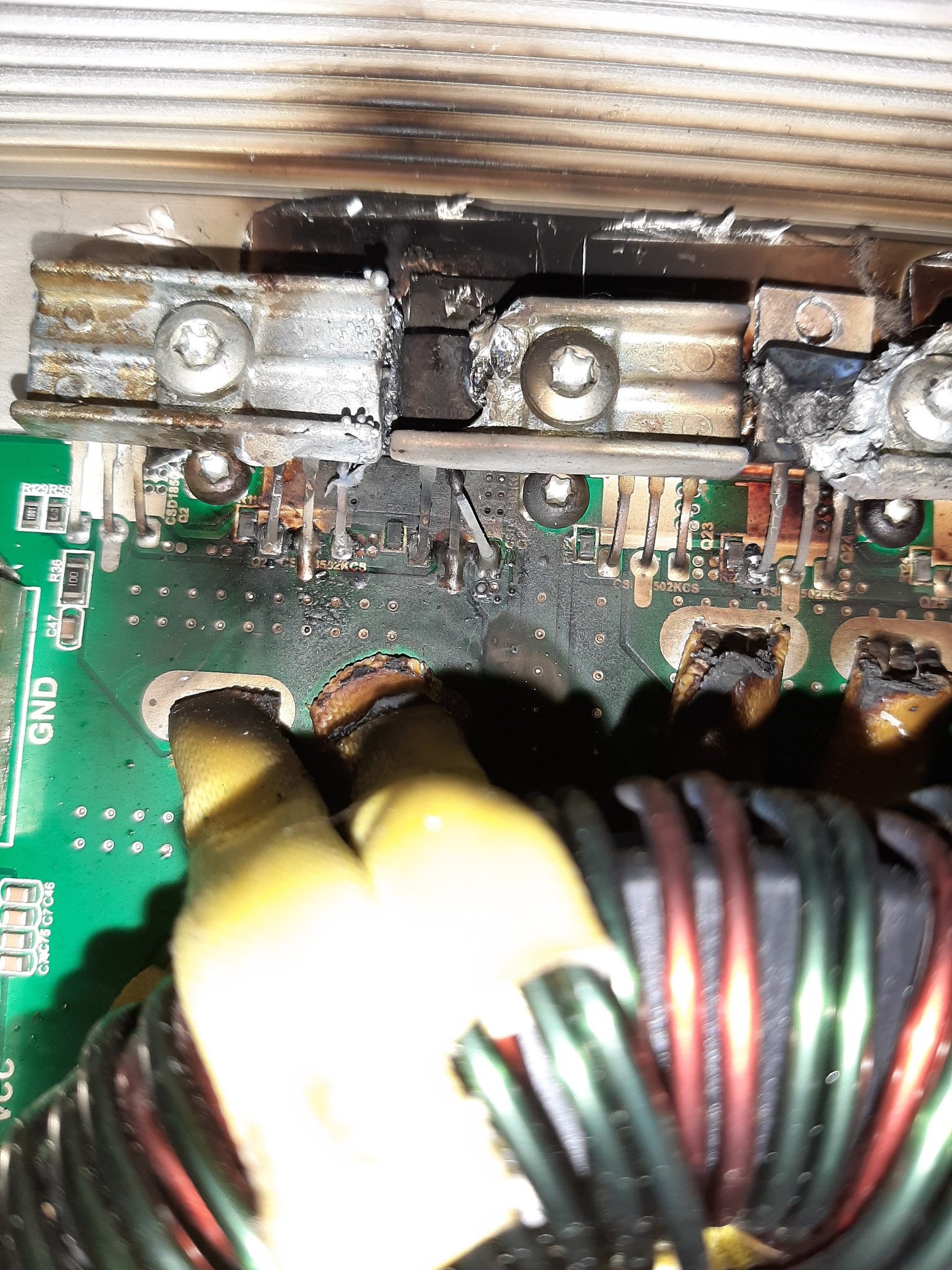

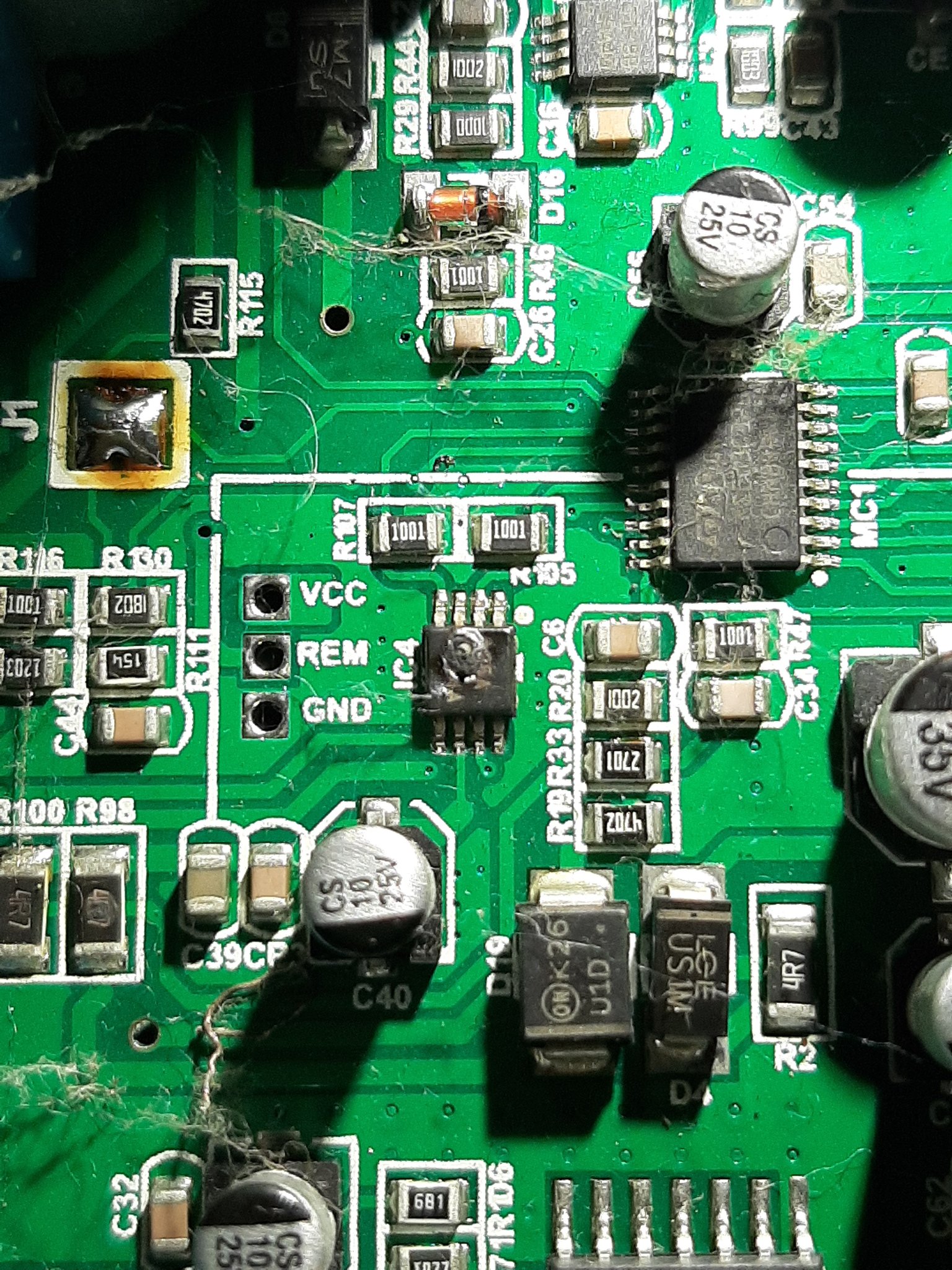

Hello,
The amplifier burned out, do you have the value of the grid resistor and the reference for IC4 ?

Looking at the picture you have provided that resistor looks like a 10r. Without knowing the version that you have it is hard to say. @ultra mentioned this. If you use IRF1404 in the power supply like the MD 8000, you can use 10r resistors. As per the schematic that I have for the MD8k with the IRF1404 they use 10r resistors.
