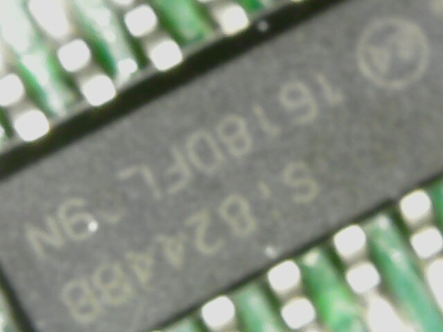

Both go into protect even with all of the output mosfets off so I'm going assume it has a bad drive circuit. On the 15k HD I took IC1 and IC2 off and it no longer goes into protect so I think they are the drive ICs but I can't find a data sheet or them for sale on mouser or anything. The part number on top is S18244BB. So here are my questions. Are these the drive ICs or am I crazy? And where can I get some new ones or what is a good replacement?

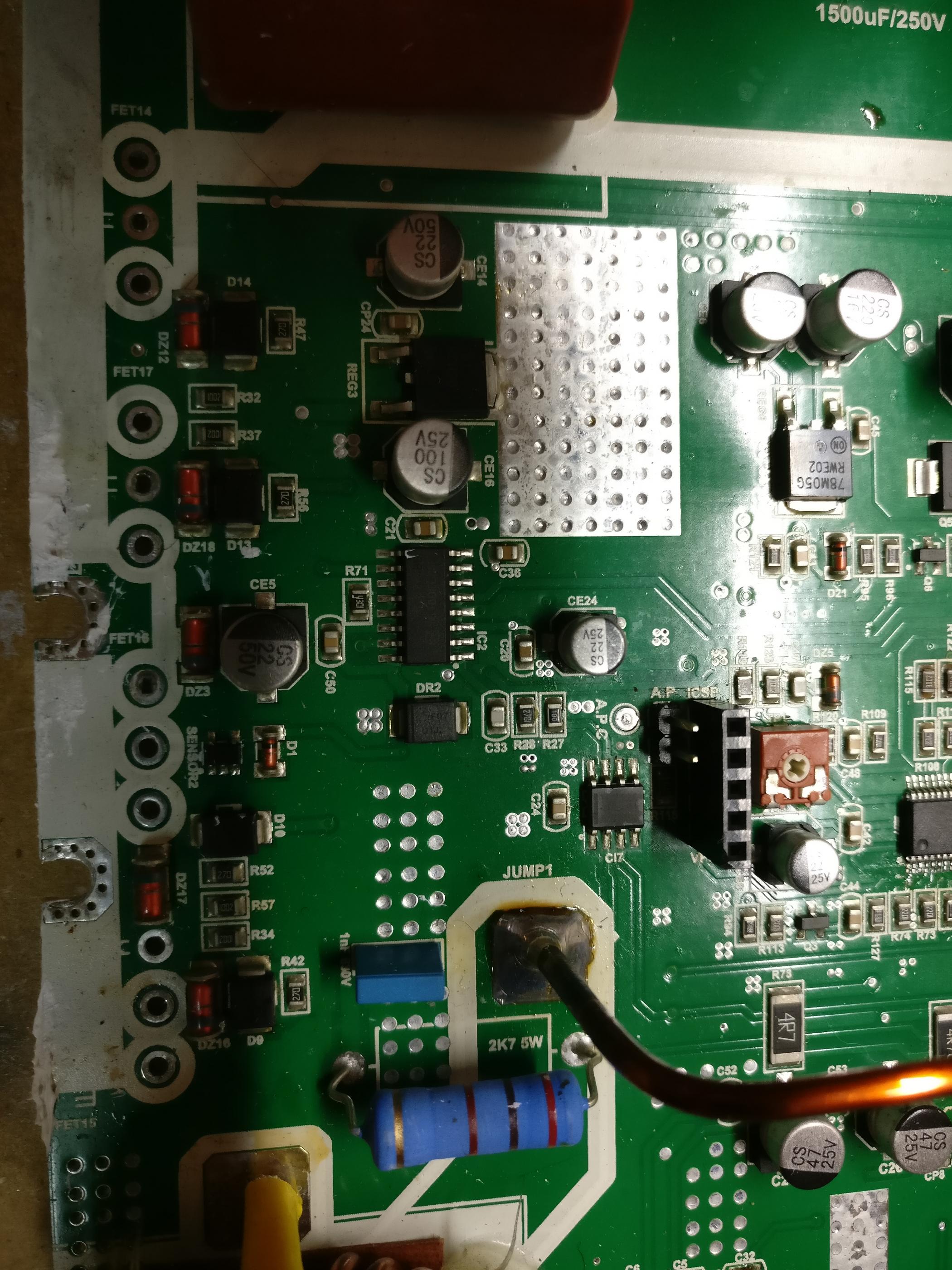

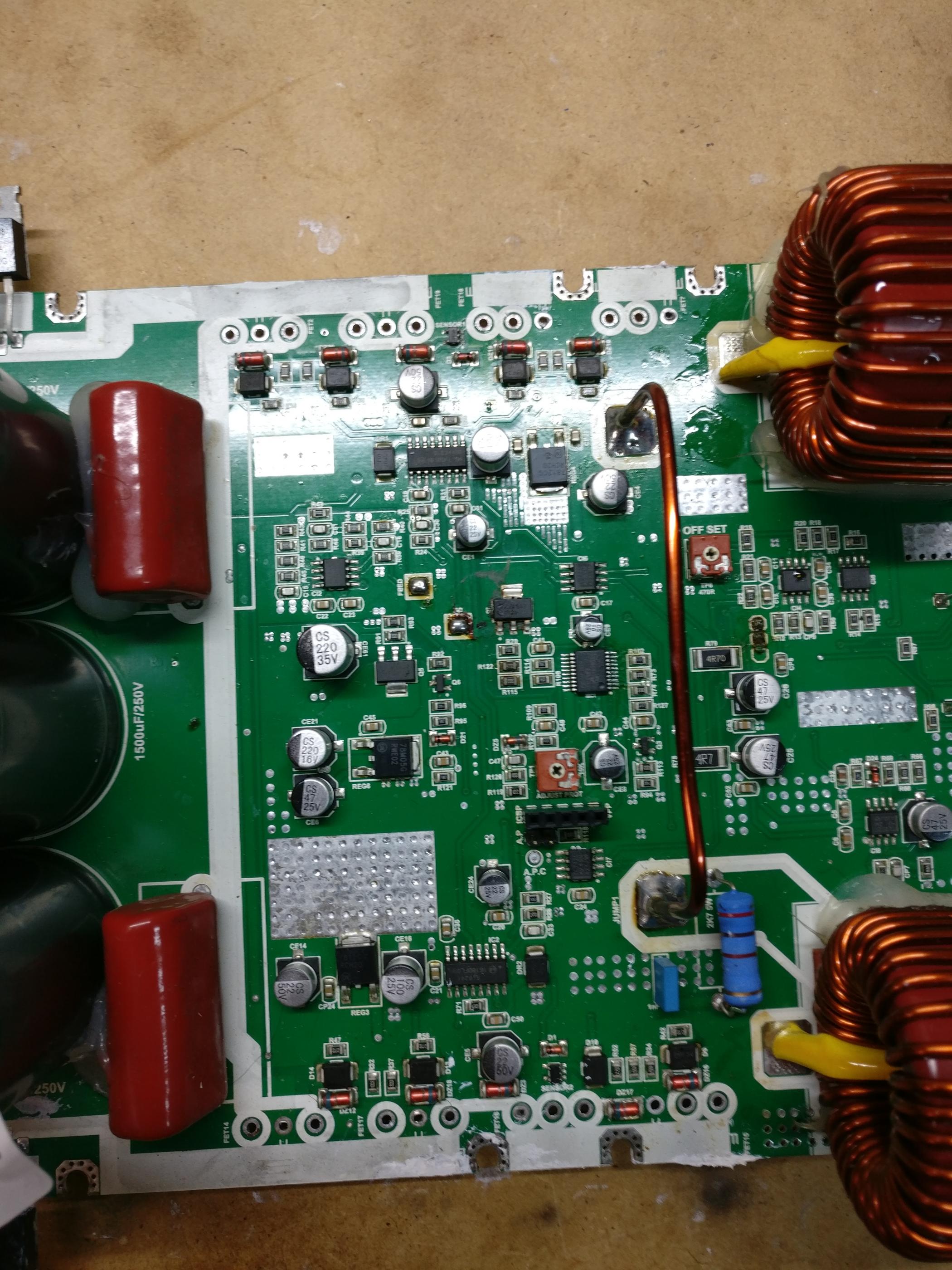

Attached are the requested photos. I attached the photos of the 10k the 15k HD looks exactly the same on the output section the only difference was the fets.
The 15k pulls about 2 amps which seems a little high for just idling with no output fet and no driver IC on it. but nothing is getting hot. maybe that is just because its turning 12v dc into 150 on the rails lol. I would hate to shock myself with this one.

When I remove the S18244BB it stops going into protect so I am guessing they are at fault.
The TL712c I was able to find the datasheet on. Before I start probing it with the scope what ground point should I use? The main ground or the RCA ground. Sorry for the noob question this is just my first amplifier to get this in depth on it.
Btw thank you so much haha. I've been reading that as a 1 this whole time which is why I couldn't find it's si8244bb

The amplifier must be fully assembled so that it does not enter protection. Normally when the igbt is shorted, it is necessary to replace SI8244BB and check the zener 15v that are not shorted. install the new transistores igbt and turn on.
Just updating where I'm at right now with it. On the 10k it does have 3 bad 15v zener diodes so I will get more when I order the mosfets for these boards. The 15k all the diodes tested out fine.
Just a quick update on the amplifiers. The 10k I replaced the bad zener diodes with melf 1w 15 volt, put the new fets(same as came off) and new drive ICs on it. Works good. Not seeing any issues. The 15k did the same with it and the low side fets run hot even on the heatsink. I am letting it cool back down and then I will get a reading of the drive waves. It's doing it on both sides of the amp but only on the low side.

I just wanted to give an update on on this for anyone in the future. So I got fed up on the 15k because I couldn't find anything wrong with the 15k other than in was getting burning hot really fast for no reason so I reflowed the whole output section and now it's running nice and cool so maybe I should get that microscope I want haha. Must have been a cracked solder joint.

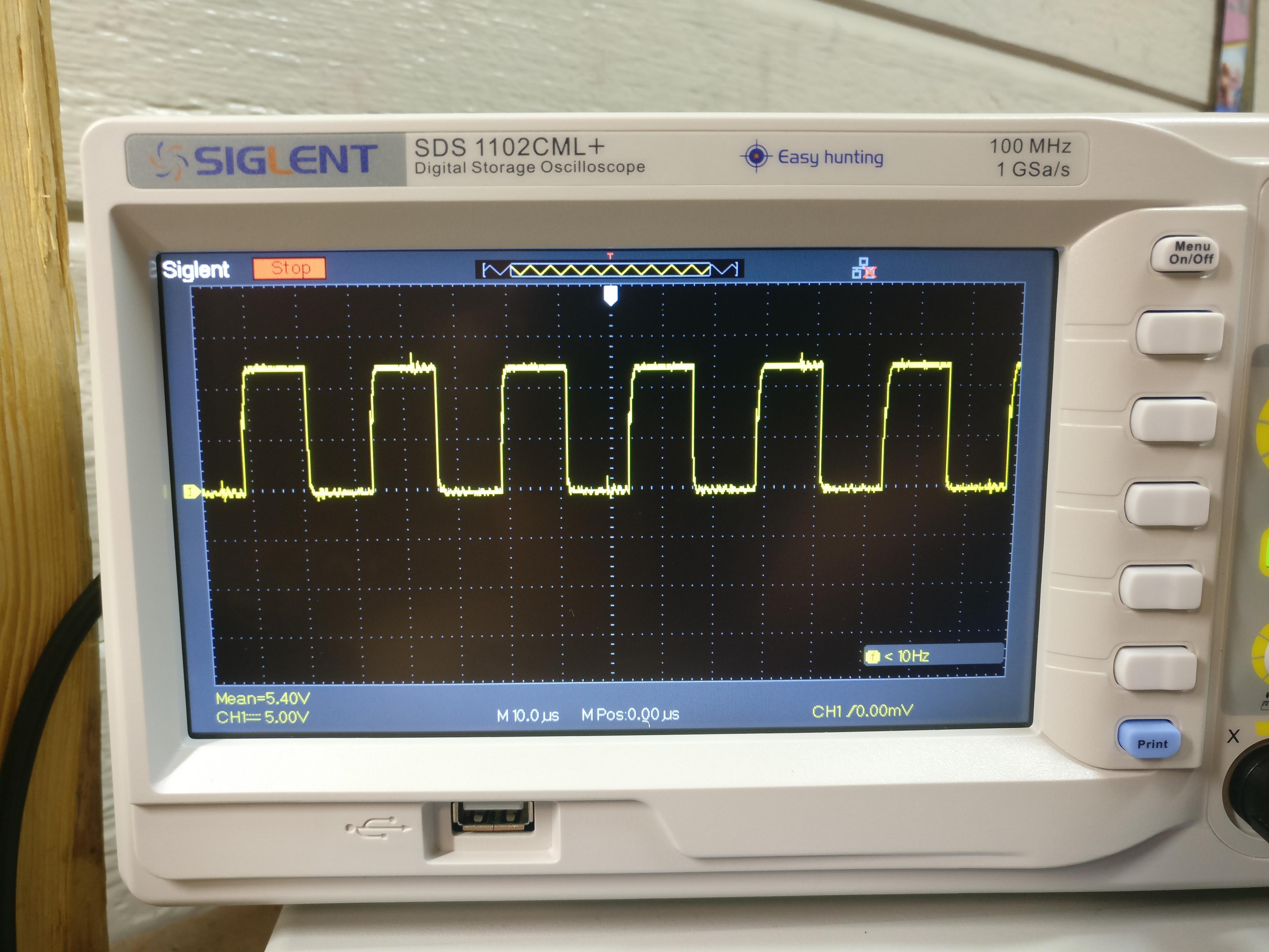

Could you please measure the voltage across DZ1 at idle and measure the voltage out of pin 15 of the driver IC beside DR1? I’m curious to know what that voltage is compared to the amp I have. My voltage is 10.56V. I’m thinking it should be higher but Taramps is saying that the FET could be pulling it down. The rest of the driver output voltages are in the 12V range.

Ok so I'm home now. On the 10k Dz1 has mean voltage of 140(switching at 40khz) on it I'll get the 15k back out later and measure it.
Pin 15 on ic2 is between 12-16 volts it's also switching
