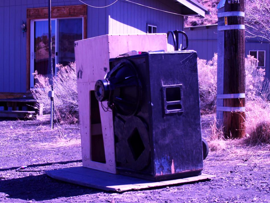

I’m calling it the “Keystone” TH, the exit is shaped like a keystone. Dimensions are 45 x 26.5 x 22.5 inch, 15.5 cubic feet (440 liters) external volume.

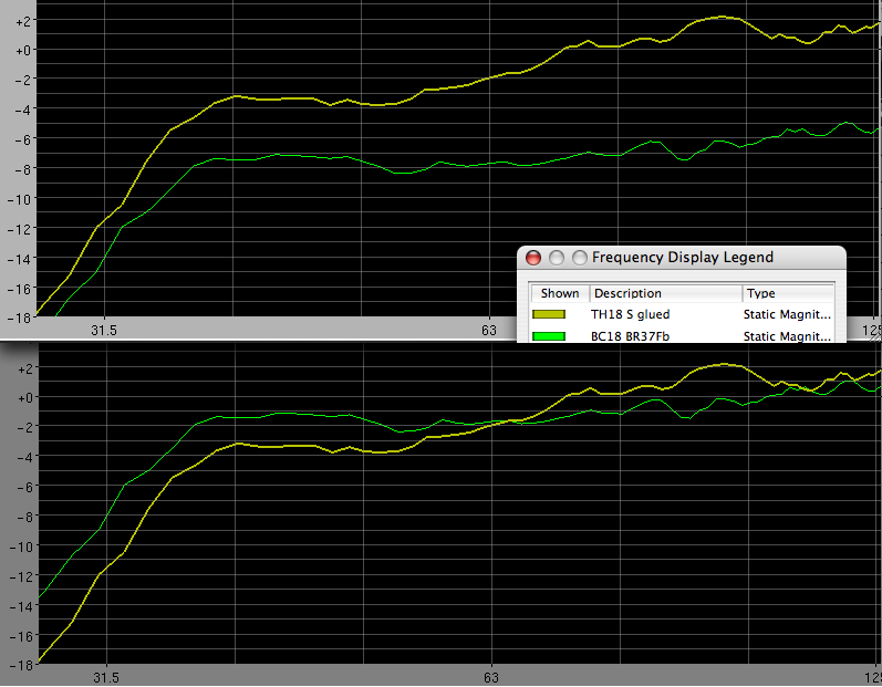

Maximum excursion is about the same for a given voltage for both the TH and the BR, though the TH excursion is far lower for most of it’s range.
In listening tests with both cabinets equalized to have the same frequency response and output, the primary difference was the port noise in the BR when pushed to the amp’s limit.
When the TH was pushed to the amp’s limit, it was basically noise-free, and 6 dB louder than the BR.
The top screen shots shows the Keystone TH and the BR cabinet at the same drive level, the lower screen shows the BR with 6 dB added, the level it would be if two cabinets with double the power were used.
Two of the ported cabinets would use slightly more truck space than the Keystone TH.
Using twice the amp power, it would take two of the BR cabinets to equal the level of the TH above 63 Hz, the BR would put out about 2 dB more below 50 Hz prior to port compression setting in at higher levels.
If the pair of BR cabinet size was reduced to the size of the single TH, their output would probably be almost identical.
The TH, requiring half the speakers and power for the same output, is a clear winner over BR.

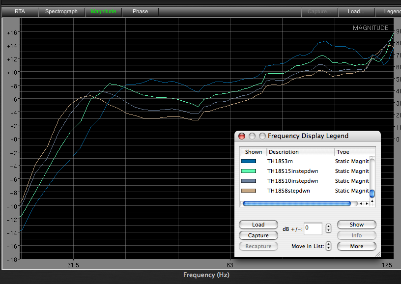

The Keystone TH design also allows for extended LF response (at the expense of reduced upper response) by covering the mouth. The response curves with the exit height reduced to 15, 10, and 8 inches are shown.

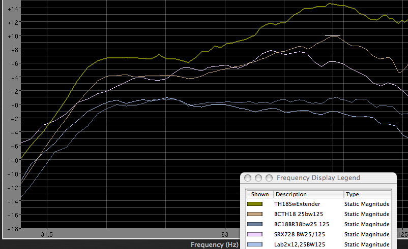

My Lab 2 x 12" cabs have good low end response, but I wanted more upper end to allow a higher crossover point for the 8 inch speakers used above them, after much consideration I made the leap of faith and designed and built some tapped horns.
I have included another chart below, all are at the same drive level, using 25 & 125 BW filters except the TH with extender, which had a 20 and 1K BW filter. The Lab 2x12" is nominally 3 ohms, and exactly half the size of the Keystone TH.
The others are nominally 4 Ohms, the JBL SRX 728 is a bit larger than the TH. The Keystone TH with the extender disassembled for transport would be about the same size as the 728.
The BC BR is the same cabinet in the OP, with the cone put in "normally", which raised the FB by about 1 Hz, and made the response almost perfectly flat.

Hey Art,
Can you describe the "extender" ?? If I read your plot correctly, it looks like it adds ~3dB across the entire spectrum, certainly a worthy addition if one is looking for max SPL.
Also, I would love more LF extension. When you cover some of the port to get more extension, what happens to the excursion in the mid-bass range? could I close the port to say 10 inch height, and then use EQ to raise the mid-bass response, or would that push the excursion too high in the 50 Hz range?
Thanks for the informative posts! Looks like an excellent project!
