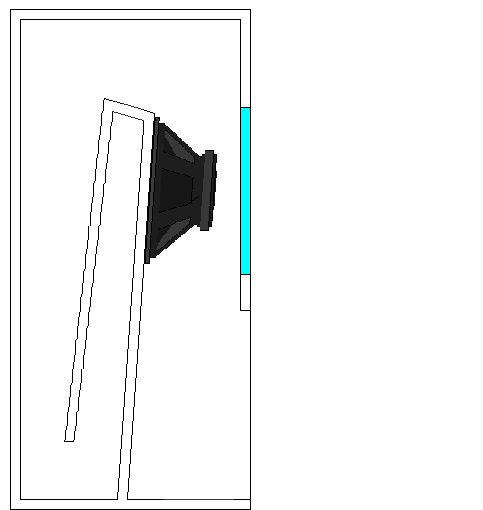

I've attached a quick sketch (it's up to scale but that's it) as how the image struck me, might be way off though.
Thanks for the sketch, the driver placement is correct but I would have the cone facing forward (toward the glass). When I finish modeling, I will draw something and post it. I'm still having a hard time understanding how I can model the folds though - how can I know to what degree the folds will affect the upper corner response if Hornresp does not take them into consideration? Are there any "rules of thumb" I can use?

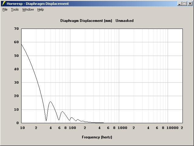

Thanks littlemike, and everyone else for your contributions. An update on my design progress:
It quickly became evident that in order to have any hope of 25hz from a single cabinet, I'd need two drivers in series to split the voltage and thus splitting the excursion. The problem I found is that you lose a whopping 6db of overall performance by running 2 drivers in series, versus 2 in parallel (this is basic theory of course). But the prospect of being able to achieve a theoretical 150db from 2kw input (with drivers in parallel) sounded ohhh so nice! After modeling a few cheap drivers, then coming across the Lab 15 with an Xmax of 10.8, the choice was pretty clear: two of these in parallel, with something like 1.5 to 2kw of input power. It's worth noting that I modeled extensively with the JBL 2226H, which has a very complete spec sheet, but unfortunately it just doesn't get as low as the Lab 15, which is a purpose-built driver for subwoofers.
I'm including shots of hornresp with the parameters, and the response, along with a hornresp import file, and finally a sketch of my design, looking from the side. You will notice the driver filled in with solid black. Sorry in advance for the barely-legible text; the text indicates dimensions in centimeters. The external dimensions are 91.4 deep and 137 tall. The numbers given on the inside are the path lengths of each "fold segment". The drawing is not exactly to scale, as I simply duplicated something I drew up on paper yesterday. But as best I can tell, the fold segments and the segment areas are all proper in accordance with my hornresp parameters. Of course I will lay all of this out with construction paper or something before I do any cutting 🙂
Comments and criticisms are welcome. Also, closely related, has anyone measured the Lab 15 in any kind of horn design? A quick scan of the PSW Sound Reinforcement Forums (notably PSW Sound Reinforcement Forums: LAB Subwoofer => LAB15 basshorn design?) indicates that no one over there has built/measured a design with the Lab 15. I was rather curious to know how it'd do in PSW's "LAB sub box" which was designed for the Lab 12 driver.

tapped horn? or scoop? I don't see the TH designation by the drivers???
And .5pi? you always going to have this in a corner?
and at 130v, that's over 2kw, EACH driver.... you should post your displacement chart.
The design is a tapped horn, however it's going to look a lot like a scoop, in that i'll have a plexiglass window in front of the drivers for the kiddies to look at.
I don't follow..
No; most of the time i'll be running them in 1pi, but I've done all of my modeling in 2pi just in case I should need to take them outdoors.
ahh see, this is why I love you wonderful people 🙂 The 130v figure came from measured output of my Crown CE-2000 in a completely open (unloaded) configuration. As my mentor quickly pointed out, that's nowhere near accurate, both because it's open and because I ran it into clipping while taking the measurement. 88v is probably a more realistic "maximum of maximums" while under an inductive load with a pure sine-wave input.
you should post your displacement chart.[/QUOTE]
See below, with input voltage adjusted to 88v. It's important to note that i'll use a DCX2496 with these, for a slight bit of limiting centered at 35hz, and a major amount between 20 and 30, probably with a band-pass configuration of 20hz - 200hz at 1/30th octave slopes.
