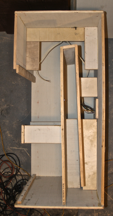

Quick question: Did you adjust angles of the 'dividers', so that the 'turn-arounds' had the same measurements?
It would seem to my way of thinking, that if you kept the angles the same, those 'turn-around' dimensions would be a bit off...hmmm *edit* I could be way off on this, (ADD's a bitch to deal with, especially in my 50's)
Example: The first turn-around has the dimensions of 3.75, 4.42, and 4.375 inches respectively. (On the 'regular' Keystone)
Just wondering before I make any sawdust, also, I've attached the PDF plans. (*edit* they don't seen to be working properly, sorry)
If you didn't, I'm wondering if this is what Mr Steele was getting at with his various (mostly 3rd) revisions.

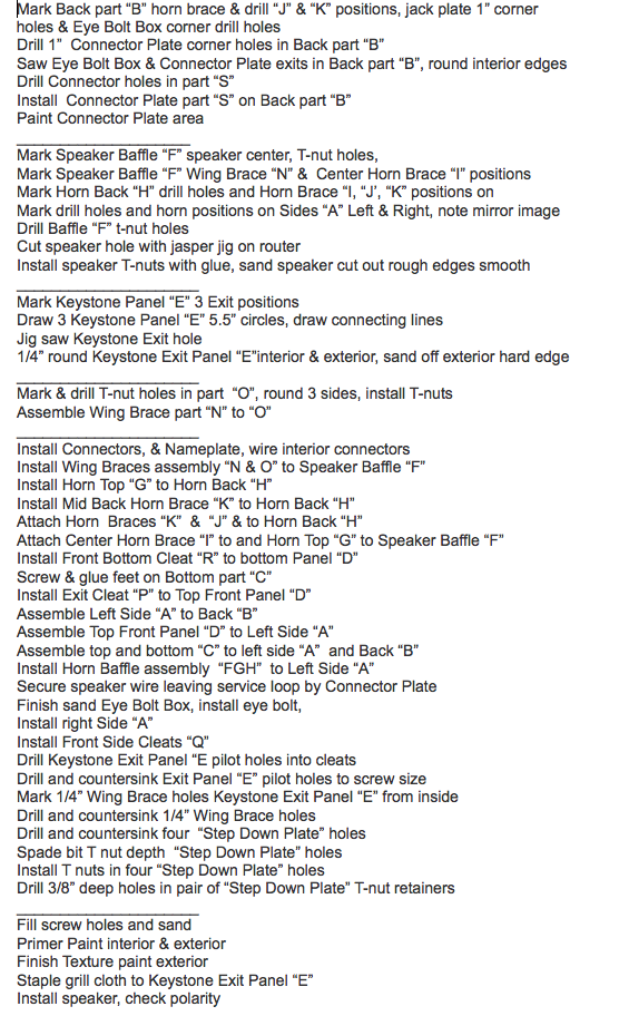

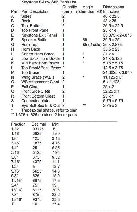

Steve,
1) Since the Dayton PA385S-8 was so similar in frequency response to the BC 18TBW100 in the tall version, it's response would probably also be similar in the standard Keystone.
2) Attached are some measurements, some changes were made to the bracing to facilitate the addition of a pole socket ("Top Hat") and a ratchet strap retainer eye-bolt.
Good luck!

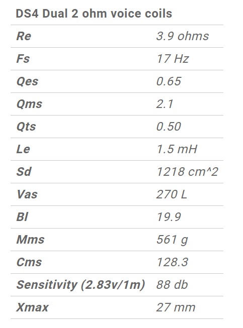

Oh... while on the subject of x-max, just off the top of my head, I have a SI DS-4 that I could use in another Keystone...
TS's attached...
Not a Pro Driver per se'... but do any of you think it could stand the rigors of road use? ...

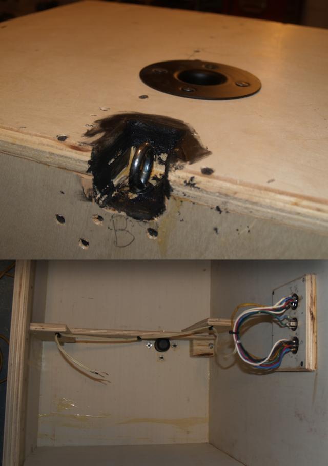

Also, the ratchet strap eye-bolt retainer ..is that to assist the top-hat pole stability-wise, or... ?

2)Also, the ratchet strap eye-bolt retainer ..is that to assist the top-hat pole stability-wise, or... ?
1) The various "step down" sizes probably refer to the reduction of the Keystone exit vertically, but without the thread post #, hard to know exactly what you are referencing.
2) The ratchet strap eye-bolt retainer is used to triangulate the top cabinet while using a long pole mounted in the sub's top-hat, while also providing something to hang on to when tipping the cabinet back on a two-wheel dolly.
Whoops, posts overlapping here. Yea, I sorta figured that out about the eye fastener.
