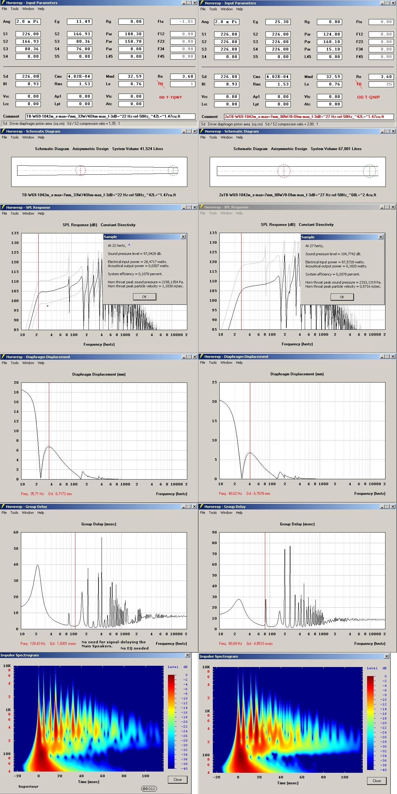

I built a tapped horn using this driver a few years back but have misplaced the hornresp file due to upgrades on my computer. I have modeled this again as I remember the line being 8-9' but I can't get a good sim with this driver without running out of xmax at low power. I seem to also remember my tuning being about 30hz and was clean until 100hz, output was fair in the110-115dB if I recall correctly. Now my issue is I like I said earlier is I can't get this driver to model well in a tapped horn and I can't for the life of me figure out why.
If I could get a little help on a modeling without issues I would be greatful, it's driving me mad. Thanks in advance.

Hmm, then again, it can be 'grown' from ~109 to 188 L and will sim these numbers in 2 pi.

Hmm, your specs are considerably different than what I found on the net, so curious where you found them plus need to use the same peak SPL plots for comparison purposes.

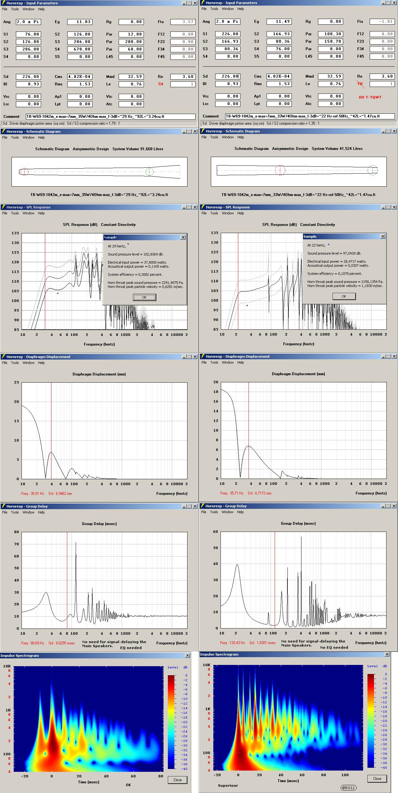

I've been curious about a dual driver T-TQWT using this driver. It may proved the extra output wanted given the limited Xmax of the driver.

Thanks for the help folks. Bjorno, my sim for the tapped horn was almost identical to yours, and when max SPL is looked at it is still xmax limited in the 40-60Hz range. Is this just me overlooking something or is there really something I should be overlooking?

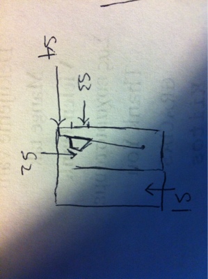

The OD T-TQWT looks interesting but I'm kind of perplexed as to where the driver would mount in regards to the mouth. I also like that there will be no delay required from the DCX2496 in regards to the OD T-TQWT. Would this be the same sort of external mount of the driver as a TQWT or would this be mounted internally like a TH?
I'd like to keep it smaller if at all possible and the 1.5 cubic/ft is much smaller than the TH at nearly 3.25cubes.

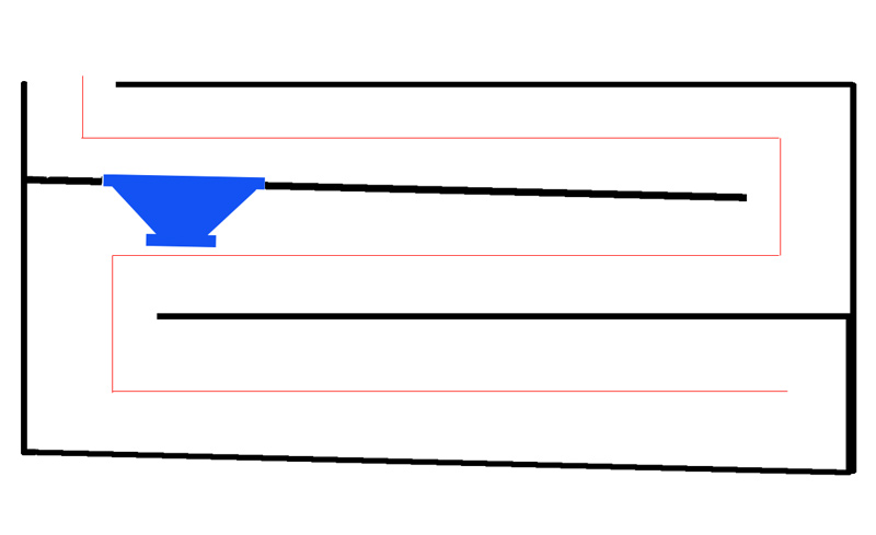

How would I go about folding the OD T-TQWT that bjorno posted? I assume similar to a TH but I just want to be sure.
No one? I would like to try this OD T TQWT but am confused regarding the fold and the pipe end opening(mouth). Any help would be appreciated.
Here's a very rough drawing . Extend the sections as needed
Thanks Zobsky, clears things up a bit.
