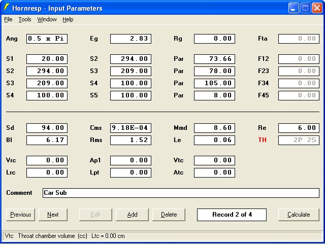

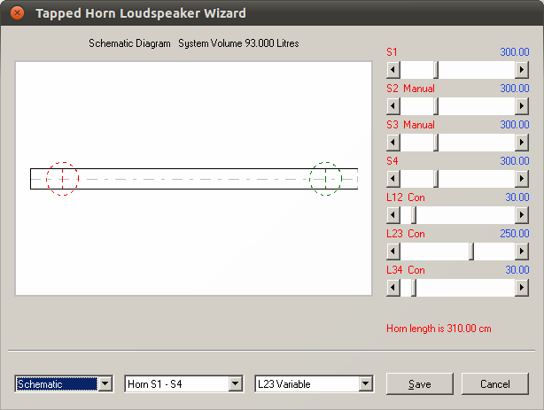

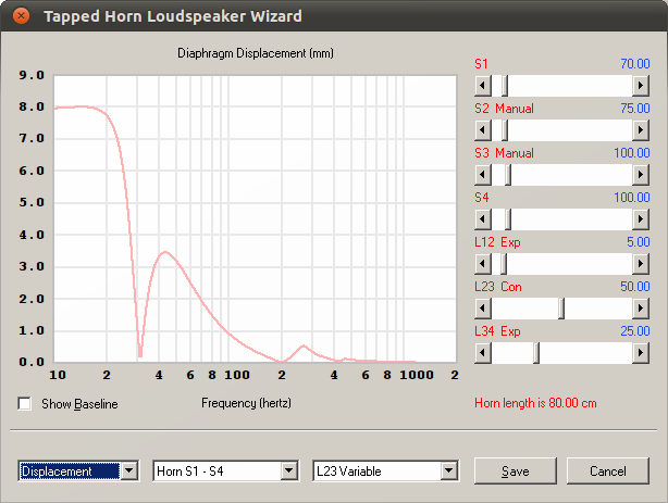

-The first attachment is the hornresp input parameters. It is approx a 50 liter box with 4 of the daytons. I would use two boxes in the trunk.

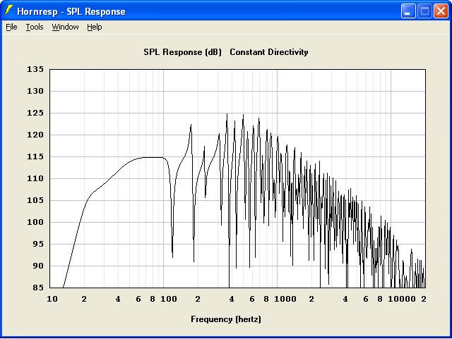

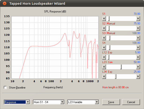

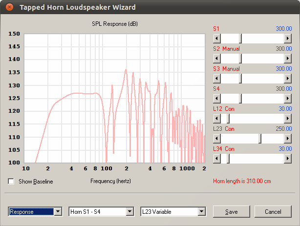

-The second is spl at 2.83 volts (one watt) in .5 pi space (which I heard is appropriate for cars) for one box. I'm hoping the roll off should be shallow enough that cabin gain should extend response flat to 20 Hz.

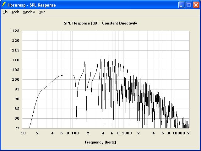

-The third is spl at 12 volts (around 40 watts) which is pretty much where the drivers will run out of excursion, and maybe overall 6db louder with the second box.

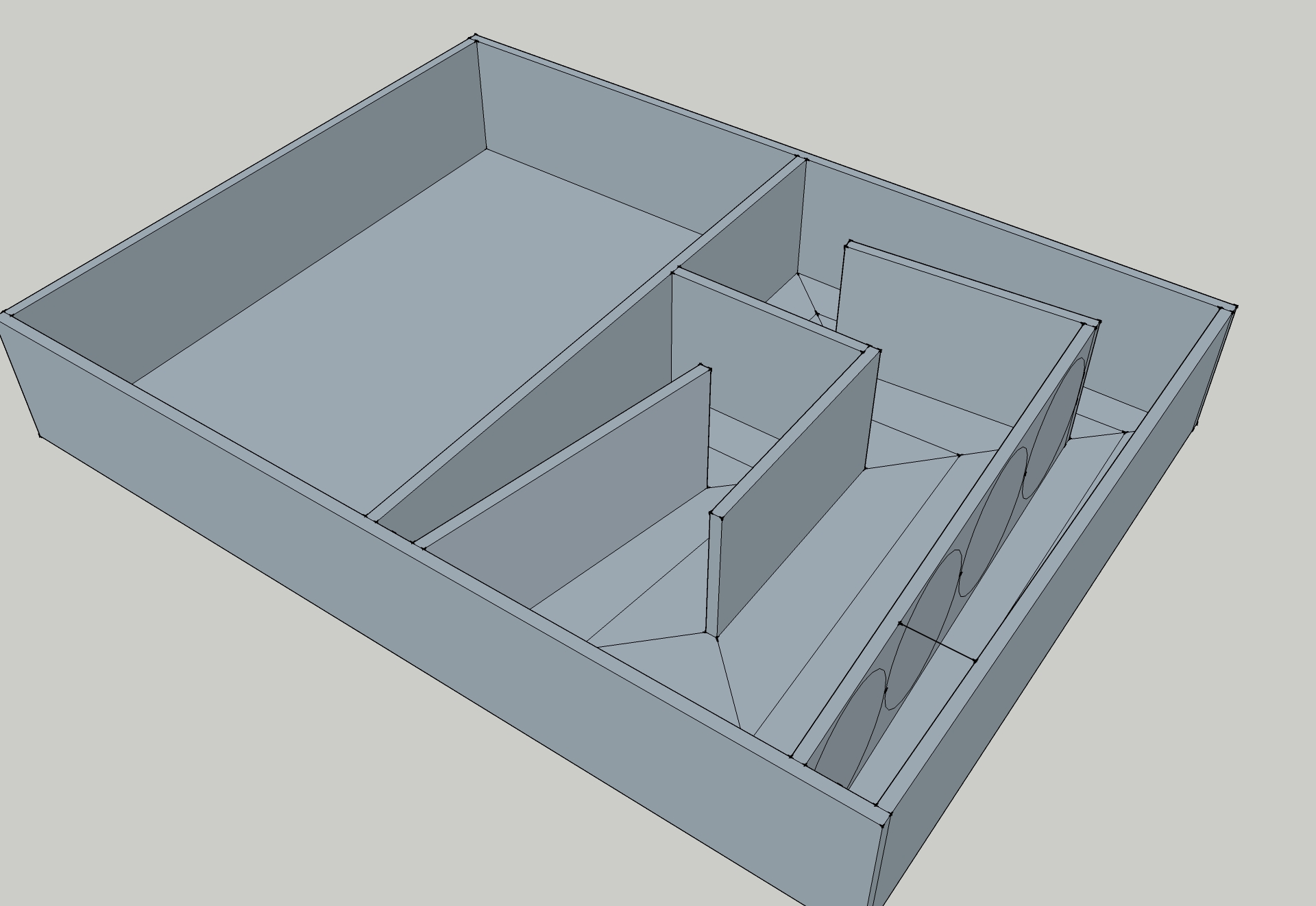

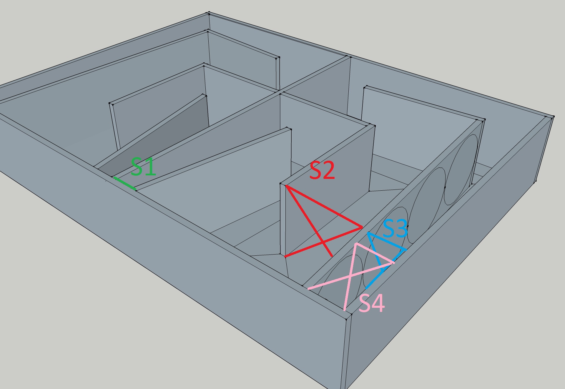

-Fourth is a sketchup of the folding. The end of the path in the bottom corner is where the opening will be, ending up in the corner of the trunk. The empty side will be a mirror of the close side. The circles represent the drivers. Also the driver closest to the end of the path is the location in the hornresp model. I also modeled the other three (as they move down the line) and think the combination should actually flatten and extend the passband.
Now I don't know if I should believe these little drivers can really reach 120 db at 60 Hz (thinking the cones can't handle the pressure) but if they get anywhere close, I'll be happy.
Thoughts?

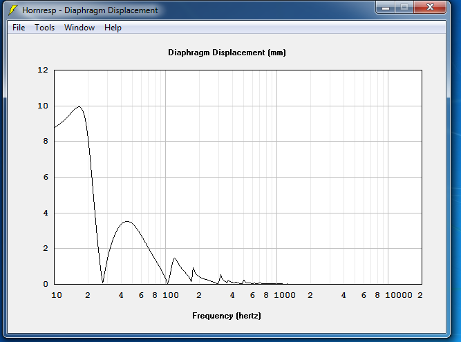

HI there r: Please post your Xmax curve from HR, the T/S parameters calculated by HR (requires a double click on Sd), the HR sketch of the path layout and show the exit port in the sketch, these will the diy community evaluate your design. The path does not seem to follow the input screen with reghard to a continuous path (you seem to have added a resonator attached to the final section where you stated the exit port will be located). regards, Michael

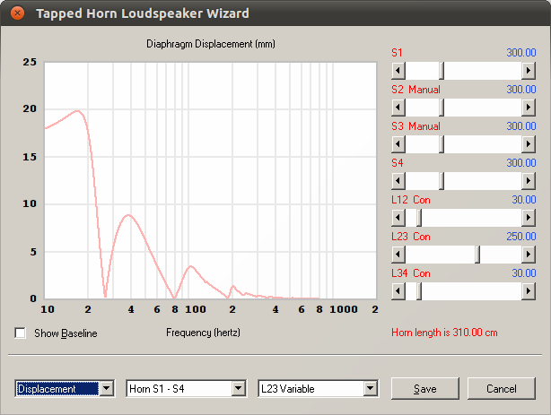

xmax curve at 12 volts, where driver reaches 3.3mm xmax at 45 Hz

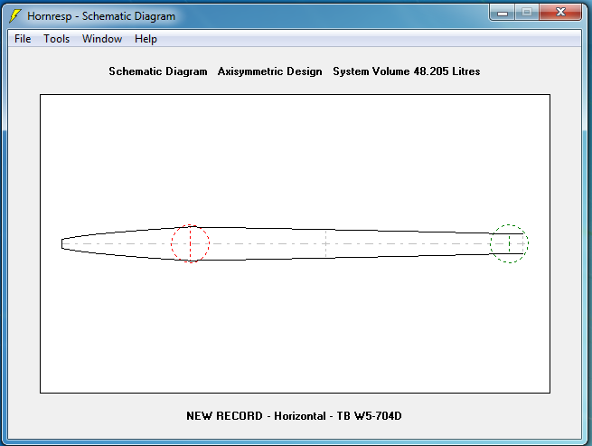

The Hornresp schematic:
Updated image of the box with S1, S2, S3, and S4 marked (with MS Paint 🙂) I think you were looking at the horn path backwards.

Nice workup, but the locations for S1-S5 are defined in Hornresp, and cannot be arbitrarily assigned otherwise. Also, if you add a second section between the driver(s) and the output opening (driver @ S3 - output @ S5) you need to click on the red TH, and change it into TH1; otherwise, in a 4-section TH the driver is located between S3 and S4.
Sorry I mislabeled my diagram. S1 and S2 are correct (with the modeled driver at S2), what is labeled as S4 should be S5 (the exit), and S3 should be S4 (the tap on the backside of the driver) and S3 should be at the 180 degree bend in the middle.
JBell, your idea is interesting. I modeled it up in hornresp, as it is basically a band pass horn, and there is some potential there. Maybe if this doesn't work I'll try that next...

The large area between S1 and S2 is primarily just acting as a chamber.

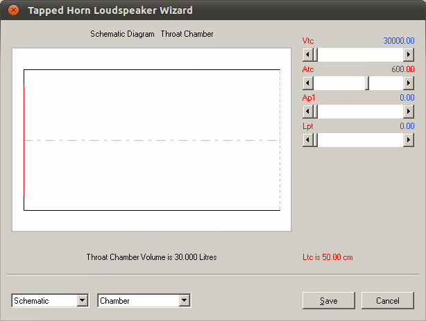

The line length doesn't look right for the response chart. are you sure you have all the number right?
What are the outside dimensions of this box?

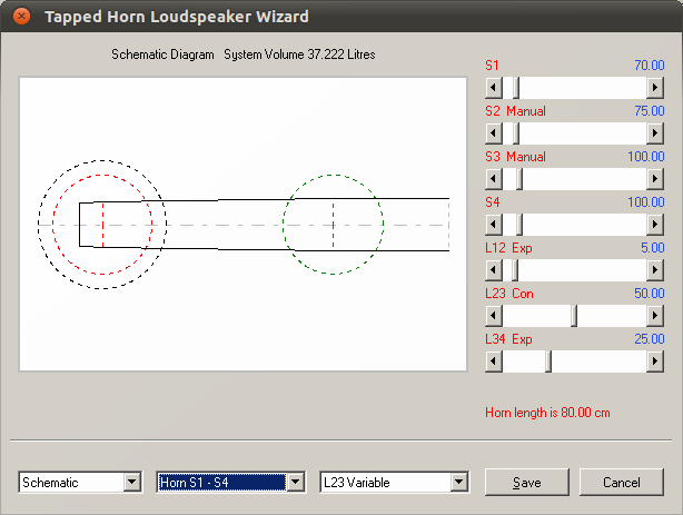

Looking at your box, and making some guesstimates, I see the following: (simulated at ~11V and 0.5pi space, or ~15W input for 4 drivers), extrapolated, this would be about 117dB capable with both box halves and all 8 drivers figured in down to ~30hz. I think this may be a bit optimistic, as I look back on it I suspect I have overestimated the box size a bit... the actual low frequency limit may be closer to ~35hz

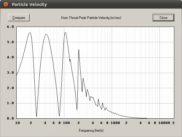

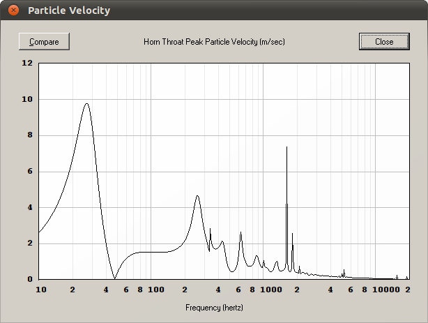

The problem I see with the design, is that it wastes a ton of displacement. Most of the driver displacement in the design you are proposing, is being fluttered away as more efficiency than is needed. If you want to use all 8 drivers, it would be better to reduce the sophistication level of the box design and use more electrical power. As it stands currently, the box design, IMO, is a waste of potential.
On a very general note; an "ideal" to "strive" for in box design, is such that both the thermal [Pe] and displacement [Xmax] capabilities of a driver are being utilised near their maximum. Your design is extraordinarily lopsided, leaving a ton of Pe on the table- - reaching xmax well before there is any electrical or thermal issue in a reasonable car sub application. Given the same box space, you can easily achieve the same or better output with less drivers. Or more output with some variation of box or driver combination 🙂
