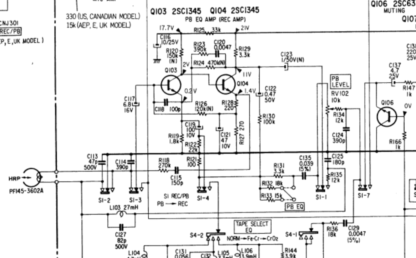

I would like information on how I could amplify the low level signal from a tape playback head. I realize that I could take an existing player apart however the amount of mechanical parts used to operate the player would probably over complicate things for my purpose. Is a preamp necessary or could one go directly to an amplifier? I do not need audiophile quality. What are the various leads off the back of the head for. Some have two and others have four.

OK... tape heads. Most cassette decks use a combined record and play head. Two wires for mono, four for a stereo head. Top end machines use separate record play heads siamesed onto the same block so could have eight wires. Erase heads normally have just two wires (unless its a specialised head that allows individual tracks to be erased)

An opamp is all you need to amplify the head output (you do need a preamp). It should also have the correct response (a bit like RIAA for phono preamps).

If all you want is to get some kind of audio then you could try using a MC phono stage if you have one. Have a look at some old cassette deck manuals such as a Sony TCK5. That just uses a two or three transistor (from memory) simple single rail preamp.

One of the main difference between a record and a playback head is the size of the actual head gap (between the pole pieces). Playback heads have a small gap for good hf response, the record head tends to have a larger gap. Single heads are a compromise.

Here is a simple transistor preamp, single rail. It would probably work OK from 15 to 20 volts or so with no changes. The switches are all in the playback position so the head connects from ground to C117 with a 390pf across the head (value to suit head ideally... experiment).

Let's hold on here a minute. Playback heads are "higher Impedance", anywhere from below 100 millihenrys (mH) for transistors to over 600mH to better match the "older" tube circuits. They "look like" a moving magnet cartridge and need in the neighborhood of 50dB voltage gain to get their output up to an "acceptable level" to feed a line stage. Record heads typically have MUCH lower impedances (maybe 10mh) and can't be used for playback (OK-never say never - but now you need 60dB or greater and here comes a hum proboem). There is also the fact that, like phono, there was an "accepted" pre-emphasis/de-emphasis curve used (NAB/IEC) so you do have to "tailor" the response of a preamplifier to accommodate this.

Ok let's make this super simple as I am a simple fella. Could I take one of the tape heads in the ebay link above, mono not stereo, and run it through the phono stage of my tuner so that when passed over a length of magnetic tape of appropriate width, it will reproduce the recorded sound to a acceptable level of fidelity? I don't mean to be unappreciative of the other aspects of your feedback, I simply don't know if it will matter for my purposes. Charles, hum is certainly something I want to avoid however.

Those mono heads are simple cassette one gap record / play heads.
Impedance is about 500 ohms. What are your purposes ?

Yes, as long as you have sufficient gain (moving coil input if you have it, if not try what you have ?). Remember that the output from the head will vary in amplitude depending on how fast you move it over the tape. You will probably have to snap the metal tape guides off the head too.
