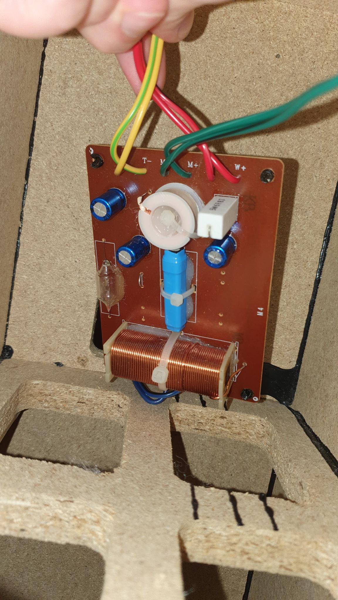

In my 5.0 set I have a two great tannoy speakers the only problem with them are non working tweeters. So I’ve opened the speakers to see if the tweeters are blown. The first thing which I’ve notice is the hair wires disconnected/cut. So I’ve checked the ohms with multimeter but due to a really thin wires is really hard to measure it, but when I did it, I’ve hears the noise coming from speaker so I believe they are not blow? Is it possible to solder those thin wires with connectors?

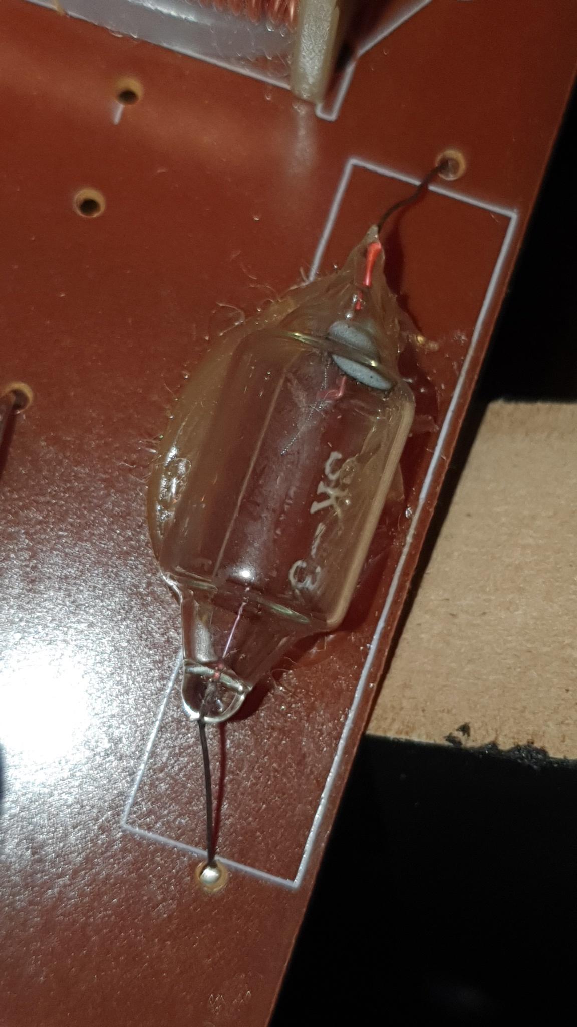

Another problem which I’ve notice is blow lamp fuse sk-3. I wonder with what currently available lamp fuse I can replace it? And will replacing this fuse fix the problem or it might be an another issue which caused fuses to blow?

It's not clear to me from your image where the thin tweeter wires are broken.
The fact that the crossover fuse bulbs in both speakers have blown smacks of severe overload
If one had remained intact, then measuring its resistance would have helped source a suitable replacment.

You can try soldering wires with lots of patience, adding a short piece of wire ( like 1 strand or filament from any common power cord) and solder to the spk wire using a small iron, say, 20W.
Respect to lamp fuse may be blown by a short overload of large magnitude, as when powering on/off the amp. Sincerely I don't know a good recomendation for substitute it, because it depends on availability and power and impedance of the spks on question.
You can temporarily bypass the fuse bulb by soldering a short length of copper wire across it.
If your tweeters are OK, this should restore them to operation.

Just google SK-3 bulb. They are common. Look different but same thing.
Ah! SK-3! 😎
As from this UK supplier: Convair Safety Relay Crossover Fuse Bulb SK3 from Convair Electronics PS2.05 IN STOCK (31 Oct 2021)
Basically they are disconnected on solder point where you plug the normal connectors. It’s really small elementary so sorry if the photos not so clear

That should be correctable by soldering in the way Osvaldo described earlier.Basically they are disconnected on solder point where you plug the normal connectors.

But these speaker wires are hair thin. Should I use any specific solder wire? Also, I dont have solder iron and no experience. Do you recommend any irons for amateurs which will be suitable for this case?
Something basic like this will do the job: Duratool SD01672 40 W Soldering Iron Kit - Black : Amazon.co.uk: DIY & Tools
Make sure you apply heat to the tweeter wire for the minimum time possible.

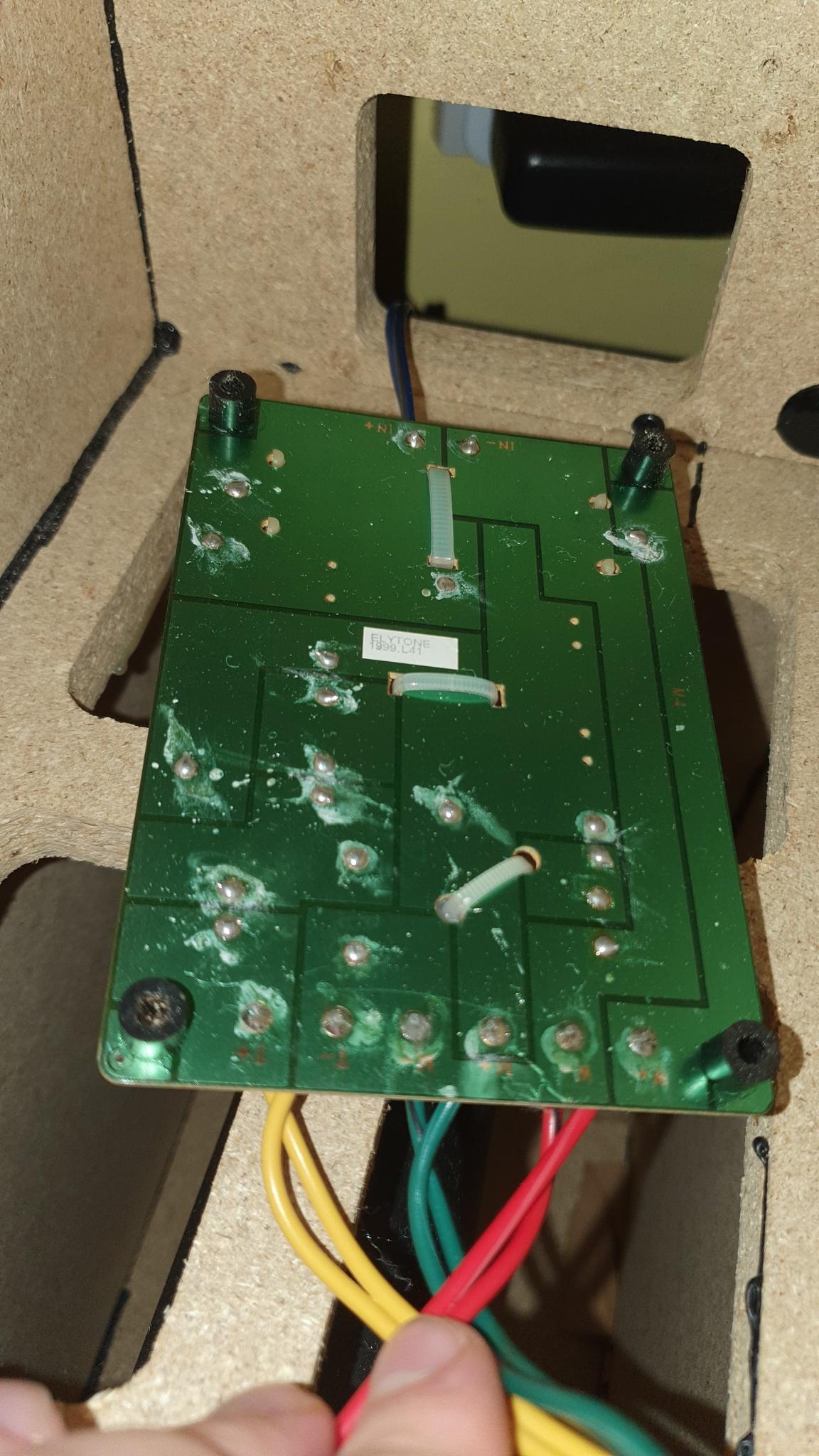

Next we may have to look at the crossover board. If you could supply a clear photo showing the components on the board, that would be most helpful.
