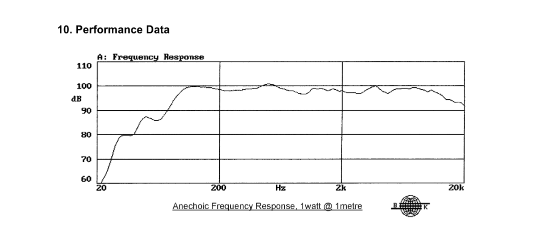

I have been offered the chance to buy a pair of these drivers but I know nothing about Tannoy. Would they be good for Hifi?
If you like it very loud with limited bass for the cabinet size,
or have a flea powered amplifier they might appeal for hifi.
However its a professional speaker designed to go very
loud and needing subwoofers to plumb the depths.
rgds, sreten.

What sreten said...
They are very nice drivers.
They have them in a FNAC store close to me, with Tannoy subs for your knowledge.
The Frequency Response is 60Hz - 22kHz (+/- 3dB)
Tannoy i15 Manual
You can listen to a CD or a band, it doesn't matter. They are the best.
They are all corrected/equalized/compressed for the bands and for the space (coffee shop) each time different and they always sound good when the sound engineer is also good.
