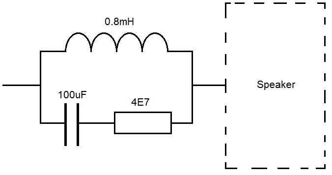

I scanned through that link, got to this bit
I wonder if one could do something like the attached to "improve" bass by dialing down treble?

Yes, but that's on the high part of the X-over (so doesn't "increase" bass alone). The purpose of the filter I attached above is to decrease the low midrange as well as the treble.
However, I've never done anything like this passively, and I'm not any expert.
I mean a FR like this:
Fair enough, I didn't calculate where your suggestion does anything 🙁
Still think the likely culprit for low low bass levels is either placement or hardening surrounds.
