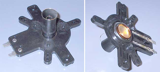

Re: Tannoy GRF
But what is a compression driver, but a dome tweeter mounted in a compression chamber? True the big ones i usually see are concave, not convex. Below is the dead butterfly from the baby Tannoys i have.
dave
Originally posted by Sylver300B Tannoy did hide the fact that almost all their recent drivers no longer use compression horn tweeter, but rather, a less expensive metal dome tweeter, mounted in that horn.. .whew.. too bad.
