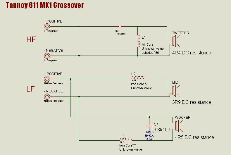

These speakers (dual concentric 3 way) seem to have a pronounced response around the crossover point at ~ 2.5kHz which I would like to address somehow. I have added extra damping material to the inside of the cabinet which has helped greatly with the upper mid range "hash" but I now need to sort out the tweeters filter.
So....my next move, I think, is to raise the tweeters crossover point slightly to equalise this peak and reduce this irritating sibilance. The user manual states that the crossover is entirely first order at 400Hz and 2.5kHz. Is this the right approach? Am I missing something here?
In the Tweeter's filter what is the function of the inductor?
I have (hopefully) posted a crossover schematic which I have labelled with the information that I have so far. I don't have any values for the inductors and only the measured DC resistance for he individual drivers.
Could I just change the 3u3 cap for a 2u2 or would this be a drastic change?
Overall the speakers are rated at 6 Ohms.
Any help would be very much appreciated. 🙂

Does anyone know what the inductor L1 is for?

The manual says "First order low pass, First order high pass". I suppose that this is innacurate.:smash:
I'm still unsure wether or not to raise the high pass frequency, convert to a 1st order or add a notch filter??

I'm having great difficulty with the online crossover simulators because I don't know the values of the inductor L1 ("66" is handwritten on it.) and also the true impedance of the HF driver (4.4 Ohms D.C. resistance).
I'm not sure how to fill in the gaps? :smash:
If you're sure it's the tweeter, a zobel on the mid won't help.
Using the calculator 'backwards' I get a value of 1.33mH for the inductor. (and a Z of around 10-11.5ohms).
Simplest thing to do is what you initially suggested, use a smaller cap, and see what happens (2u2 will get you up around 3KHz). Ideally you would need a change in inductor too, but only a small change downwards is indicated by the calculator.

I had assumed what you label as the mid was the 0.5 way
bass and what you label as bass, is in fact the bass mid unit.
In this case the c/o is 2nd order electrical, though its possible
c/o slopes approximate 1st order acoustic is the c/o region.
I think your diagram is possibly wrong, but could be right,
overdamped 2nd order on the 0.5 way unit, 1st order on
the bass/mid unit, 2nd order on the tweeter.
Still it appears not to be a true 3-way.
Adding Zobels is NOT the way to go, c/o values would then
be completely wrong, including phase at the c/o point.
Reducing the tweeters capacitor is worth trying.
🙂/sreten.

I'm pretty sure that my diagram is correct. I checked it many times because it did not seem to make any sense.
I had always assumed that these speakers were 3 ways with first order filters so you can understand the confusion I felt when I first saw the crossover.

Sonusthree , email a copy of your cross-over schematic diagram to Tannoy and ask them to tell you whether that inductor is there to compensate for a rise in the output of the horn loaded tweeter at the low end of its bandwidth , as such is possible with horn loaded tweeters .
Alternately , it may be there to reduce the effect of the electrical interaction between the series capacitor's reactance and the high Q impedance spike at the tweeters Fs - that is to cause a parallel low impedance across the Fs caused impedance spike .
For either above case the value of the inductor would have been chosen to reduce output at the low end only sufficiently to allow the series capacitor to cause a first order roll-off , however , do ask Tannoy , they should happily tell you , and particually as it is an old model speaker and likely no longer of commercial concern for them .

When you are able , measure the response of both the inner horn and outer cone separately to each other - with the X-over bypassed completely . The 2k5 region is one where break-up often occurrs in that diameter size plastic-cone driver type , and is also a region where prominence can occurr in small horns . Which-ever , or what degree in both , driver/s it is in needs to be discovered before you can usefully decide how to mod. the X-over .
2u2 series cap. to tweeter will give different sound , but not neccessarily more accurate , though you seem to have realized this .
