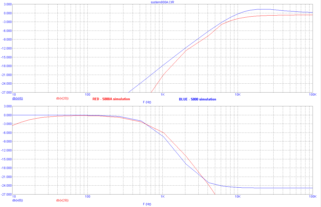

No, they do (output on axis falls towards high frequencies as expected).
Attached is a crossover simulation from a System 800 (passive) and System 800A (active)
made by our member dimitri. The voltage to the HF part is about -16 dB at the crossover point for a flat response.

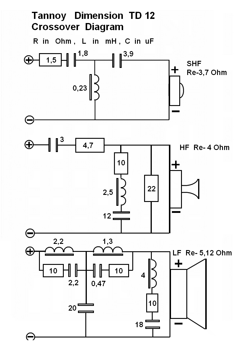

The System 600 and 800 do not use a notch filter for HF but the 12inch System 1200
seems to have one (if this schematic is correct):
tannoy
The Dimension TD12 (paper cone, tulip waveguide) has a notch filter too (schematic attached).
It appears that the larger drivers (with lower crossover frequencies) still
employ a notch filter.
