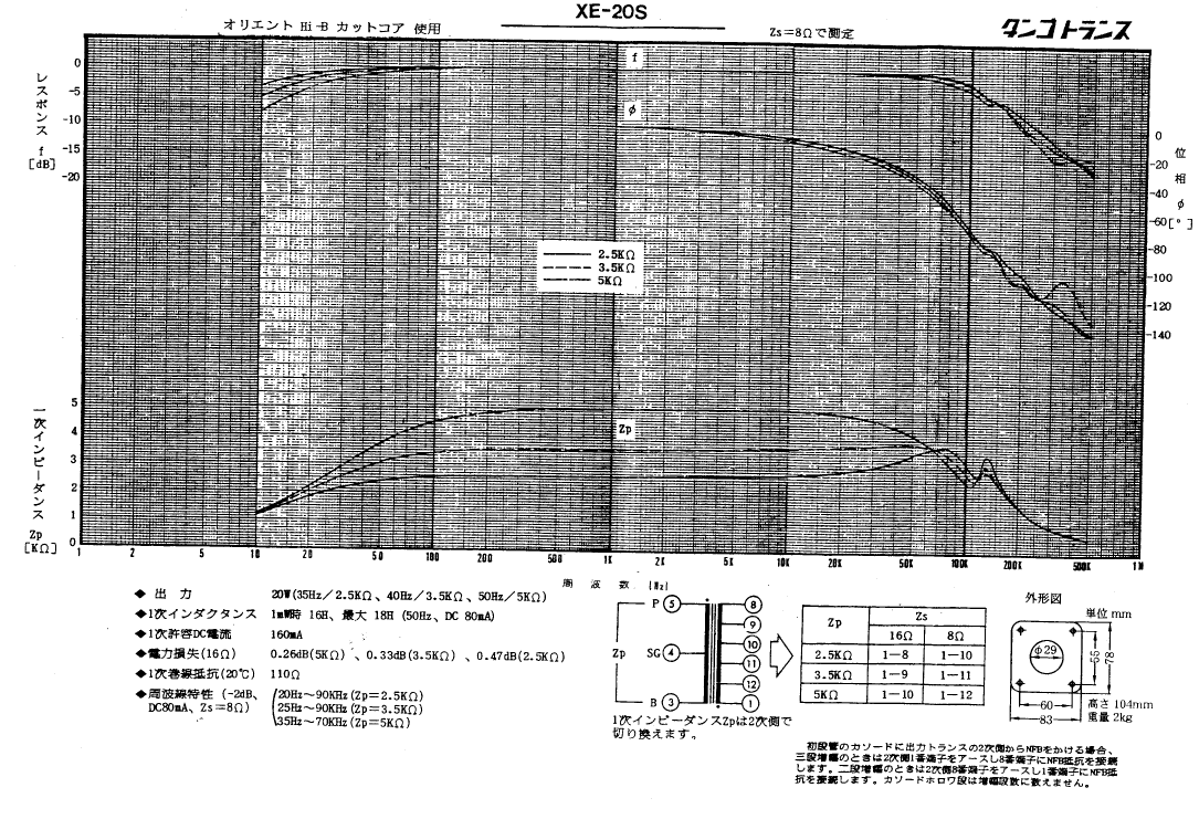

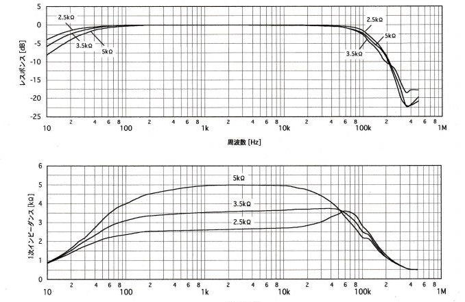

The performance is not the same, slightly different. looking at the data sheet for FC-20S vs XE-20S clearly the FC-20S has improved high freq response (no resonance at all) However I saw posts saying that the XE-20S can be used with 800V applications and tested to 1000V but no concrete data. While I did hear back from the manufacturer that that new FC-20S is safe to 600V
ISO-TANGO - XE-20S - http://www.tubebooks.org/transformer_data.htm scroll to TANGO
CURRENT ISO-TANGO https://isotransformers.tokyo/single-ended-output-trans/

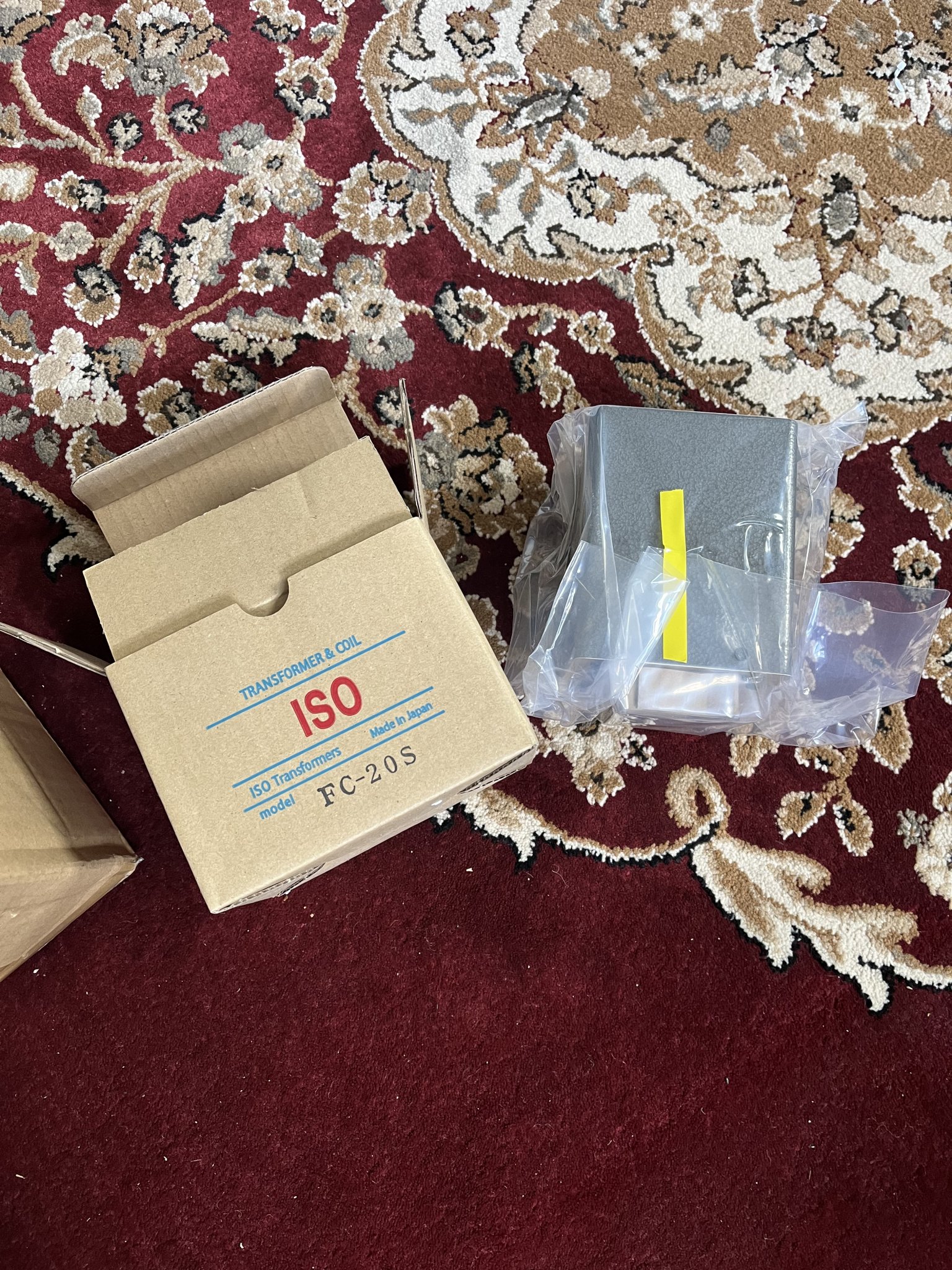

I placed an order for the FC-20S. Will post an update once I receive them.

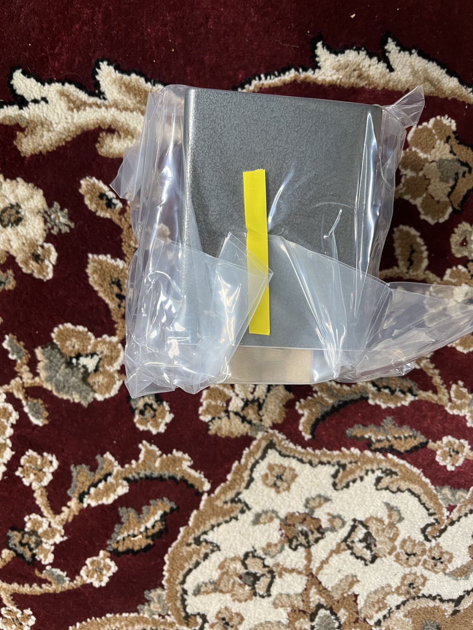

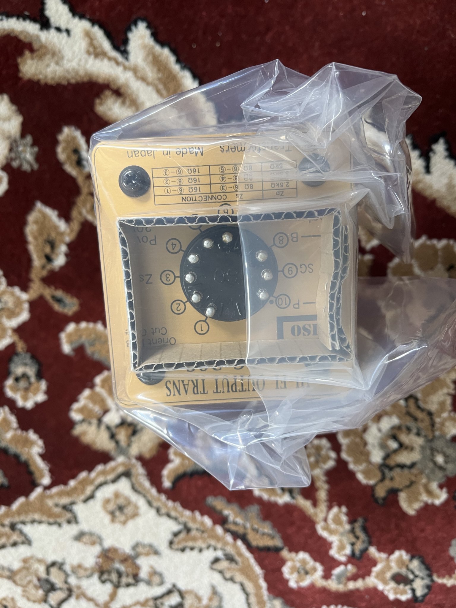

Just reporting I got the FC-20S. Looks very good and delivery took 5 days from Japan to US. Nicely packaged. Very good customer service and Osawa-San is very helpful with specs and details.
