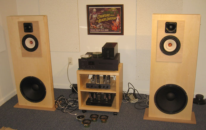

>>> The 1808 is better for an OB, but why waste an 8"er on an OB?
Every driver on those baffles can be considered wasteful. Along with that tube amp, tube cd player and all that excess wire. But it's fun! Simon & Garfunkel have been playing in my listening room for days as i sketch on my new drafting table into the night.
The B20 in the lower right corner also sounds good on OB... but not as good as the TB. Every 8" driver I've simmed, regardless of specs, seems to make it to 200hz on OB (Fostex, TB, Dayton, Eminence, B20, etc...) with a natural roll off that matches up nicely with an H-frame or OB woofer like the Alpha 15s in the pic. 8" drivers with high Qts (1 or higher) sim out to around 100hz and drop quickly after that. The TB 1808s do 'tone' right but are not perfect. They are lively and punchy sounding with detail galore without sounding strident or harsh to me. I can live with them happily in many different types of cabinets... even all by themselves. The 1772s must be good but for me were less flexible in terms of what i was capable of making for them. Bob is right that the 1808 requires a much larger br box (or BIB for that matter) than the 1772. If you are not opposed to adding a circuit to flatten their curve the 1772 is a better choice if you want a smaller cabinet. Having said that the 1808 sounds really nice in a small sealed cab without any circuit... at the expense of low bass. Add a sub and you will be very happy imo.
It might be a while before i get back to 'box' speakers... but i'm certain i will eventually.

My point is that while a given 8" driver may well sound very nice on an OB, the low frequency roll-off is a function of the baffle size, not a function of the driver size. ANY sized driver will roll off at exactly the same frequency (assuming that the driver will reach that frequency). As good as the 1772/1808 may be, a 3-4in driver is going to have a better top end. Use an 8" driver in a cabinet that will allow it to get some bass.
