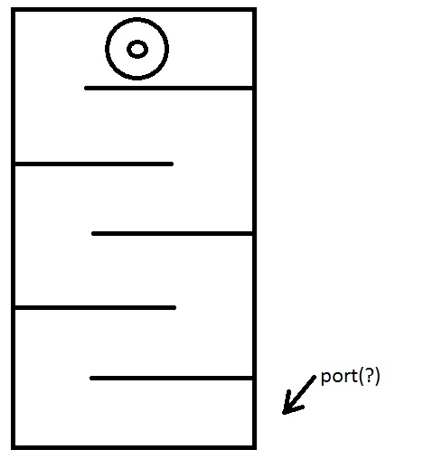

Sorry for bumping, but I have searched on driver placements in Transmission Lines without really finding a answer for this - can the driver be mounted on the side on a folded TL like illustrated?

AggroMagnet,
I have no idea on TL design. Have you looked up the TABAQ TL? It's for 3" drivers, but 4" TB drivers have also been used IIRC.

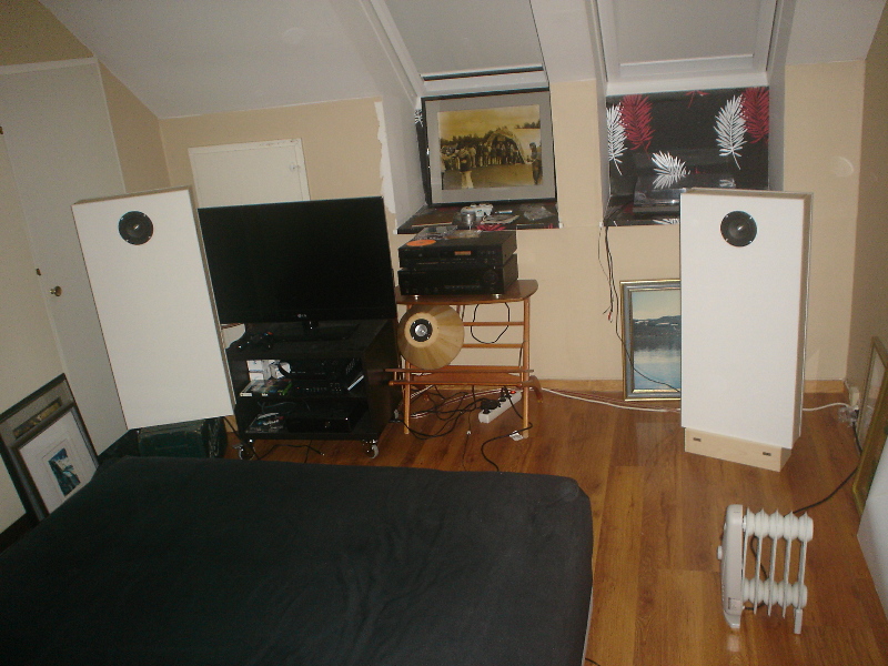

So I stopped by Ikea and picked up some kitchen closet doors.
Still in the test phase, but it seems to work just great. Deep and dry bass.
Ports are placed on the end of the underside (2x8cm opening on the port, might be a bit on the small side, but barely any air seem to come though it anyways..)

Your wide boxes look nice. What does the inside look like? Is it a TL or BR? If you like flat wide baffles look at the flat BIB or FIB - details in the Foam Core thread.
It is split in the middle under the driver and down, ported on one side facing down. So a kind of a folded TL I guess.
I have considered BIB in the past, but haven't seen those FIB-horns - man those looks interesting..

Your design reminds me of what I did with a TC9FD driver for a wall mount MLTL.

Haha familiar indeed!
I split mine down the middle, but your L-turn is a much better solution to keep the driver in the "1/3" spot in the transmission line. I simply didn't think of using that shape.
Mine are tuned to 45Hz with 27 liter internal volume.
Shelf port is rather large, so at least technically my driver doesn't sit in the middle of the TL..
