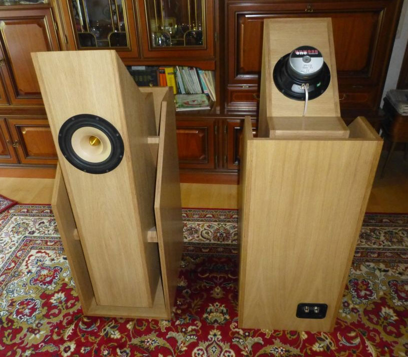

I have AN 10 in the 2.8 cabinets and my one friend and cousin all have them also from 6.5 in. to 15in. in various cabinets , they are not the last word in sound quality . don't know much about the TB series of driver. When we got into this single drive speaker part of stereo we all noticed a vast improvement to the sound over multi driver systems. the 6.5 inch AN sounded real good in my solid wood Abbys Cain&Cain I built years ago which unfortunately were lost in a fire. What makes the audio nirvanas attractive is that you can drive them to high volume with 2 watts!!!!
Good! So the maker graph is not too far from reality (not too smoothed like most), being really flatter/not too peaky like most fullrangersHere's how the 1772 looks mounted on a small OB, no EQ:
The rising response will not be a problem in my system (to be fair, will be an advantage)🙂
😎😀 yes, these sing with low power! A must for small amplifiers 🙂I have AN 10 in the 2.8 cabinets and my one friend and cousin all have them also from 6.5 in. to 15in. in various cabinets , they are not the last word in sound quality . don't know much about the TB series of driver. When we got into this single drive speaker part of stereo we all noticed a vast improvement to the sound over multi driver systems. the 6.5 inch AN sounded real good in my solid wood Abbys Cain&Cain I built years ago which unfortunately were lost in a fire. What makes the audio nirvanas attractive is that you can drive them to high volume with 2 watts!!!!
My cousin have a 6.5 Cast Frame with a PLC85 PP amplifier (supplemented with a subwoofer), and are pleased with it.
One friend of mine have a AN10 but with a trapezoidal shaped box (with approx. 2.8 model internal volume). Sounds good! This AN10 I used some time ago with a giant OB, with far more bass one expects from OB or even full-ranges (recently I selled these AN to my friend, to experiment with new designs). Fun times!
Other friend of mine is making a TQWT for a AN8 Cast Frame. Let's see the results!

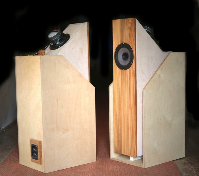

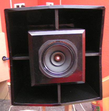

I've gone towards the planet 10 frugalhorn builds in the process of building the frugalhorn XL's, with Mark Audio drivers. I'm in a fairly small room 9x13 so am limited , as my cousin has the super 15's in a giant room with the 5.6 cabinets.....
I cannot speak directly about the 1772, but I have lived with the W8 1808 for a while now. I bought them on impulse in excellent used condition from a Craigslist ad for only about $150.
I've had them mounted in a pair of Oris 200 horns that were pieced together affordably by myself. I found them in our swap meet. They somehow circulated sans rear chambers as a result of Welbourne Labs liquidating it seems. The finish was ruined on them, so I had to sand them down to remove the copper plating. They are still in an experimental "raw" finish state. I made new rear chambers from sewer pipe, window gasket foam and MDF.
The horns were originally intended for a pair of NOS Fostex 206e I have. I also hoped to experiment with other high efficiency 8 inch drivers to compare the results. That is what interested me in this thread.
The efficiency is really where the TB 1808 initially seem to let me down. It's only rated at about 93dB. My goal was to be able to use a pair of Quicksilver Horn Monos in conjunction with my old Audible Illusions 2D to drive them in the horns. I installed the 1808s with open rear chambers, which I'm sure does not help low frequency response. I couldn't come up with any data that informed me how to calculate a proper volume rear chamber of any kind. My research, if I recall correctly, seemed to point toward success with the 1808 in either very large volume MLTL style enclosures or open baffle. Hence, my decision to leave the back chamber open.
They seemed dead with this arrangement. I eventually gave Quicksilver a call to talk it over with them. It seemed that the push pull horn monos really don't begin to "sing" until you approach the 100dB efficiency range. Regardless of what reviewers tried with them and said. They were originally designed and built for Klipschorns and the like.
On a whim I decided to put together an Audiosector LM3875 premium kit I had to try with the combination. The difference was night and day. I got beautiful holographic imaging with great detail. Granted, there was a definite sweet spot and the bottom end needed help.
I don't even have a proper preamp to utilize with the arrangement. I believe the AI preamp was incompatible with the DC coupled gainclone, and I had not added any caps in it's signal path. I simply put together a MiniDSP I was interested in trying with a volume control to place between my source and the amp and tested for DC at the output of the amp. I have to manually switch cables for sources.
I came up with an old Jamo subwoofer for free from my wife's uncle and worked it into the system by ear by setting the MiniDSP up with a fourth order Butterworth at 150Hz if I remember correctly.

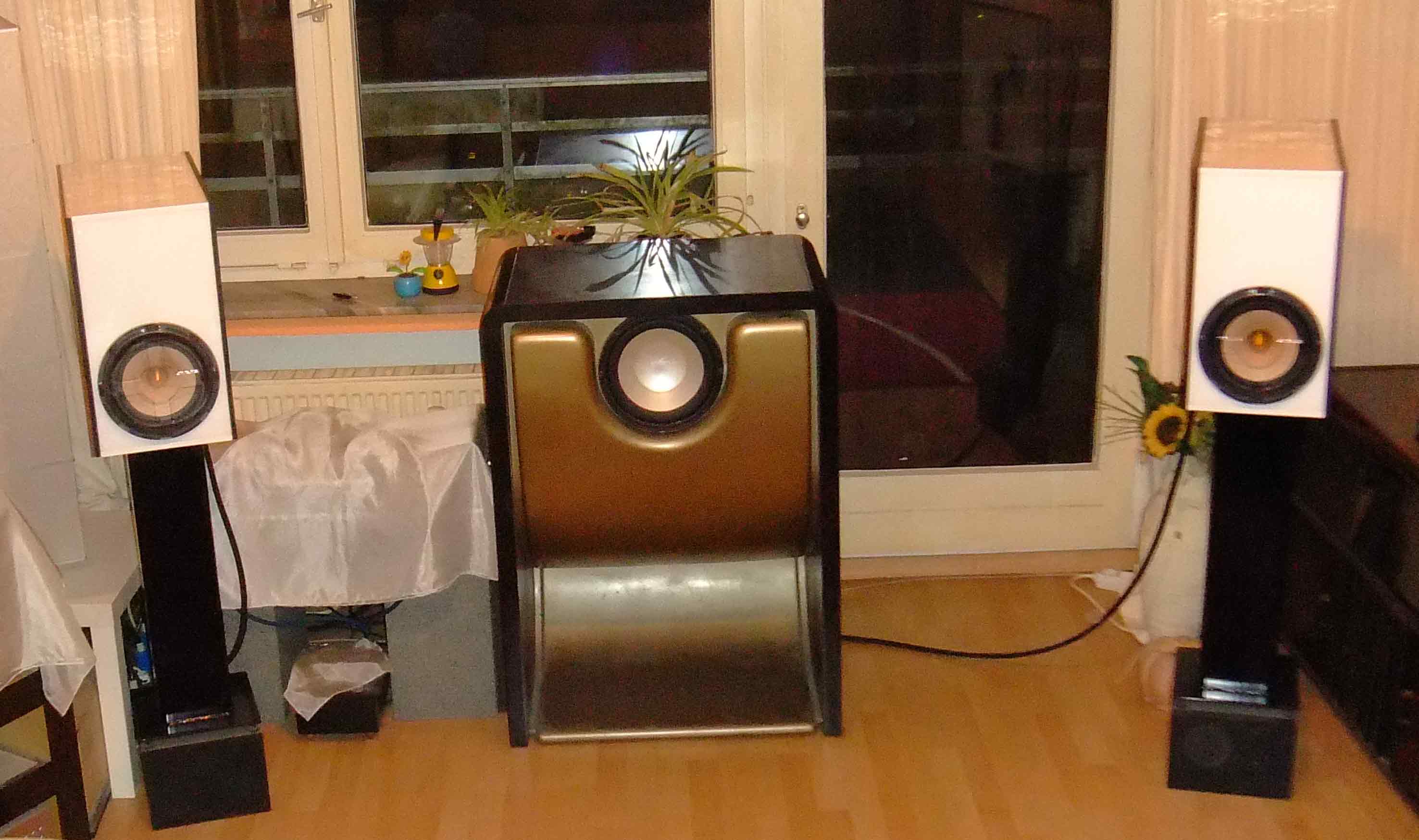

Hello ,
i found in my horn tests, sonic problems of such driver depents on single working,
look my double horns with measurements and feedback, SAXOPHON, POSAUNE XL,
RDH20 and if a sub added SAtellit the SCHALMEI-SAT, Horn-SAT

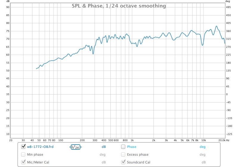

I'll have to re-visit 1772 and the stamped frame AN8 to give much input. My AN8's free air resonance moved from about 42Hz to the 60's area, moving Qts upwards too to around 0.38. I don't know if the resonance would go back down with play or not (- guessing "not")
1772 sounds reasonably neutral - like a well executed small 2-way. I think it worked OK in the little BK20 cabinet. I've run it in Karlson type from K12 (about 1.3 cubic foot rear chamber)downwards to K8 size (about 1/2 cubic foot rear chamber) In that application it seemed to prefer no more than around 1 cubic foot rear chamber. 1772 had 2-5dB more output in the 110-220Hz octave in K12 than it did in the similar bulk skinny K-coupler in the Youtube clips below.
btw, the Eminence 12CX I use with 80oz magnet, is about 6-7dB hotter than a 1772.
AN8 has a dark-ish midrange compared to FE206EN - I'm not sure how much of that is from FE206EN's high-Q 3K6 peak (?)

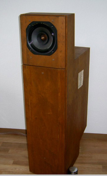

hm, good photos! In your photos, is the 1808 in "non-horn" box?

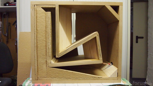

here's an 11 cubic foot Yorkville pipe-horn vs a crude K15 size K-coupler loaded with an 18 inch Eminence. The K-coupler was tuned a bit lower than what I would use and lacked the rear lowpass shelf of K15. The K had 20dB less distortion than the horn which cost me a lot and was brand new.
regular Karlson may not be suitable for subwoofer - although using one like Exemplar was the best I heard. (that uses two 3" ID right angle PVC elbows mounted over the regular 4.5"x9" port and a 515 Altec - I used a 416 - also, boost is applied at ~30Hz)
I'm curious but I don't see the attached image... sometimes I'm unable to see direct attached images, and only see the ones at "normal attachments". Probably a firewall error...🙁here's an 11 cubic foot Yorkville pipe-horn vs a crude K15 size K-coupler loaded with an 18 inch Eminence. The K-coupler was tuned a bit lower than what I would use and lacked the rear lowpass shelf of K15. The K had 20dB less distortion than the horn which cost me a lot and was brand new.
