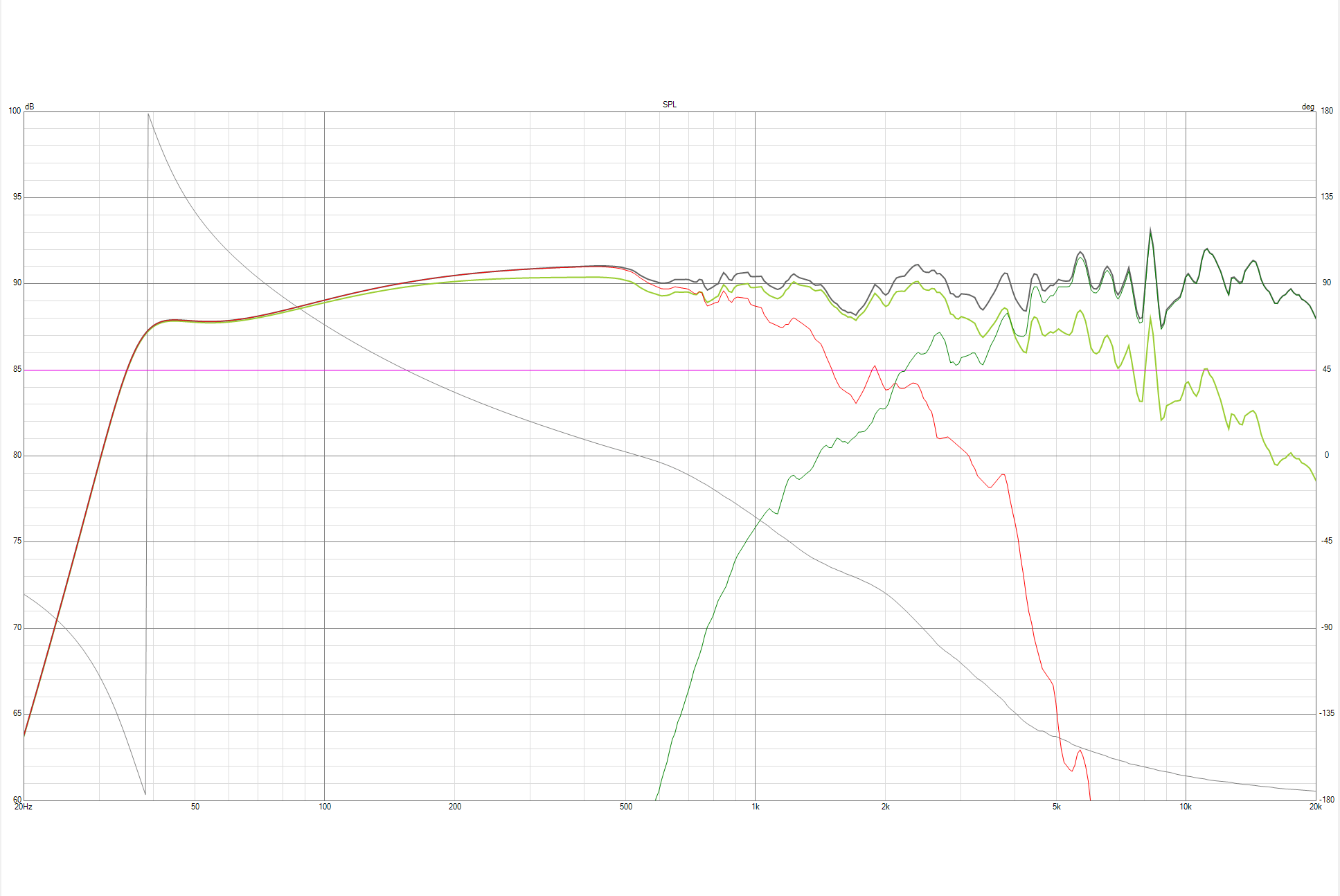

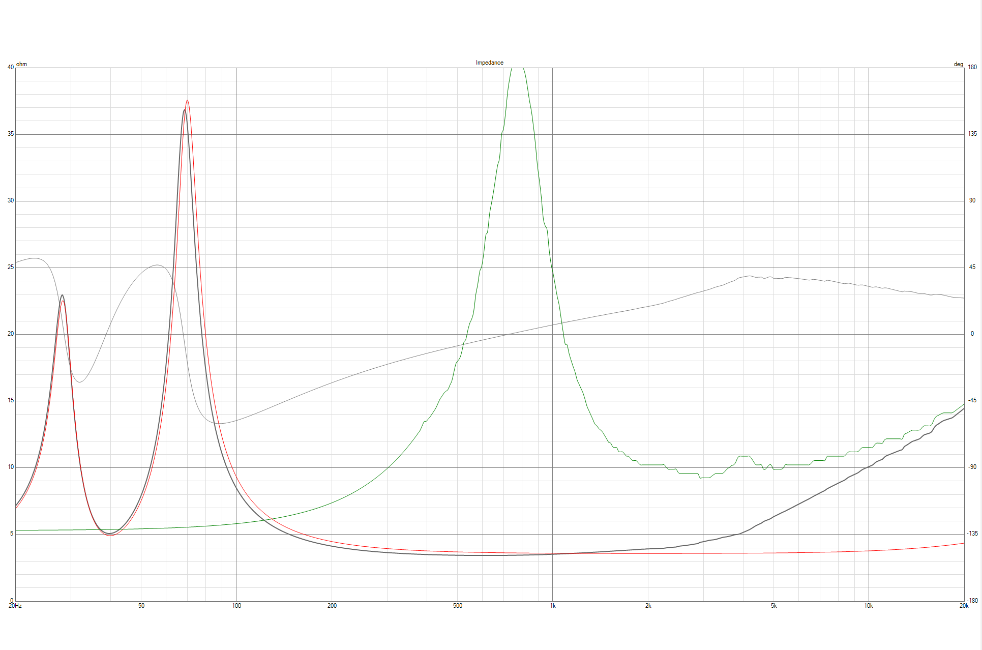

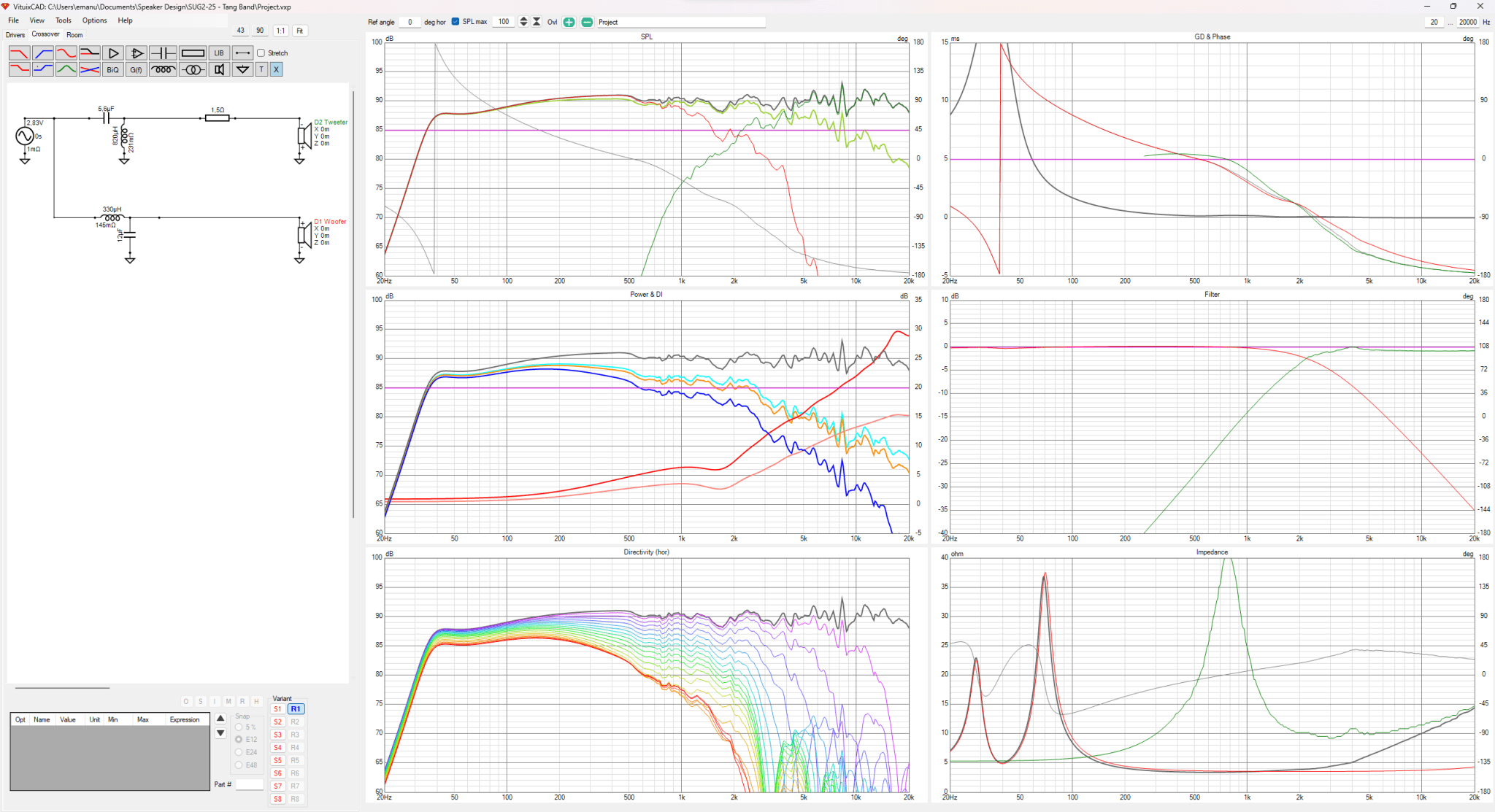

Hi everyone
A while ago I found on the tang band website the SUG2-25 project based on the Tang Bang w6-2313 full range speaker. I was curious and decided to simulate the crossover given on the tang band website for this project. The thing is the graphs don't look very similar to the one given by tang band on this speaker project. Anybody had the same experience? Since I don't have the speaker I can't make any kind of measurement, but I tried to "fix" the crossover at least. Open to suggestions to improve the circuit!
The speaker is a 17 L box, with a 300x64 mm port. Also if anybody has better suggestions to use this full ranger let me know!

Thank you! I read all the thread and there is a lot of information. But in the measurements taken by onni the voltage is not specified, making it impossible to understand the tweeter level at 2,83 v. Same for the woofer. I use vituixcad to simulate enclosure, diffraction and crossover. The woofer enclosure response calculated at 2,83 v reaches 91 db. But onni's measurements seem to be taken with lower voltage, since the max level of the woofer is 75 db in its graph. Eventually I cannot make merged files for this reason and cannot simulate your crossover properly.
Do you have frequency response files at 2,83 v?
Thanks in advance!

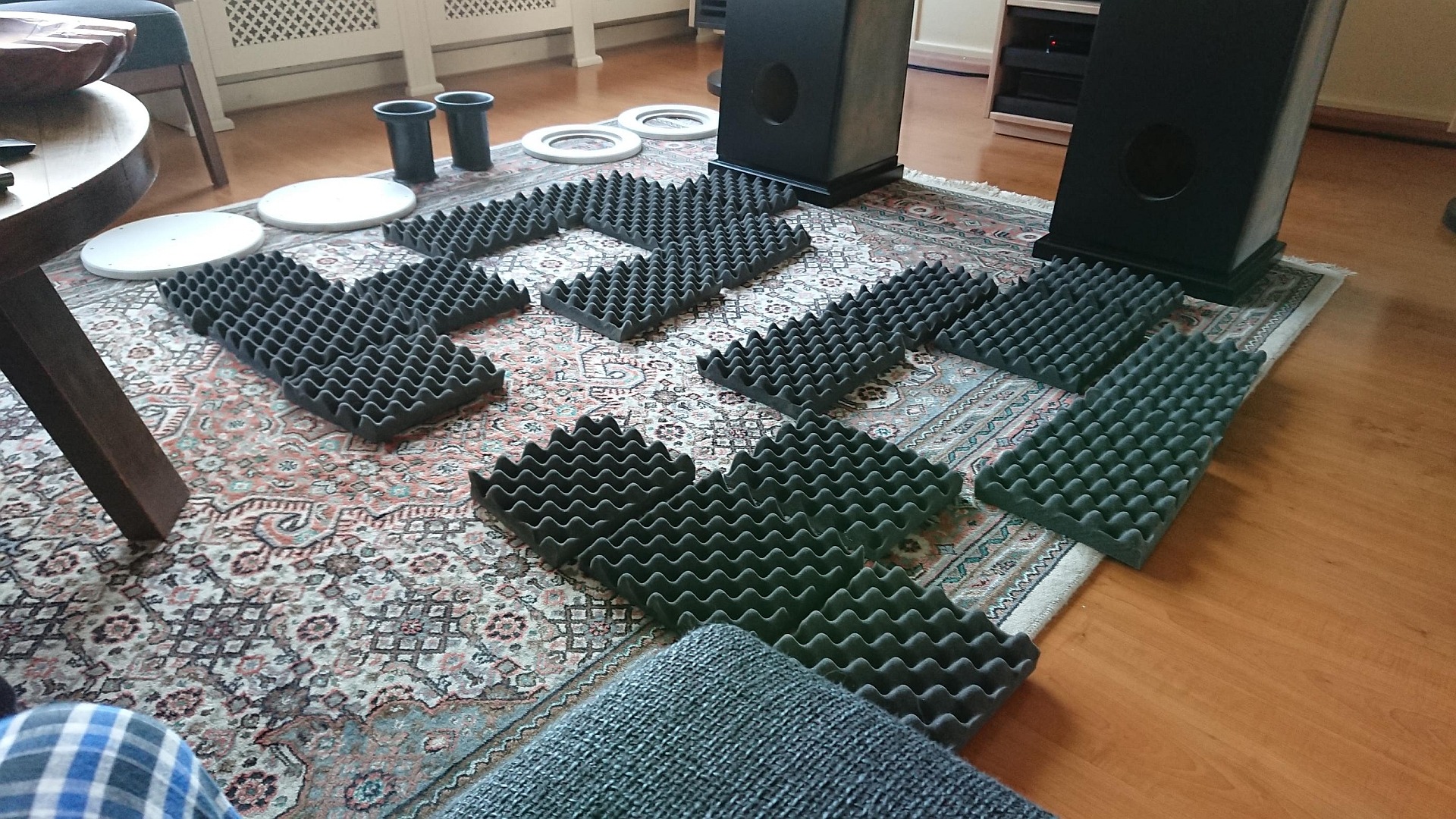

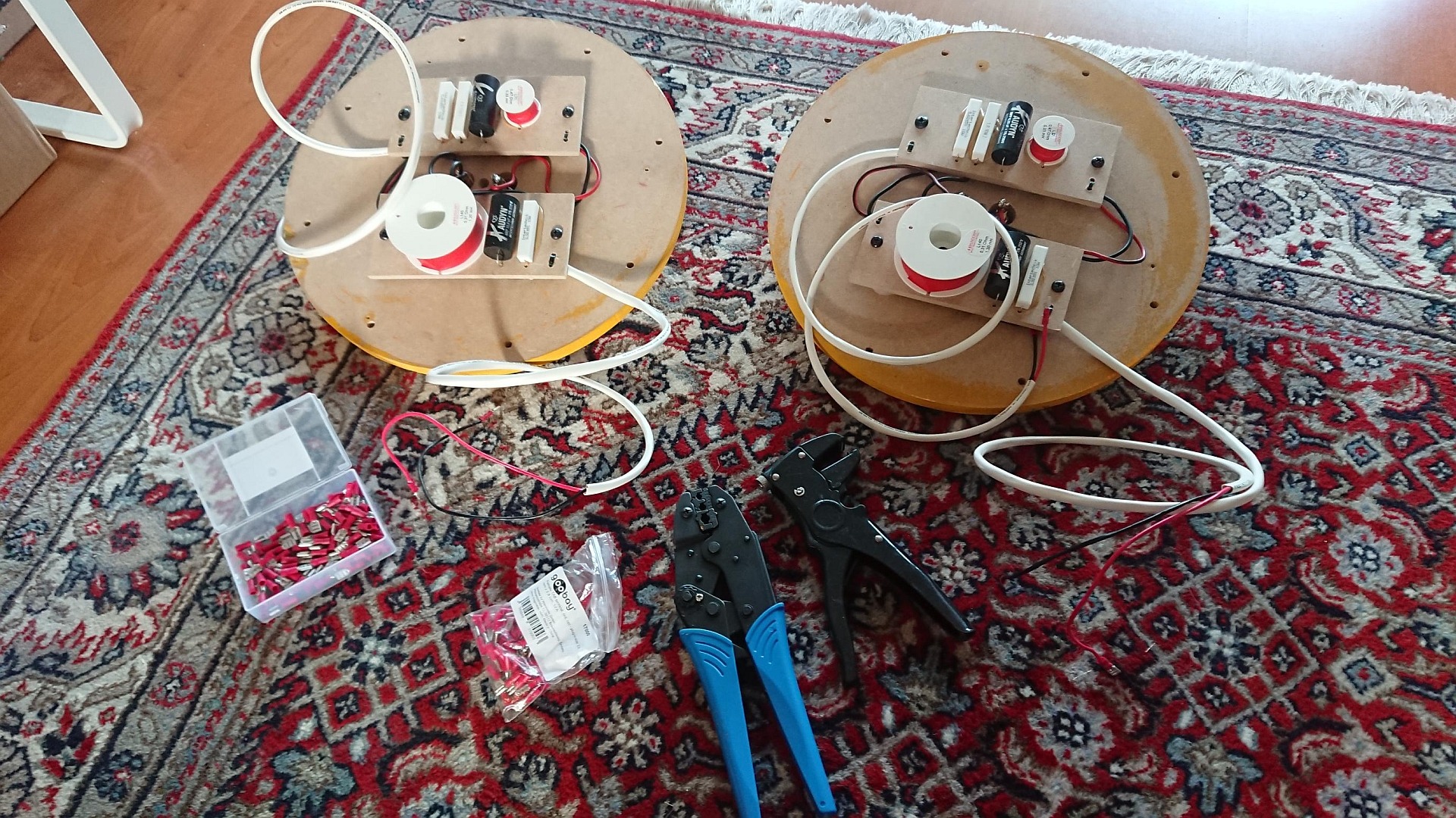

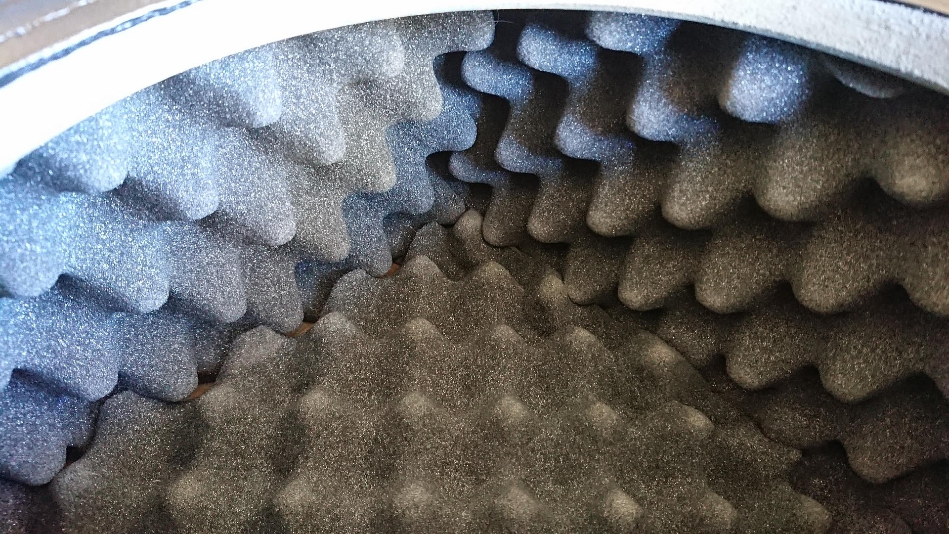

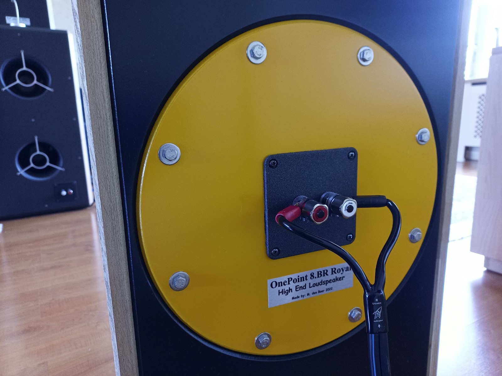

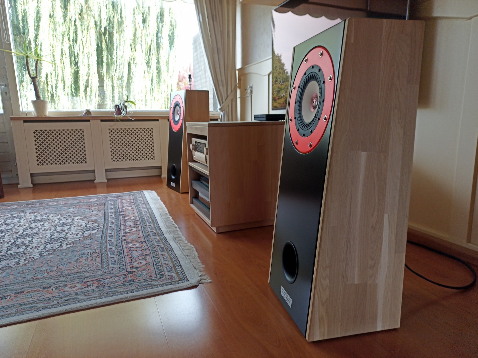

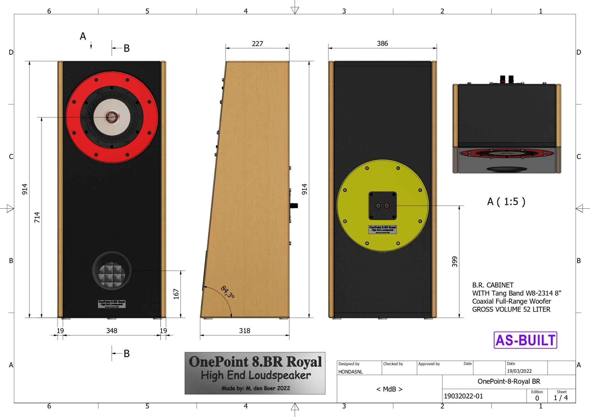

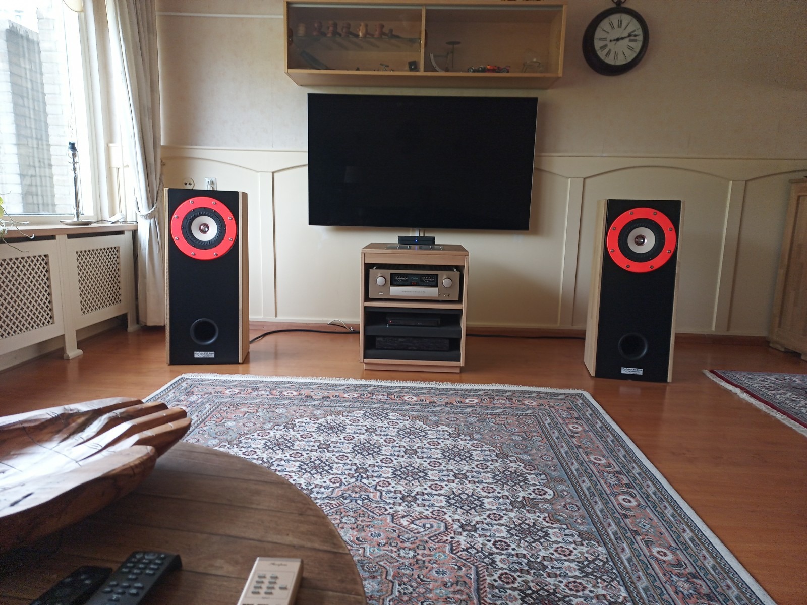

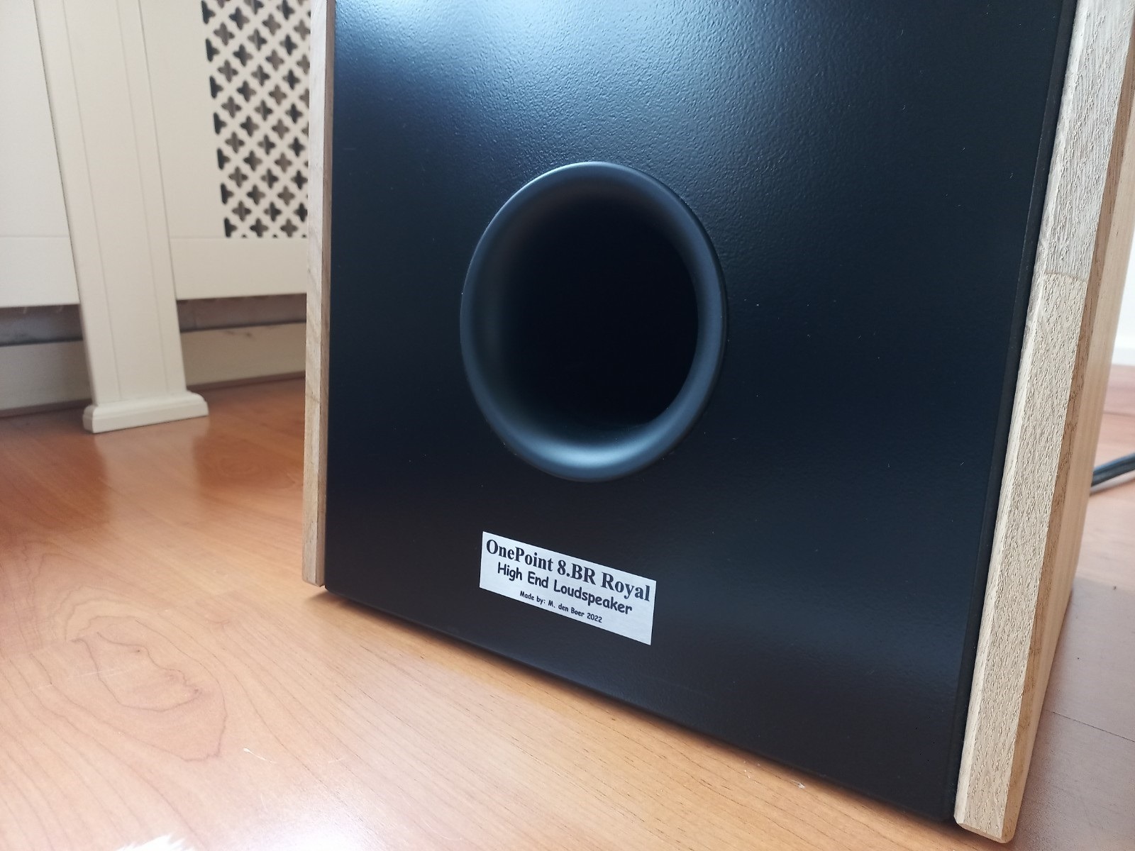

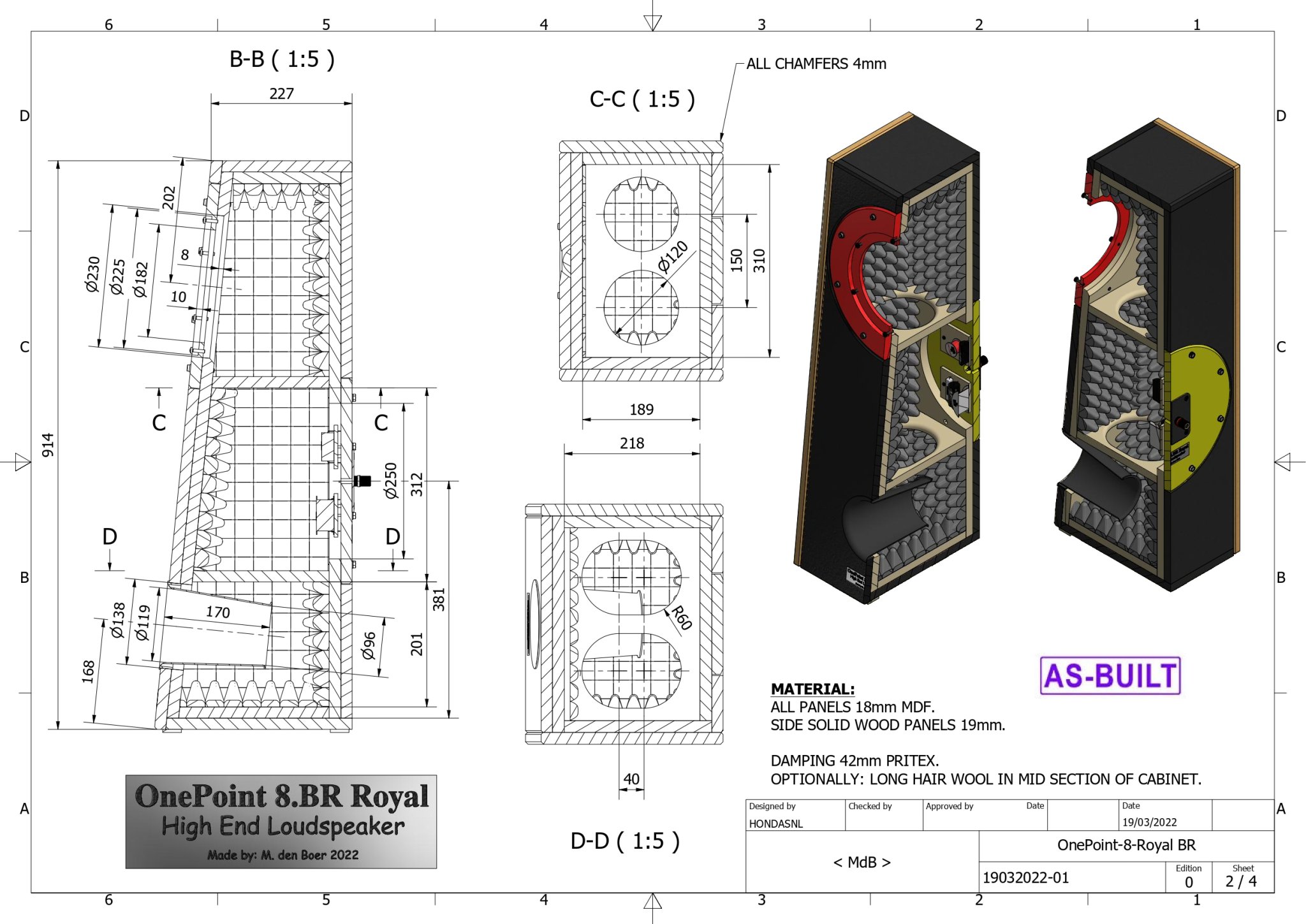

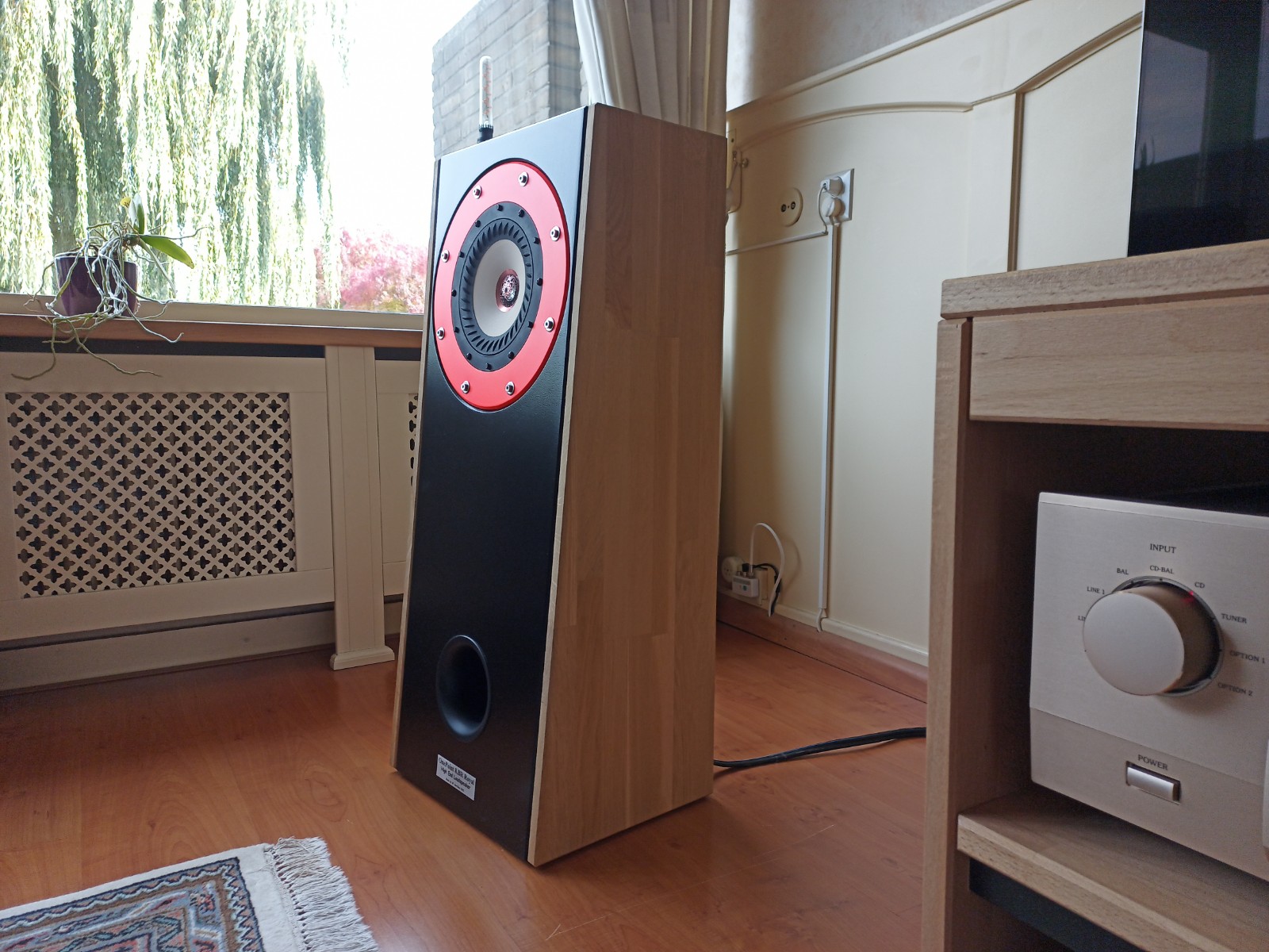

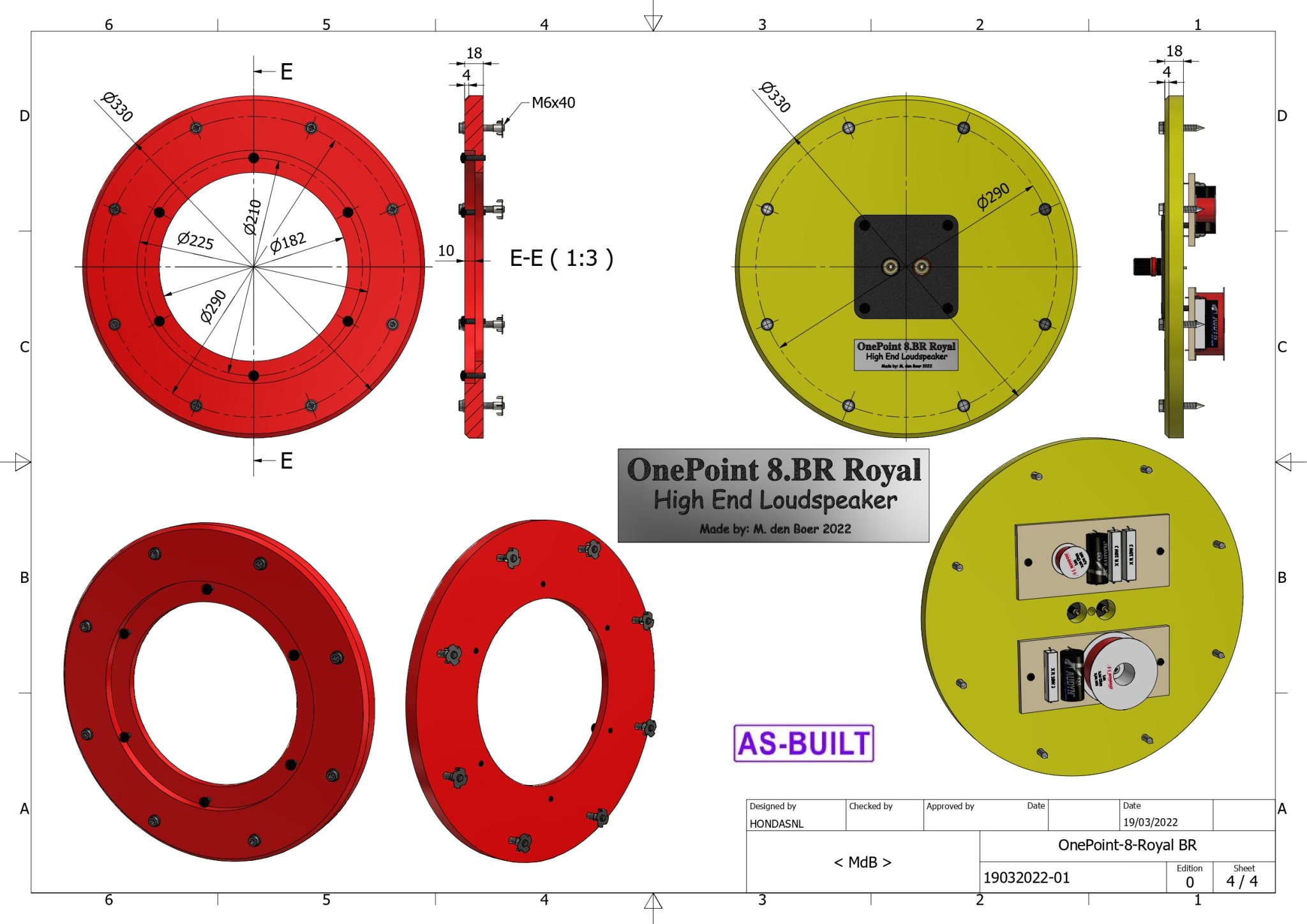

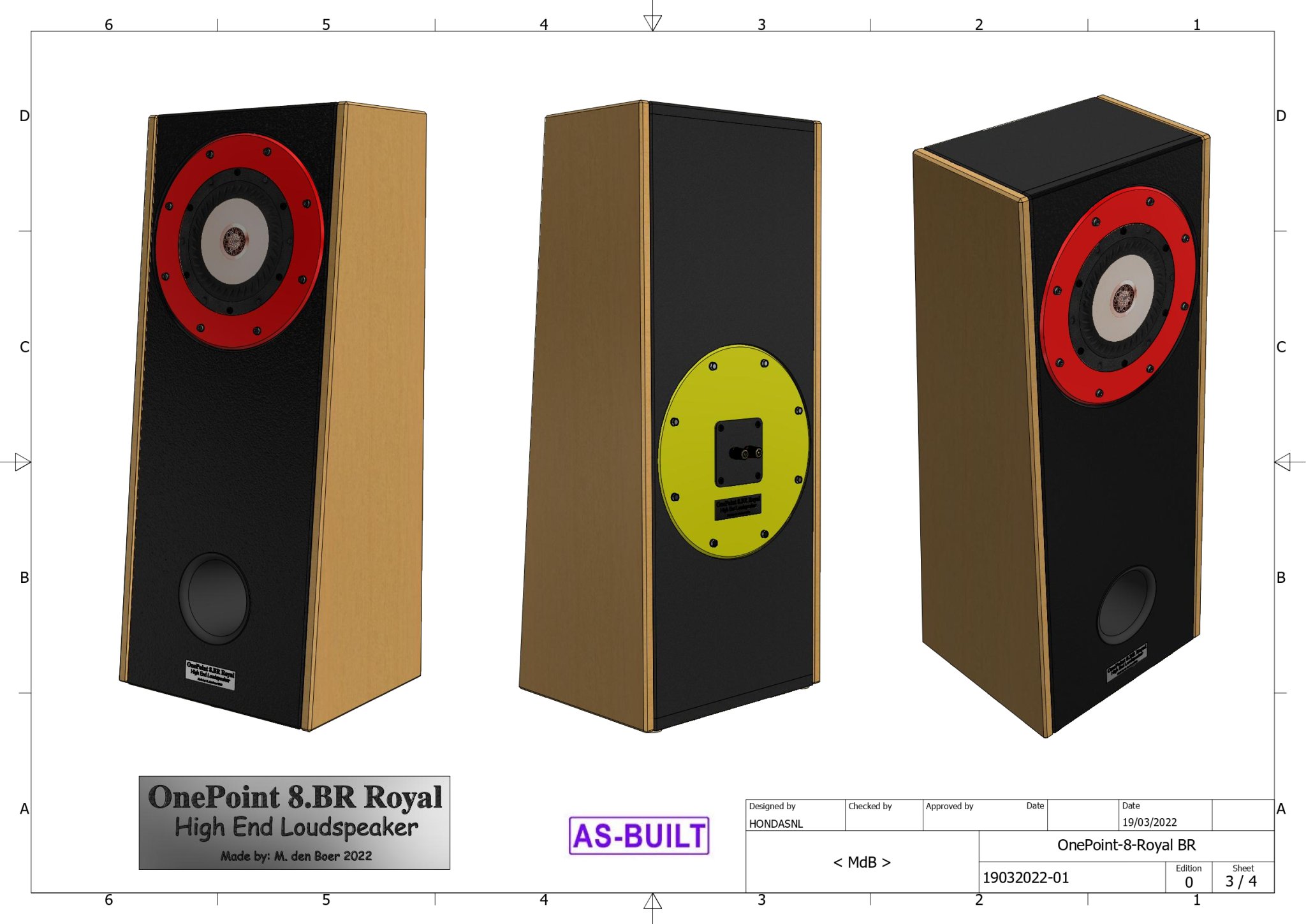

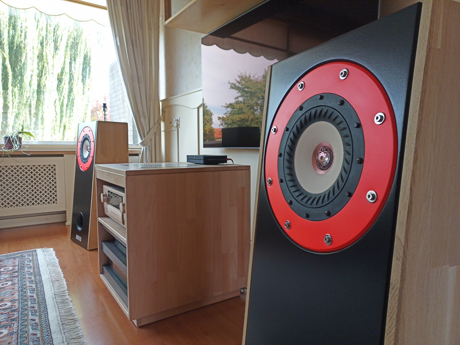

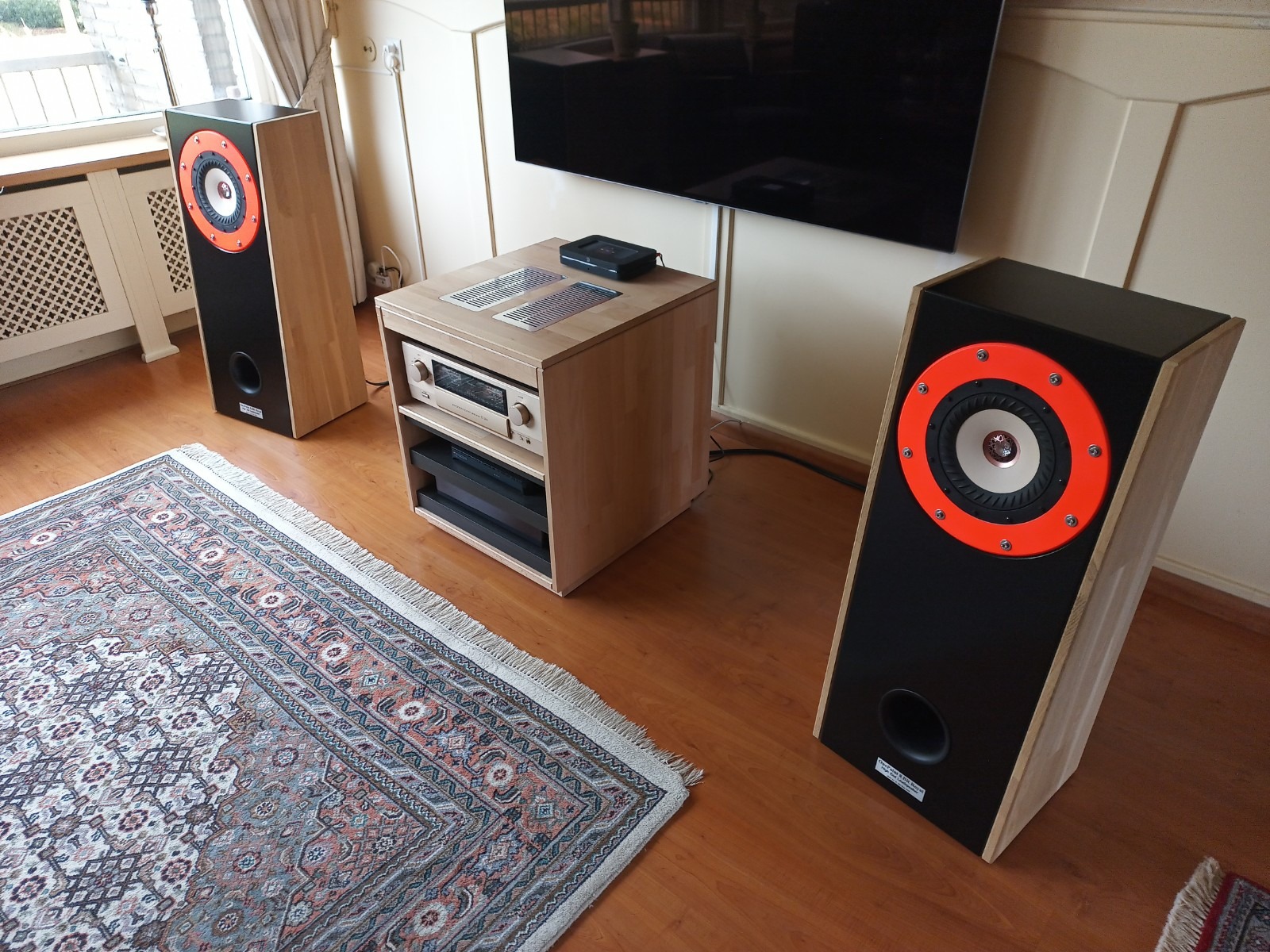

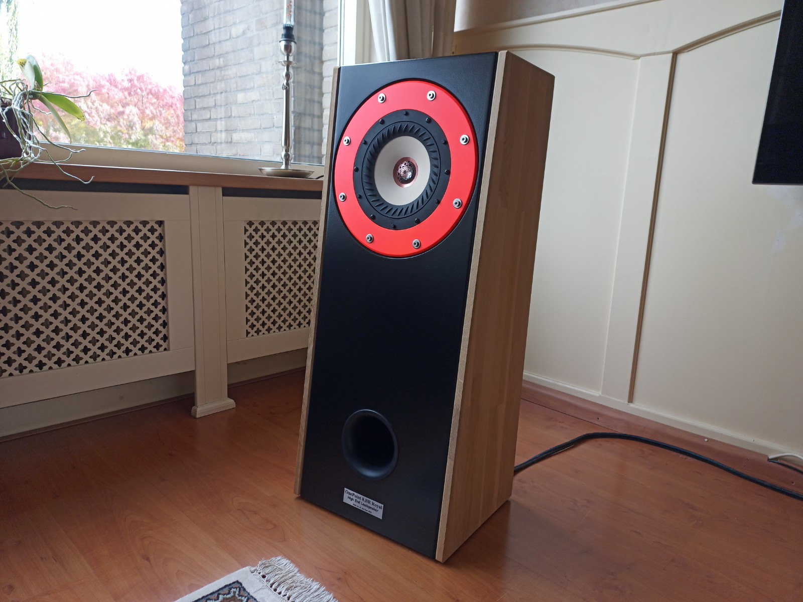

Beautifull drivers!
I'v built the original concept of Omnes Audio OnePoint 8.BR Royal with the Tang Band W8-2314 in 2022.
But I'll modify the BR port to a diameter 80mm x length 130mm -> port tuning 40Hz.
Original design is a little bit tuned too high with 100mm ports (too much bass).
So in the future I'll replace the existing 100mm ports by 80mm ports and tune it lower.
