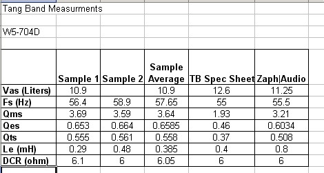

I have measured them with Speaker Workshop. I think it went well, except for I could not get VAS on the second driver, just came up blank or a really low number that rounded to zero.
Attached are the results. My Fs came out a little higher then Zaph's and Tang Band's.
I plan on doing the design with FRC tools, except for the woofer measurements (complete) and the inbox impedance/phase (which will be done with Speaker Workshop). I will start the design "from scratch", again.

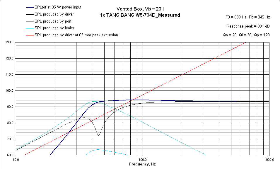

Plan is a ported enclosure, 20-Liters, Fb = 45 Hz w/ (2) 1.5" ports that I hope to fit on the front baffle. Assuming 3 dB of BSC since these will be a bureau.
In my reference thread, someone mentioned that even though the response looks flat, it will be boomy. Any comments on this design? Still a concern?
Max. excursion is hit with only 5-watts. I am assuming about 3 db of boundary gain, so approx. 90-dB of output @ 1 meter.

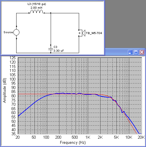

I quickly modeled a low pass filter for a single TB W5-704---the old 704S version has the same response as the new 704D. I used an in-box modeled response that was used for my 2.5-way design:
http://www.diyaudio.com/forums/showthread.php?postid=1422714#post1422714
Your baffle will be different from this, but the effect due to different baffles should be minimal. Mine is a sealed design. So, ignore the response below 200 Hz.
The target is LR4 4 kHz.
Thanks Jay- the LR4 @ 4k Hz looks promising. I am surprised you got full BSC without a LR filter. My original attempts failed at this....encouraging.
I want to cross over to the Daytons high to avoid some of the distortion issues below 4 kHz.
I agree, a sealed version crossed to sub would be a nice design. Mine are slated for a bedroom...no subs allowed.
P.S.- The lower tuning also moves the sub-Fb over excursion below 40-Hz, which i like.

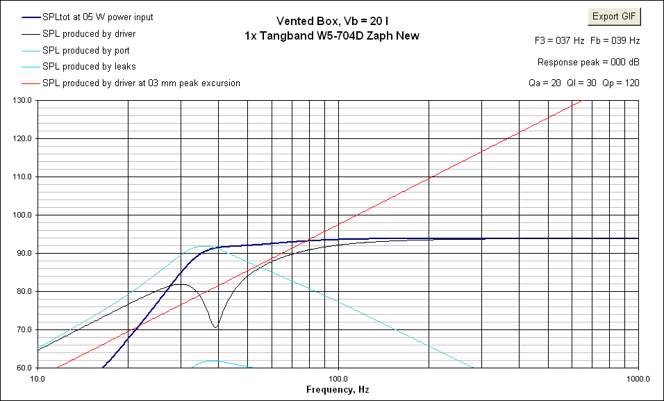

20L box with driver of Vas = 8L, Fs = 62Hz, and Qts = 0.6 ?
It will work but this is no way to extract the best performance out
of a box that size, a bigger driver is required. Whenever the box size
exceeds 200% of the driver Vas you are usually wasting your time.
Sealed is the obvious way to go, 7L to 10L well stuffed.
Comparatively no bass, but it will not overload easily.
If you must reflex, probably 13L tuned to 40Hz is about right.
Tight bass you will not get, 20L will probably sound even looser.
Allegedly higher Qts drivers can be made to work in stuffed TL's,
but MJK's worksheets I've not got into and got to grips with.
🙂/sreten.
Yes, no doubt power handling will be an issue. When we consider BSC, a single speaker's max SPL will be 88-89 dB at 1 m. This limitation won't improve much even when a 13-14 liter (.5 cu ft) box is used for a single driver. In fact, the idea of using a single TB W5-704 for full range, whether vented or sealed, will result in having this problem, though sealed is better, of course.
So, the bottom line is 1) use it in sealed with HP filter and a subwoofer or 2) admit this limitation and use it only for moderate level listeninig. Or use multiple drivers. IIRC, he already admitted the limitation. So, it's up to him.
Sreten just FYI: most of us have being measuring about 11-13L Vas and .45 Qts
It's very important with this driver to consider it's final use, whether HT, music, maybe music with pipe organs etc. If you can cross to a sub then no worries. With a 80 Hz crossover you can run 32 watts at Xmax, with a 60 Hz you can run 16 watts at xmax. You could also run without a sub if your receiver has a very low XO setting, say <40 Hz. That way you could get mostly the same bass response >50 Hz where the music is, but still protect from over excursion down low.
If you are using these for music with no sub I don't think you will need to tune too low and reduce power handling. Personally I'm going to use 15L tuned to 50 Hz. Higher power handling and excursion is lower above 45 Hz. Below 45 Hz it's worse, but most music doesn't have much info that low. I think the 20L tuned to 45 Hz would also be a decent alignment. I'm using pre made 15L boxes so I didn't choose that one.
