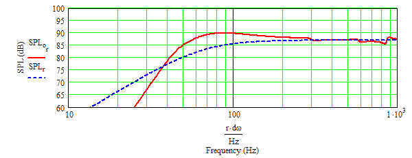

loninappleton said:
Would these vary from what is published as the T/S parameters?
Considerably, though the nature of MLTL's being what they are, about all they really mean is that less BSC is required. Backed up against a wall though, they would probably need a longer vent, but then I consider fine tuning the vent in-room is almost always a part of DIY speaker building:
GM

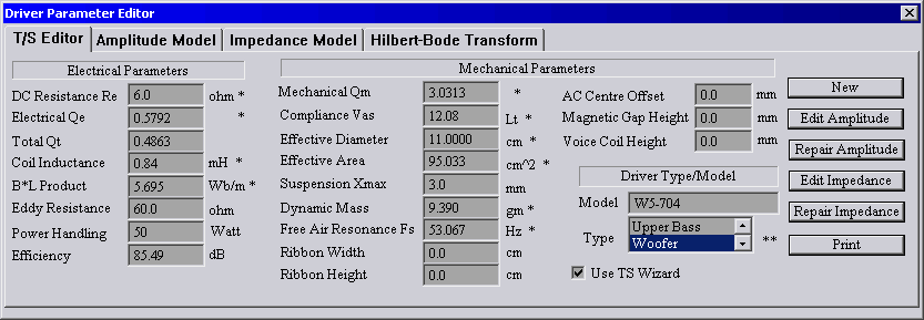

GM
Cool. Well I might order one then. Far as tuning, I have lots of PVC pipe around yet. I like putting them int he bottom.
