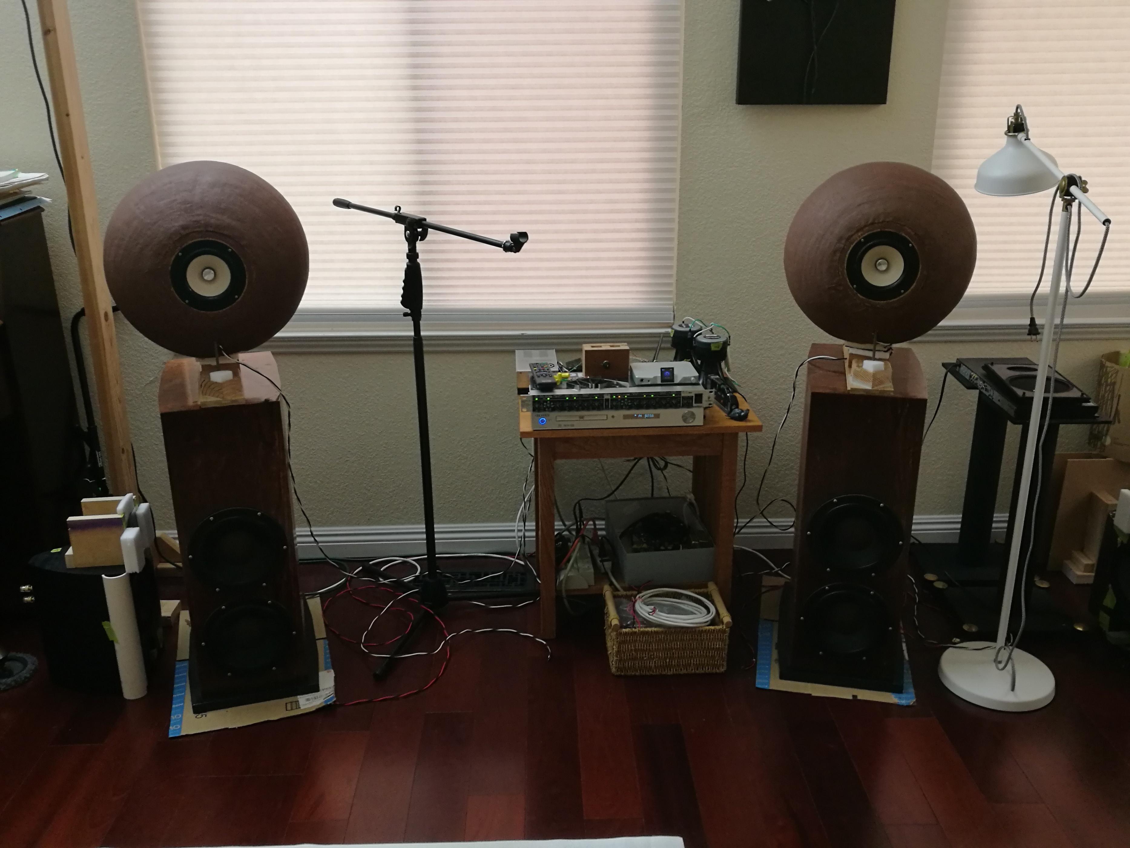

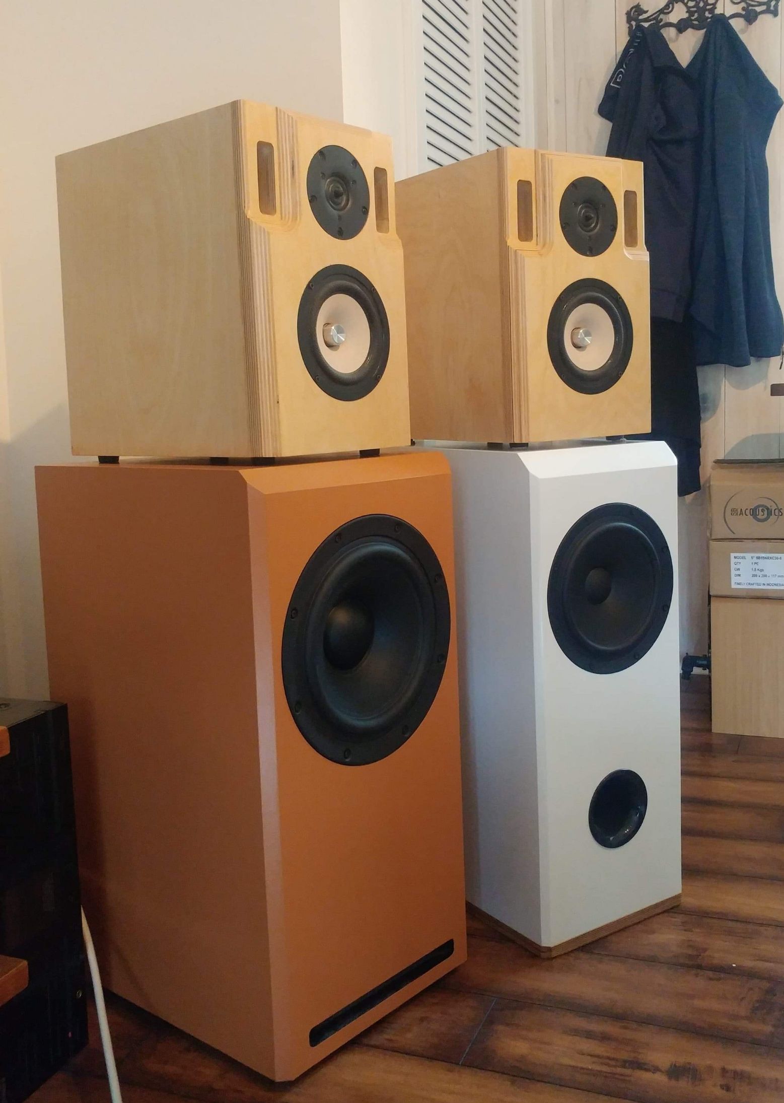

I have the TB W5s in a 10-12 liter memory bass reflex with a Peerless XT25TG30-04 tweeter cut to 12khz with a 1ohms resistor and 1uf capacitor (from memory, but I can confirm). The tweeter is not needed but it adds a bit more extreme high. The bass of the W5 in BR is relatively good. The W5 is an easy going fullrange and gives no hearing fatigue.
These strengths: excellent with acoustic music and vocals.
It is in bi-amplification mode, so to power the SB29 or SB23 woofers, there is an active filter in front of an amplifier, cut at 225hz in 12db.
The amplifier for the W5 is a class AB and a class D amplifier for woofers (IRS2092 2 x 250w).
