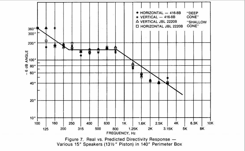

Majerjack I'm wondering how it can have good off axis response, because the cone shape is the same as the polypropilene version, and they beam like mad in HF, if you move your head out of the sweet spot there is no more magic that they produce like no other, btw. I have bought the white ones but not tried yet, just tried one no baffle in hand to hear if it's good, and it is! 😀
Beaming is generally a function of cone size. Cone shape, dust cap design, and surround can improve it slightly. Judging by the deep cone, flat plug, and standard half roll surround I would say these would have about average off axis response for a 5 incher.

I thought that too, that a deep cone has worse dispersion.
Altec did some comparison testing Vs predicted with some interesting results:
GM
