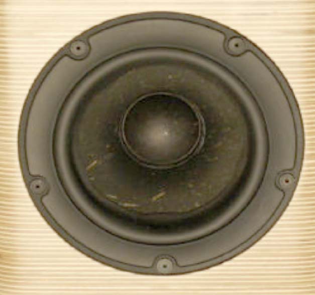

First guess on the Raven's drivers is some kind of ScanSpeak

...some kind of ScanSpeak
I doubt it. It wouldneed to be very custom. The only driver they have that looks similar has 5 mounting holes, better detail work, and is challenged above 1k.
Attached is a photoshopped pic that reveals more detail.
dave
I briefly looked into it a while back; Birch appear to be using the 5 1/4in Vifa NE149W: Vifa NE149W-08 5-1/4" Fiber Cone Woofer Speaker 8 Ohm & http://www.parts-express.com/pedocs/specs/264-1132-parts-express-specifications.pdf
Can't say I'd use it myself; the FR graph appears honest, but the general spec. suggests an over-driven midbass rather than a unit that was designed as a widebander from the outset, so to my eyes it's compromised both for that use, and for use in a 2-way. TBH, I can't really fathom what Vifa have been trying to do with any of the NE series drivers. From the published data, none look all that special in performance terms.
Indeed it appears to be Vifa NE149W 5-1/4" Fiber Cone Woofer Speaker - while an very, very good mid woofer it is really not very suitable for full range duties - interesting choice… for this speaker…

I briefly looked into it a while back; Birch appear to be using the 5 1/4in Vifa NE149W.
The unique basket would say yes, that is the one. 4 of those would come to 93 dB, not 96.
