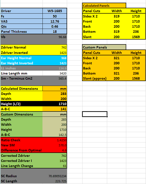

Can someone talk me out of building these please. I have had my eye on these drivers for a while.
Tang Band W5-1685 BIB with a helper tweeter crossed at 9K ish..
http://www.parts-express.com/pdf/264-873s.pdf

You will need room inside the BIB for the magnet on that TB. Measure twice and build once. What kind of tweeter are you thinking about using?

You'll certainly need a tweeter on the TB, above all for off-axis performance; that massive surround will make the off-axis power-response dodgy at best, especially in the HF; in practice I suspect they'll be falling off a cliff above 10KHz or so. TB themselves class it as a midbass, not an FR, although you should be able to cross higher than most midbass units, which is a good thing.
