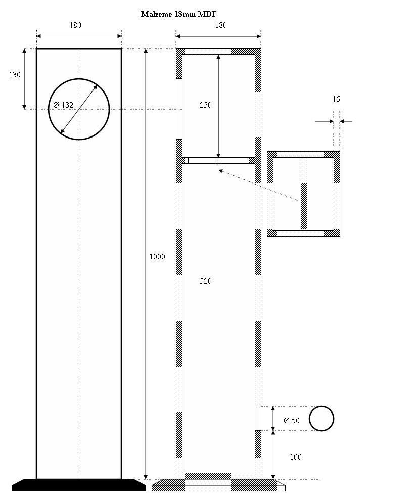

I'd like to make a pair of simple T&B W5-1611SA box tuned at 54.9Hz. And I've already calculated and drawn the box as follows.
My question is;
If I want to add a tweeter to this system like;
http://www.swanspeaker.com/product/htm/view.asp?id=23
(It looks suitable for TBs anyway..)
What kind of crossover should I use?
My opinion is just a 6dB/oct HP filter for tweeter will be enough..
What do you say?
Thx in advance..

Hi there - just bringing up this thread again to see if there's any progress. this looks like an interesting fullrange unit - especially for the price!
andy
andy
I wonder if Ozgur is still waiting for his answers.....
btw: if a tweeter with the W5-1611, then just make it a back firing ambient tweeter, don't mess up the FR, just ad a bit of sparkle
In fact I was giving up that project. However the fever push me again to make one 1611 project!
My tweeter question is not exist anymore!
Last week I visited the local dealer again. And listened the 1611 one more time. Then I decided that it doesnt need a tweeter. May be the last time I listened it had a LR filter and now not.
Anyway, I'd like to make that project.
Any suggestion will be usefull for me..
Has anyone tried that speaker?
