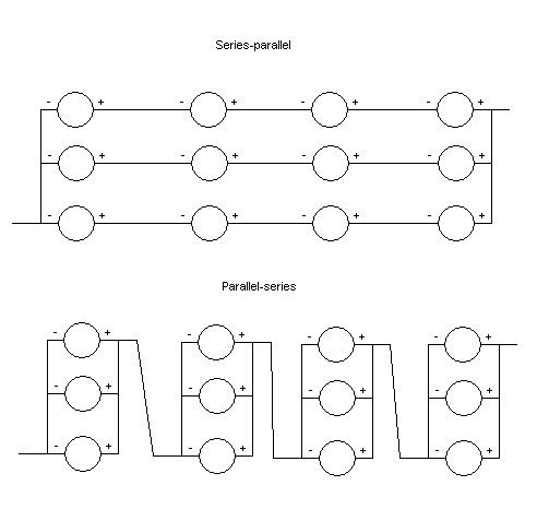

It looks like an excellent alternative to the Fostex FE103En as it has a neo magnet and more bass.
But it has a hard-to-work-with 6 ohm so we can't wire 2 or 5 for a line array unless you've got an higher end amp that can handle 3ohm (closer to 4) loads.
As an aside, you can easily arrange 12 of these to present an 8 ohm load. Both arrangements in the attached image will present an 8 ohm load, but, the second (Parallel-series) will present a 9 ohm load on single driver failure, vs. 12 ohm on the first (Series-parallel).

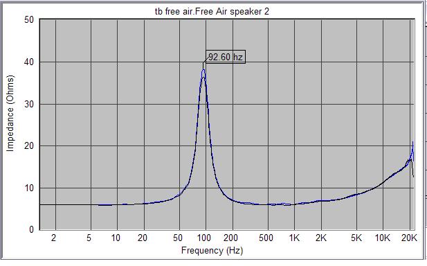

impedance measurement
I received the speakers and played them over 100 hours with pink noise. The impedance measurements is showing the peak at 92hz rather than 70 as in the published specs (graph includes two speakers). I am using speaker workshop for the measurements, just calibrated to the reference resistors. Passive measurements of resistors are right on so I assume the impedance measurement is good. I am not quite sure how to do the full range frequency response measurement with the software, once I figure it out I will post it. I will try measuring the T/S as well.
The dust cap appears to be easily removable (I don't want to remove it yet), with the leads to the coil attached below the cone right above the spider.
Serial numbers are #80 and 194 so they may be from the first batch, lot 8F100302.
I put them on a 14 L BR and I can tell the sound much better than the Pioneer 4 inch from Parts Express.
