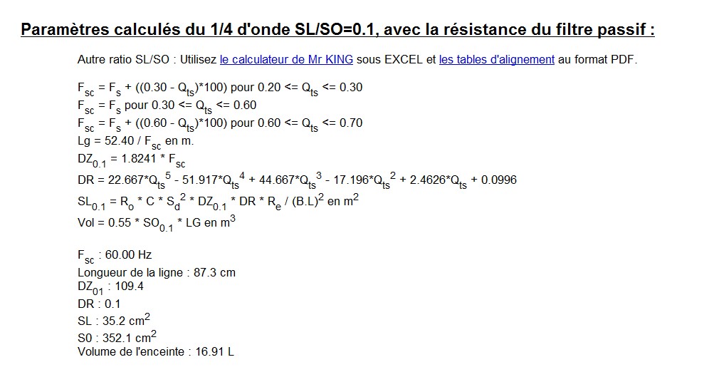

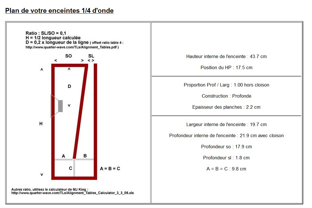

Hi guys,
I can give you a modeled enclosure for the driver, but I'm not used to TL's or 1/4 waves just for the sim (sorry for being in French). Maybe other members can give you a better design.😀

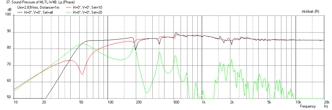

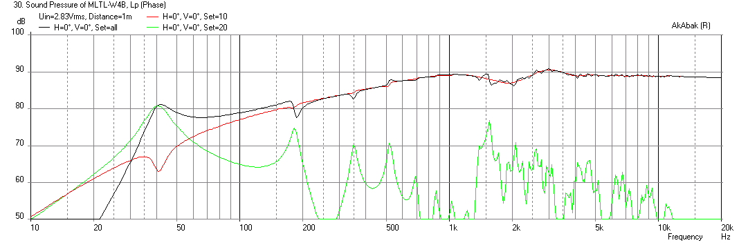

Here are sims for the W4-2142.
As specified with 6in x 6.75in x 39in and 2in dia x 4in vent the cabinet is too big for the Vas and the tuning too deep - you will have very unbalanced response and it will sound anemic. With room gain, you may be able to pull up by corner placement, but far from walls this is what you will get without any BSC:
The above has treble that is almost 10dB greater than bass. If you heavily BSC it, the overall sensitivity will be about 78dB and have a saddle in the mid bass.

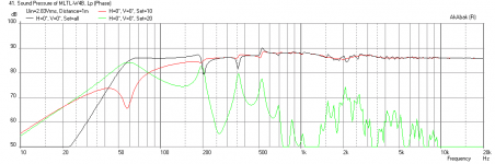

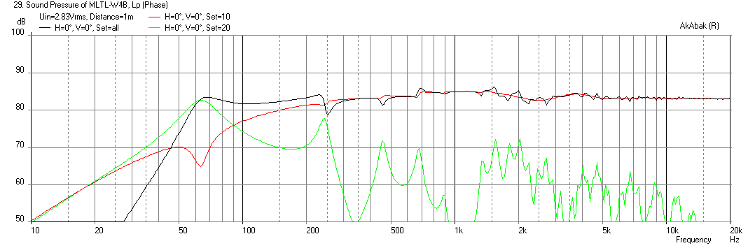

If you make the size much smaller at 5.5in wide x 4.5in deep x 31in tall and 2in dia x 3.5in duct and 6ohm+1.2mH BSC, you will get 63Hz tuning more appropriate for the driver and balanced 83dB sensitivity that will sound much better:

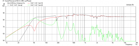

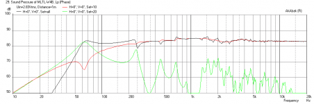

For the W5-2432, the cabinet is much more appropriate and just change vent to 2.5in dia x 3in long for 54Hz tuning, add a 1.25mH+7ohm BSC for an overall 85dB sensitive system with much more well behaved bass response:
Hope that helps and let us know how it works once you build it.

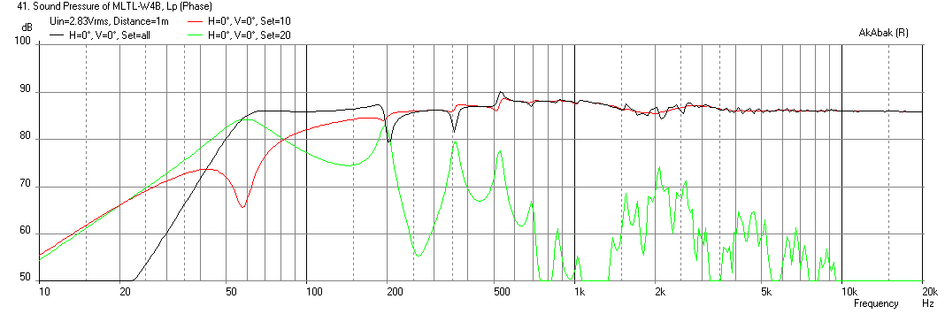

p.s., I would even suggest making the vent only 2.25in long for 57Hz tuning on the W5 to get a nicer bass response - 86dB, reduce BSC resistor to 5ohms:
