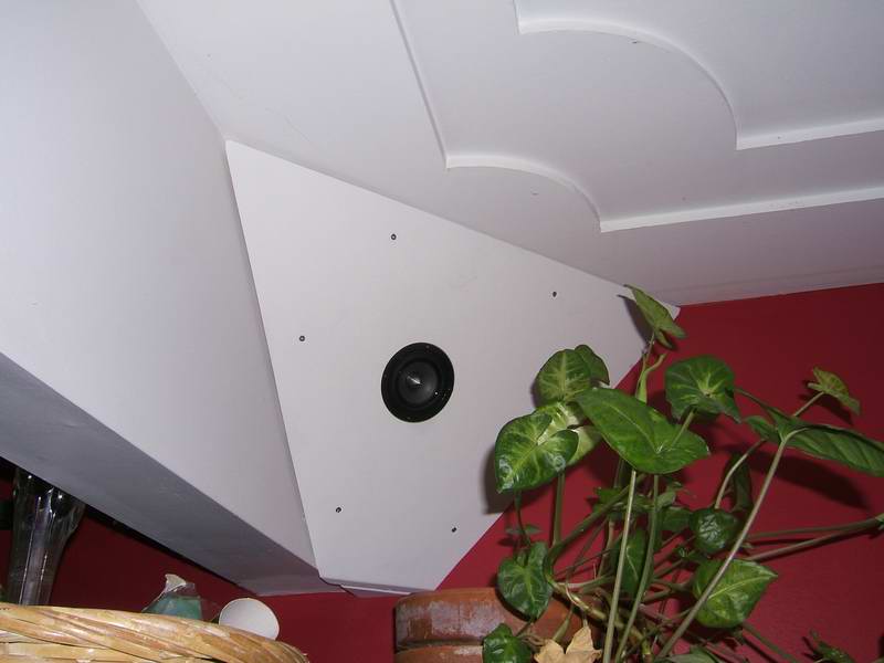

I'm using them.............
It depends on how you use them.............
I love them..........
so does my wife.............
But I use them weirdly..............
http://viewmorepics.myspace.com/ind...ID=180422547&albumID=1552714&imageID=24436482
With the qts .37 and Fs = 75hz (if they test near manu spec)........A .3ft3 port with 2 drivers, you can tune to 81hz giving you a f3 of 85hz..................
I use 2 divers in a large sealed box (qtc .45) because I'm using a 12" below them and want to approach open baffle mids quality................
The box is 8" wide and 13" tall.................
I need to play with baffle step.
Funny how the equations matched up exactly to my real life needs.
Playing with a 10 band eq, I needed +3db at 125hz, 250hz, and 500hz...........That filled in the mids nicely..............
Crossing them passively may be a pain due to impedance spikes close to crossover points due to box alignment.................

Did you see my pictures of it ?????????
