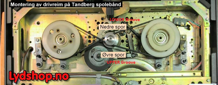

Seems that there are two main types of belts pre and post series 5.
www.lydshop.no seem to have both types as well as the belt for the counter in stock at approximately GBP 15.
www.lydshop.no/shop/product/drivremm-tandberg
The image attached is from their website and details belt installation.
Home | Soundsmith also seem to be able to supply at about same price.
Thanks LJT - that's very useful, as is the picture - because it confirms that the way the old belt is fitted now is how it's meant to be! Surprisingly the Service Manual does not include a diagram showing how the main drive belt should be installed.
I couldn't find any link via the index on Soundsmith's website to drive belts, but I guess that Lydshop is the way to go anyway.
Thanks for your help.

What have they thought at Tandberg's when they decided to cross the left drum's drive belt 😱 ? Is this planned obsolescence?
Best regards!
Best regards!
I've seen that discussed elsewhere, and it seems to be a practical measure so that they did not need two drive belts instead of the one, plus I think it saves one additional component.
If the belt did not cross then one tape reel would go in the wrong direction!
In practice it shouldn't cause any extra wear, as the belt cannot touch where it crosses - there are two separate grooves in the drive wheel.
