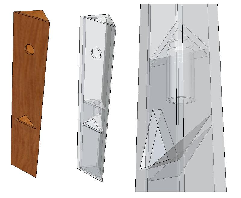

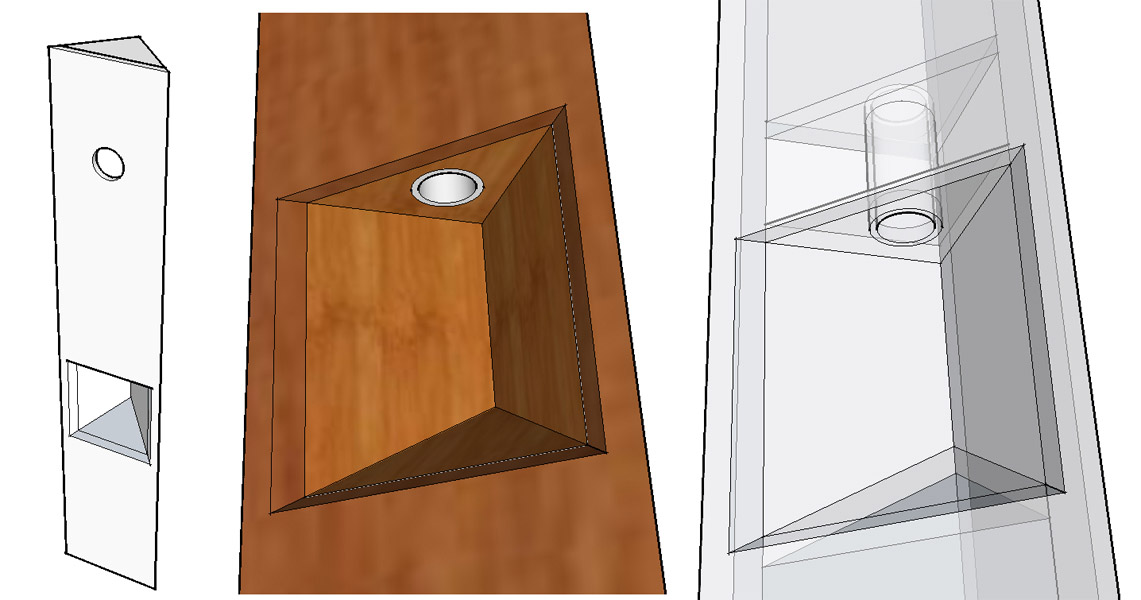

Please criticize
this design before I up and waste a lot of wood.
The air column behind the driver (w3-871) is the same length and has the same cross sectional area as original TABAQ. Port diameter is 2”, and length is 5.25”.
They are going to be my breakfast room/kitchen speakers. Driver height is just about midway between ear height of those sitting and standing.

The vent is going to have horrendous resonance issues unless you know exactly what you're doing. Otherwise should do fine.
