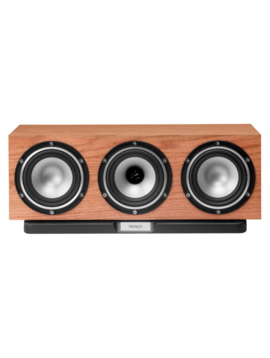

And then I saw these on the TANNOY site:
Now I've been reading about some of the drawbacks on MTM's, but I've read that alot of
that can be ameliorated using a coaxial in the center because of the lower crossover.
The XT mini centre comes off the plinth and I'll bet I could turn it sideways and use it like an MTM
configuration. Are there any drawbacks to this? I cant see why this speaker would perform much different than a left or right main. Here's the specs:
