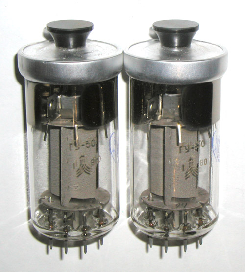

I would suggest sell this 300B amp ASAP and buy a popular Pentode amp where you can use cheap tubes as 6L6/EL34/6550/KT88/90/120/150 as Triode or better yet a GU50 amp $5 USD each.
GU50

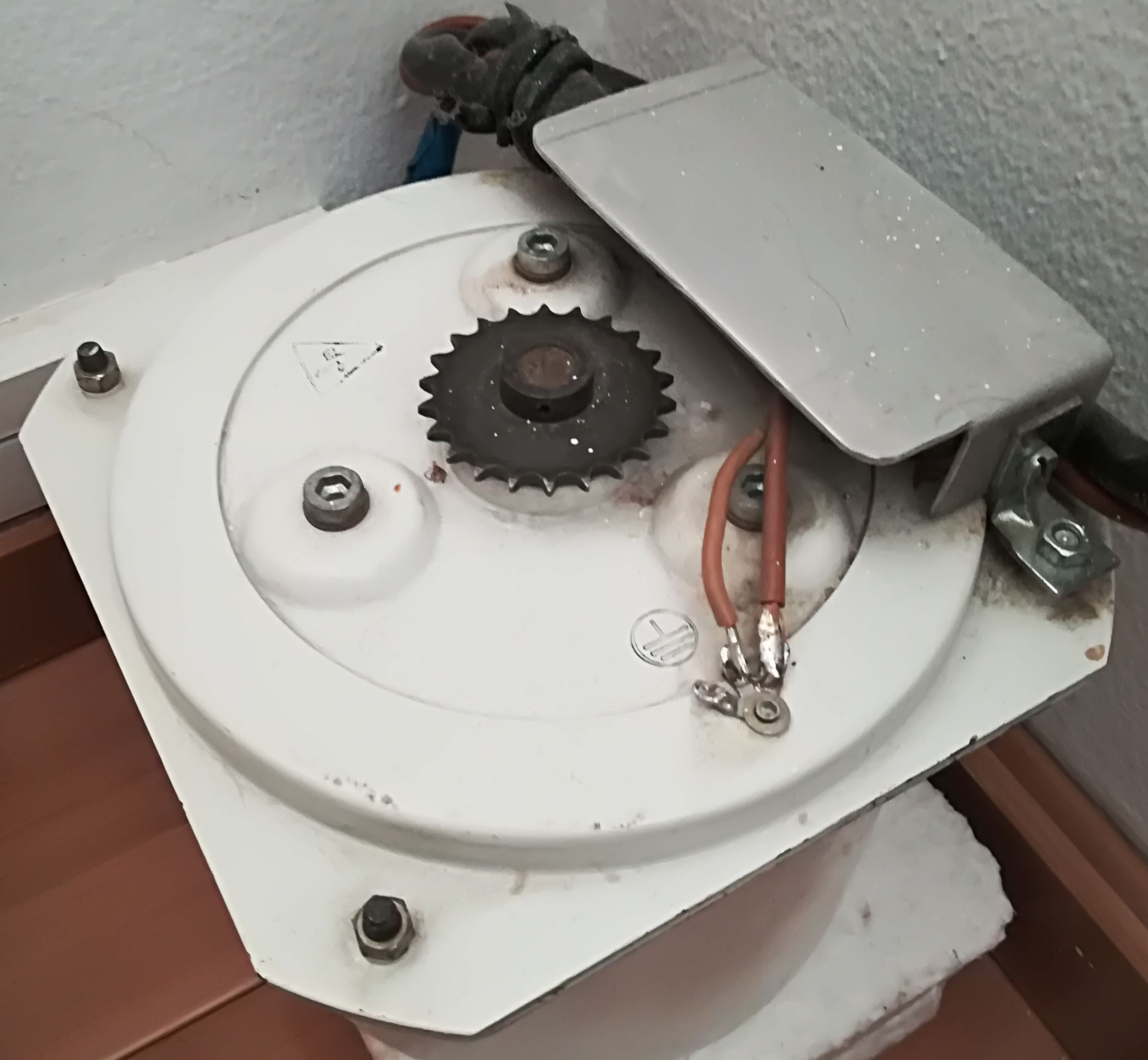

I have 300B SET for 17-18 years already (I listen about 3-4 hours a day, average)
Now it's just second pair of great NOS =C= 300B in my amp all this time.
I've never had any problems.
I always turn-ON all my tube gear very slow, with a 2.5KVA "Siemens" Medical variable power transformer.

They are probably expensive today.
I do not know what this model is, there is no label on it. It was part of a large Siemens device.
LTB I bought this transformer in a local shop.
