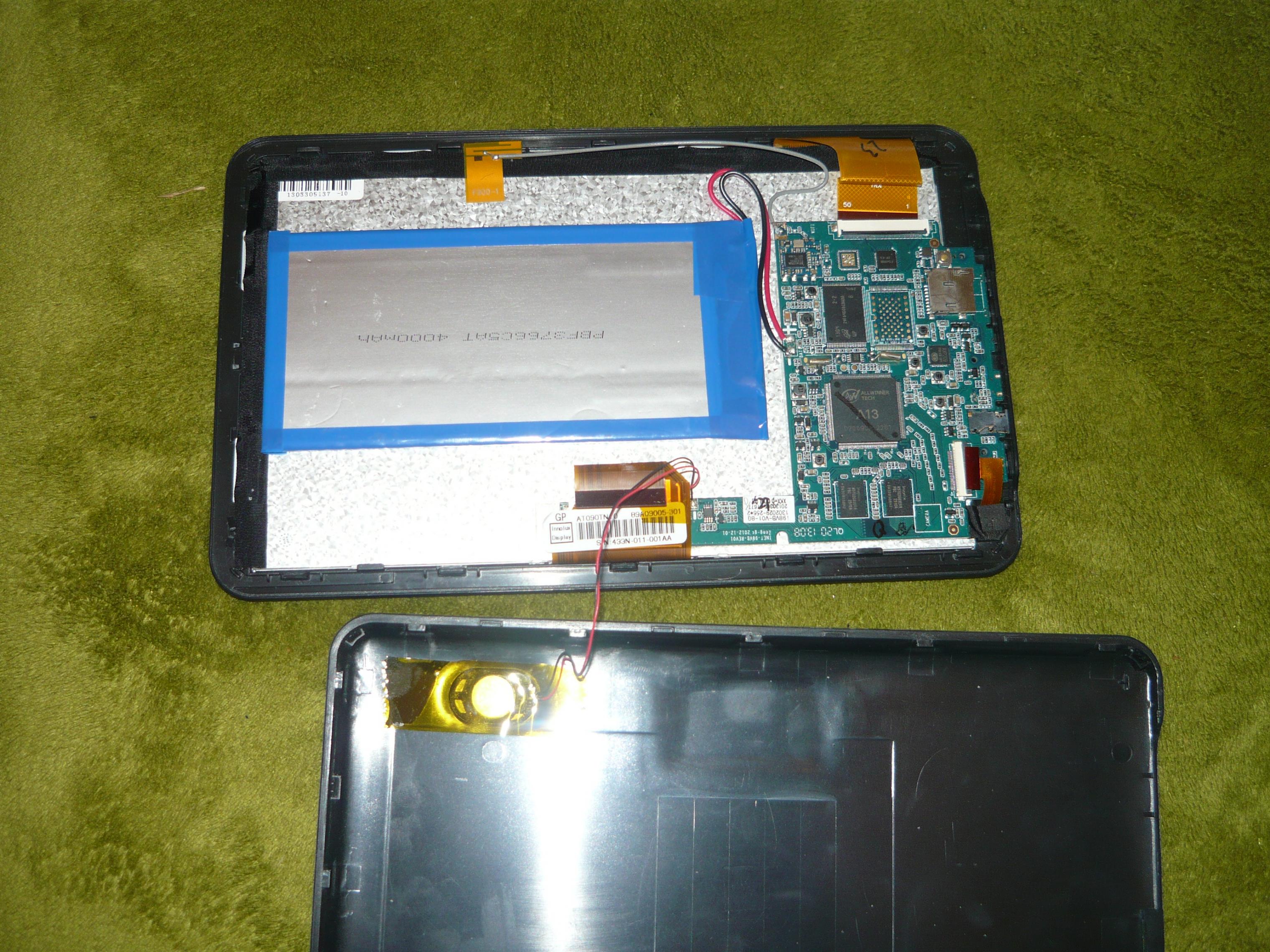

I have a 9,8in tablet with no usb jack inside, removed because it broke and it was unusable.
I have stripped the end of a USB cable and now have in front the wires that compose the cable, can i charge somehow the tablet without the mini usb port?

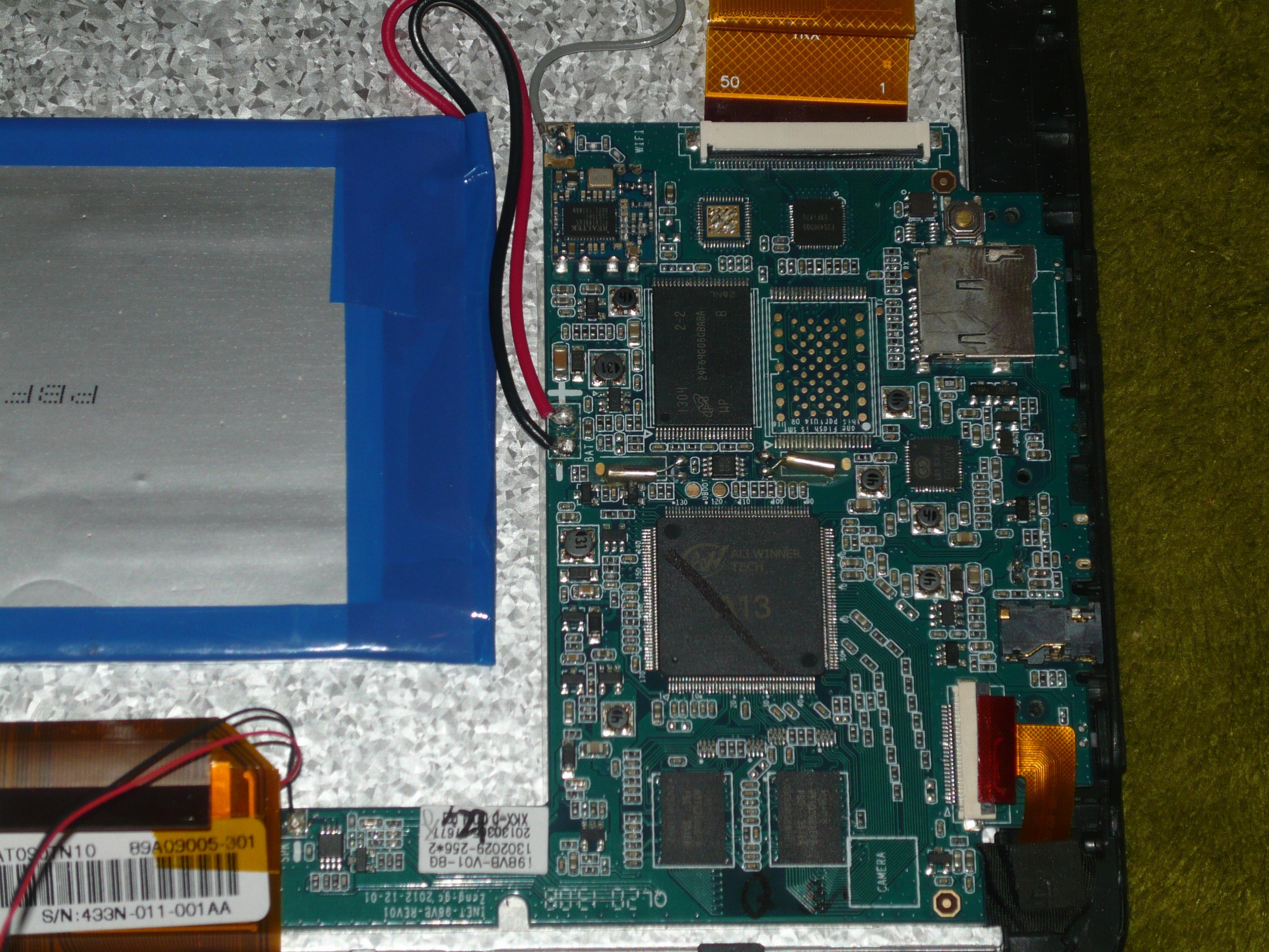

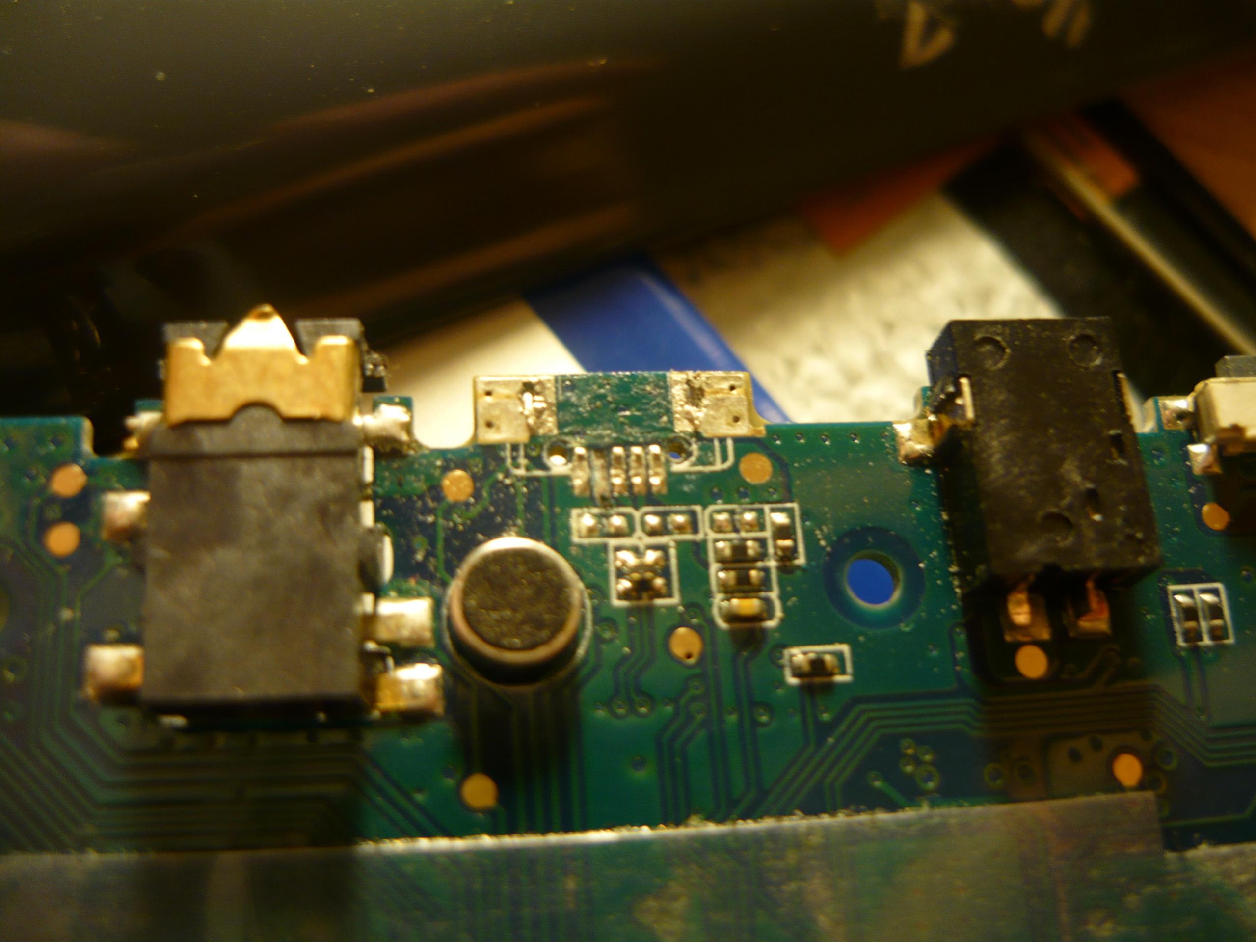

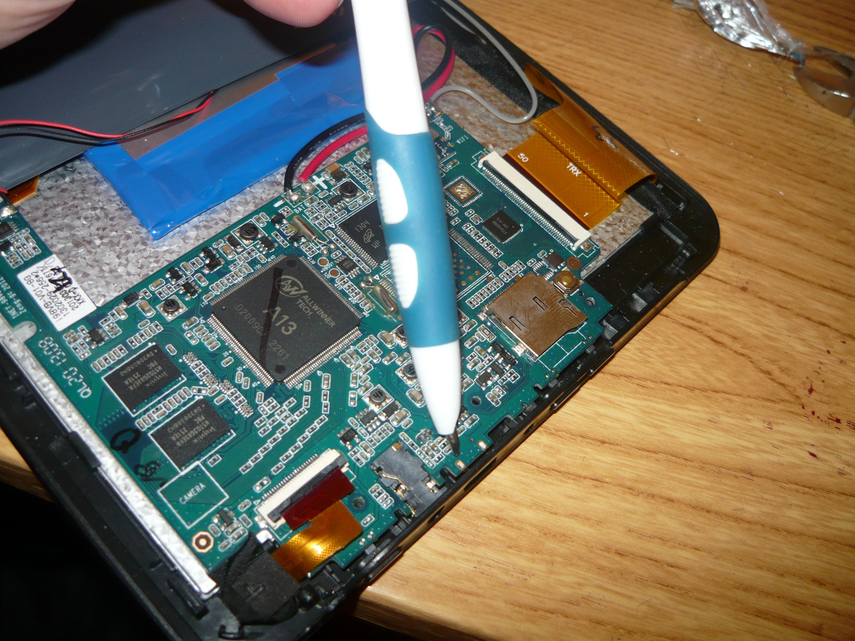

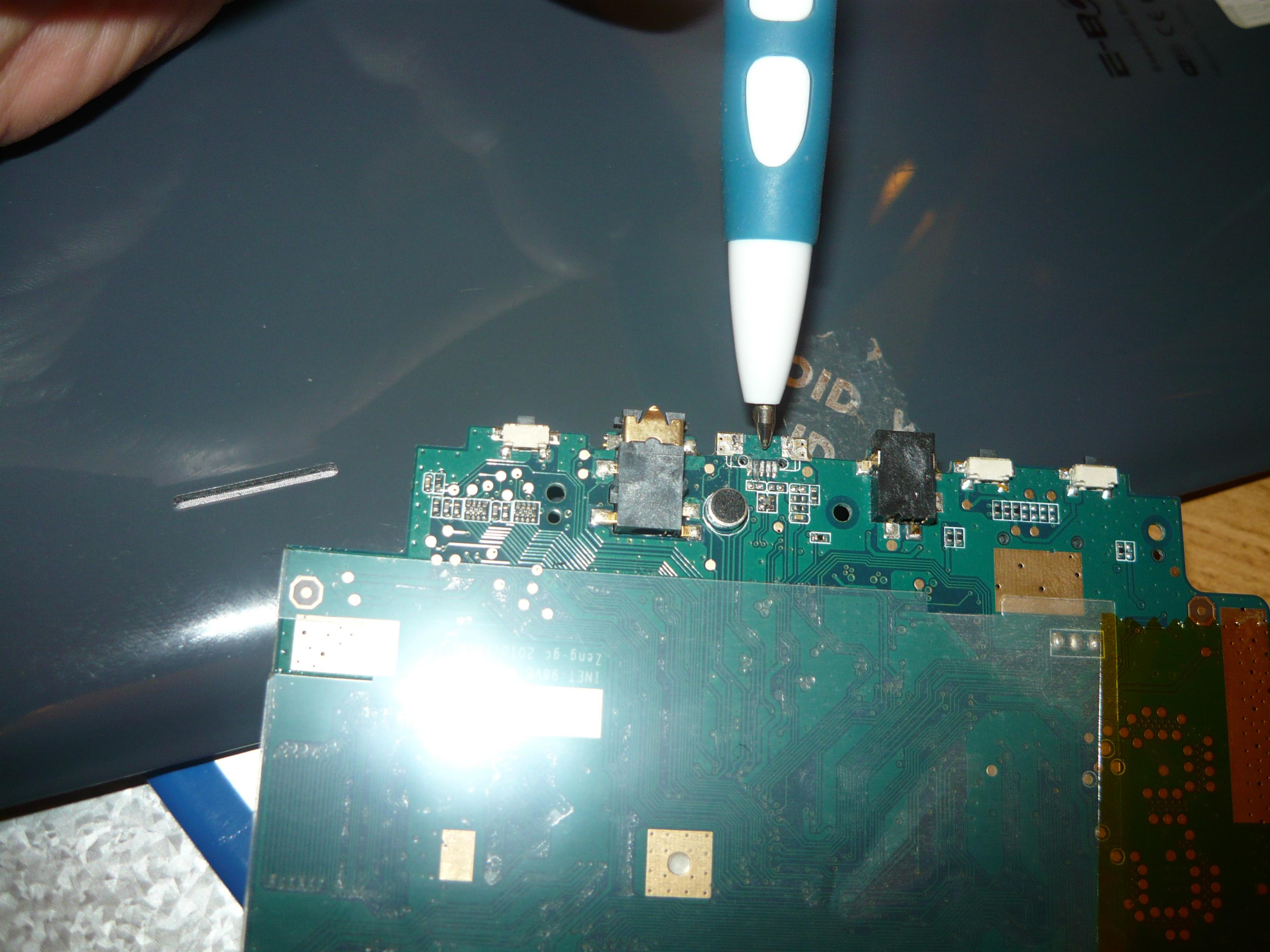

Are there any contact points inside where I can solder two wires that would further pass to a conector that I will connect the usb cable with a compatible connector at it's end?
Here are some pics of the usb port emplacement where it is to be put in place! It looks to me that pin 2 shows some exfoliation! Do I need that pin, is it the 5 Vpin? I am asking because i have several 5v adapters with amperages from 85 to 450mamp! IF I could fit two thin wires that were used for very fine works(that I have at hand) and a female plug at the end than I could charge the tablet by fitting a male plug to it every time that would be soldered to the wire of the charger delivering the curent necesary to charge the thing! Thank you!
Hi oszkar.
Right... so its broken/missing. As far as I can tell the 5 volts input is on the two outer connections. As best as I can (because they are so small) I measured continuity on my Acers tablet charging lead from outer USB pins (which are the 5 volt) to the outer two pins on the tiny tablet USB plug. You should be able to determine which is negative on the tablet just by measuring continuity to other obvious grounds.

No, you mustn't connect to the battery directly. That would destroy the battery and there would be real safety risks to. All of the charging circuitry is on the tablets main PCB. All you need to do is apply 5 volts from a sufficiently high enough rated PSU to the micro USB port.

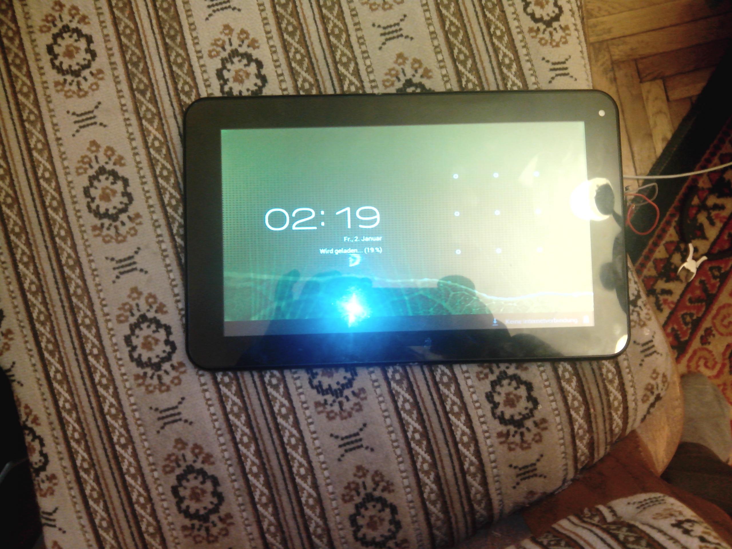

Thanks, problem solved, I have soldered on the marginal pins right and left tho wires + and - and connected it to + and - , red and black of the wires contained in the sleeve of the wire that composes the USB cable! Works very good! Thread closed!
