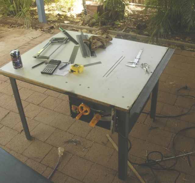

I have a very, very cheap table saw. I fitted it with a decent 10 inch 40t blade.
I made a table with scrap Melamine MDF and scrap steel. it is exactly the same height as my outdoor dining table so I can rip up large materials. (and it provides 2 extra place settings with extra guests)
I temporarily screwed the legless table saw from underneath with the blade guard and riving knife removed.
then switched it on, and wound the blade up through the table at 90 and 45 degrees and back down again.
then I moved the table saw forwards, and refitted the riving knife and bolted the saw in place with countersunk screws.
I wound the blade up through the table twice, at 90 and 45.
the steel at the end has been set square by measuring from the tungsten blade tips (those facing that way) with great care and welded in place.
I set the fence by measuring from the square end. My fence is another piece of steel angle iron and two pairs of locking pliers.
a large pair of vernier calipers is very handy for this. I have the offsets written on the table, I set and lock the calipers and push the fence into place with the calipers.
After this picture I made a sliding square with a piece of wood, a piece of steel flat bar and a few countersunk wood screws. I secured it with one screw, wet assembled it with liquid nails, squared it up then put the other three screws in after the glue had set. it is within 0.5 degrees.
the sliding square runs in a slot cut in the table with a router. I fill the slot with an identical piece of flat bar when the sliding square is not in use.
this picture is from before I made the sliding square.
If I started again I would leave more space in front of the blade.
the saw cost about $100 on special. if you bought all of the materials to make this it shouldn't cost more than the saw did in the first place.
