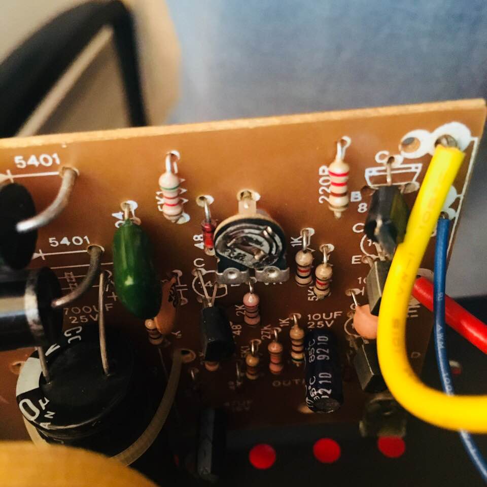

I opened the regulated 13.8V PSU and it seems (maybe someone can confirm?) that I can actually dial the output DC voltage from a little pot on the regulator board. If someone can confirm to me that it is the case, and I just need to turn it until I reach the needed voltage (I would lower it to 13.2V in this case, just to be safe), it would be great. Here's a picture of the "pot":

You can with a high probability operate your TA2024 at 13.8V and it will work for years. But, it seems that the small trim-potentiometer allows you to adjust the output voltage down to 13.2V and you will hardly notice any loss in performance. I would stay below the operational maximum limit.
Do the adjustment with a dummy load.

Yes that's how I felt those ratings were. Thanks for clarifying 🙂 I will lower the output to 13,2V.
