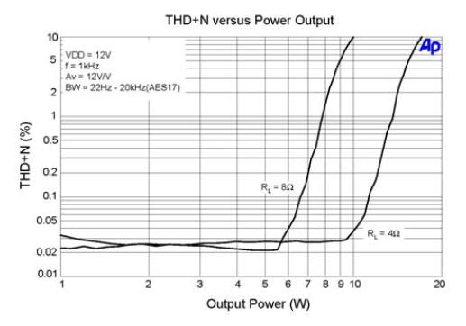

If you look at the Tripath TA2024 distortion vs. power graph, the 4 ohm curve shows that output goes up to about 10-11 watts before objectionably distorting. The 8 ohm curve shows that the power is almost halved to about 6 watts. I also verified that my TA2024-powered amp and my 88dB, 4 ohm two-way monitors were well capable of filling up my moderate size living room and my listening room with plenty of sound. A good power supply can make a significant difference in the overall sound quality.
i agree ta2024 is more than enough power for my even 83 db diy speaker. plenty of power to shake the room.
That only 1khz, tell you nothing, but lighter load more distortion, strange. You have THD Vs Frq sweep with step power or group delay? Maybe it not so good?
