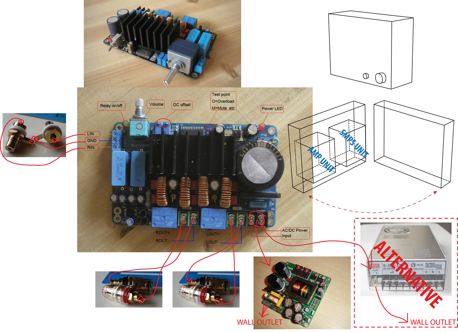

Ahh, thanks for the responses guys! 🙂 Unfortunately, I kind of thought that would be the answer. Well, then it only becomes exciting, putting my own amp together 🙂
@ JoeDJ: That's exactly my situation as well. I haven't had a amplifier at my place for a couple of years now, due to size and mobility (I've been travelling and moving a lot). Now it's time to get some quality gear in the apartment 🙂
@ Kjeldsen: I've been looking at the Connexelectronic website earlier, but only for smps - didn't know they made amps with integrated smps as well. Does this mean you only have to add a wire connecting this thing to a wall outlet of 230 volt?
Thanks for the offer, that would be really nice.
Alternatively, I was actually looking at Hifimediy units earlier, but got a little turned off, by my lack of knowledge on how to connect the various parts. I don't know how to connect the smps, what kind of potentiometer to order or how to "ground" the case (if that's necessary at all).
I have access to some tools, that will allow me to build a nice casing in wood (that's my aim so far), so I've got that part covered fairly well.
The sketch attached is what I was thinking of doing. Buy Hifimediy TK2050 amp, mount wires and attach smps, put in casing. Do you think I underestimated the "easyness" of it, or is it too difficult for a "newbie"?

I don't recommend wood for the inside of the box because of possible malfunction and the burning (literally) amplifier.
I have insisted on building everything myself to save some dollars, but I must admit that with the knowledge I have today I would skip the DIY on amps and concentrate on speakers instead.
