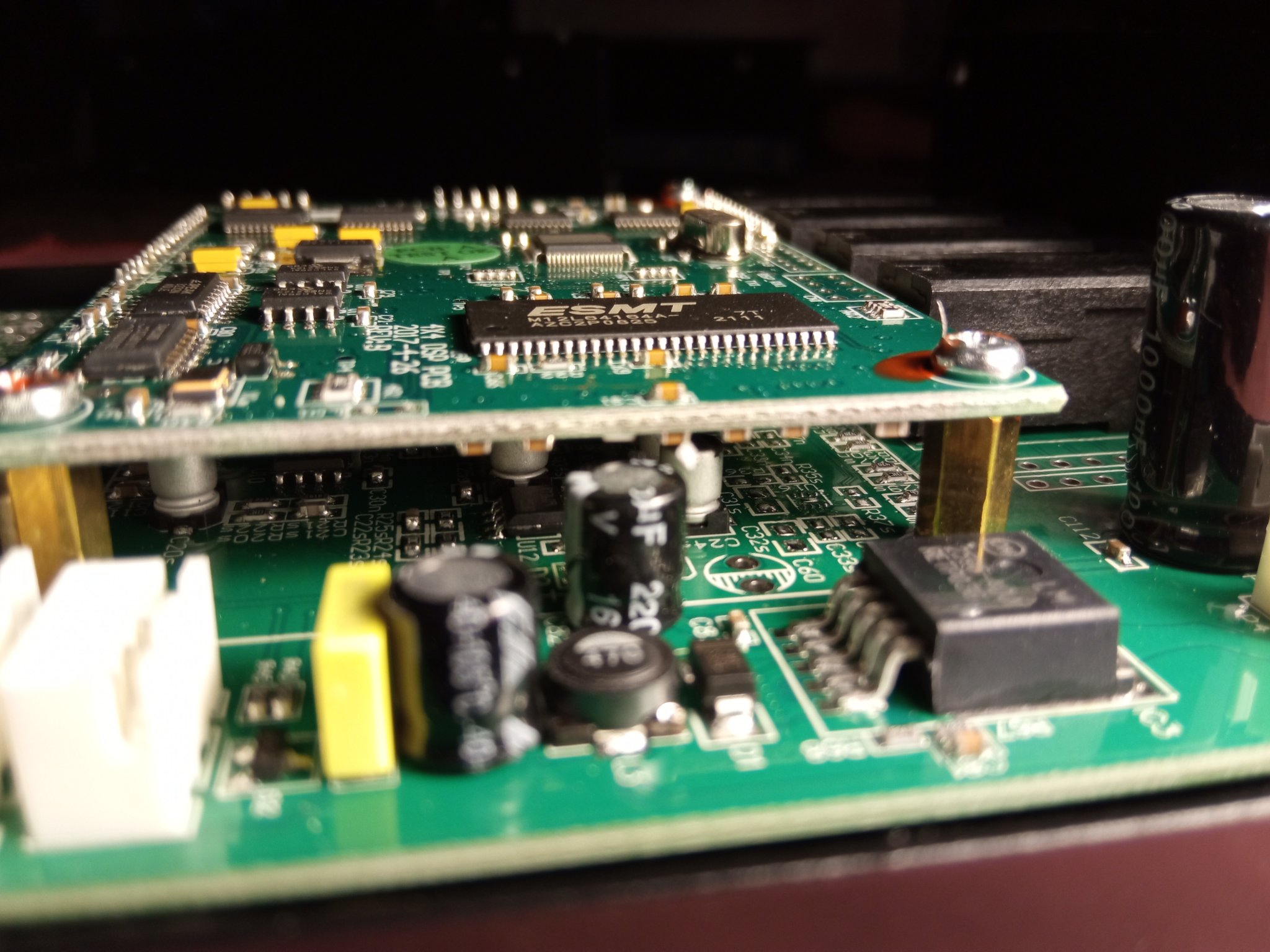

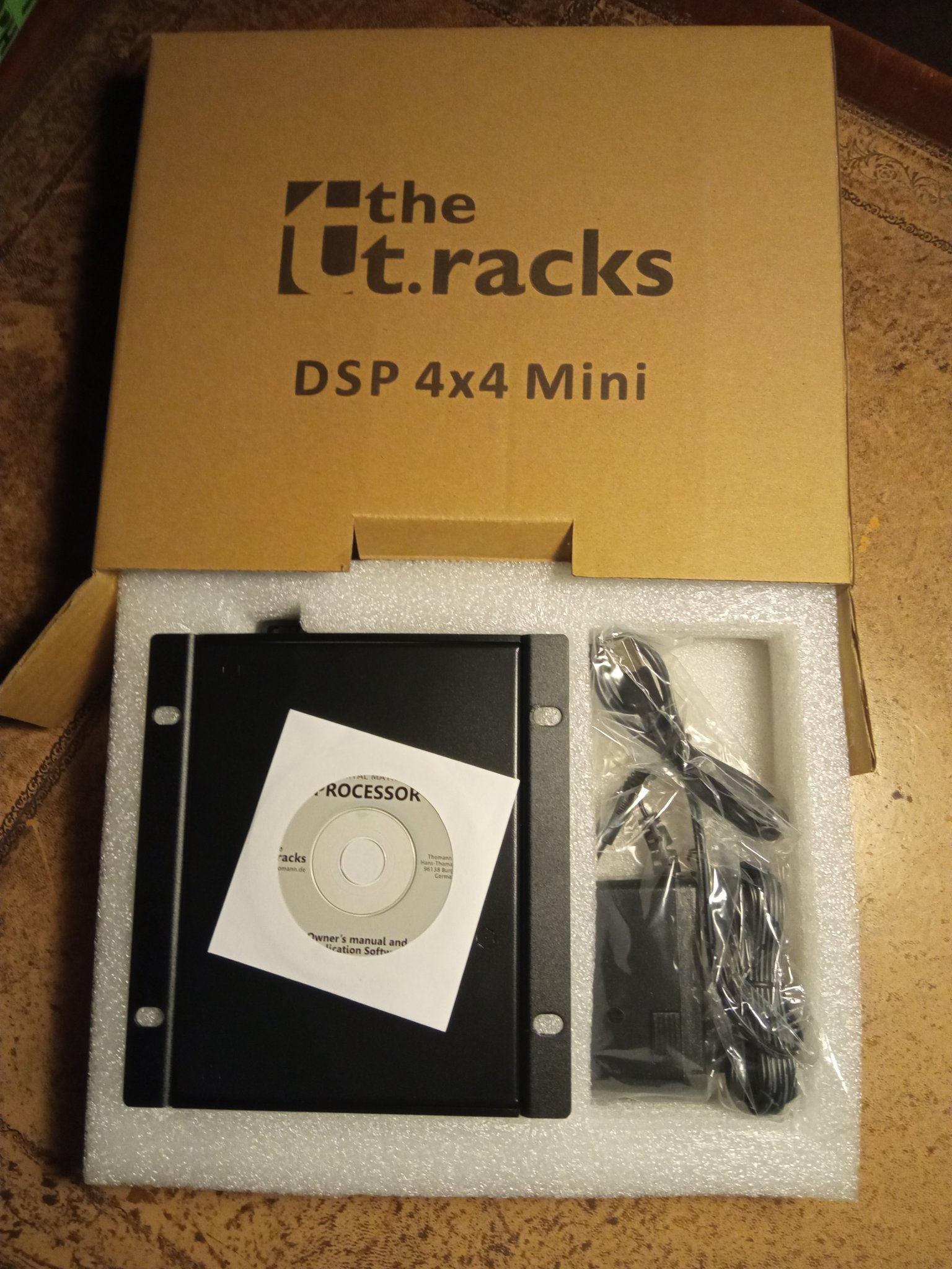

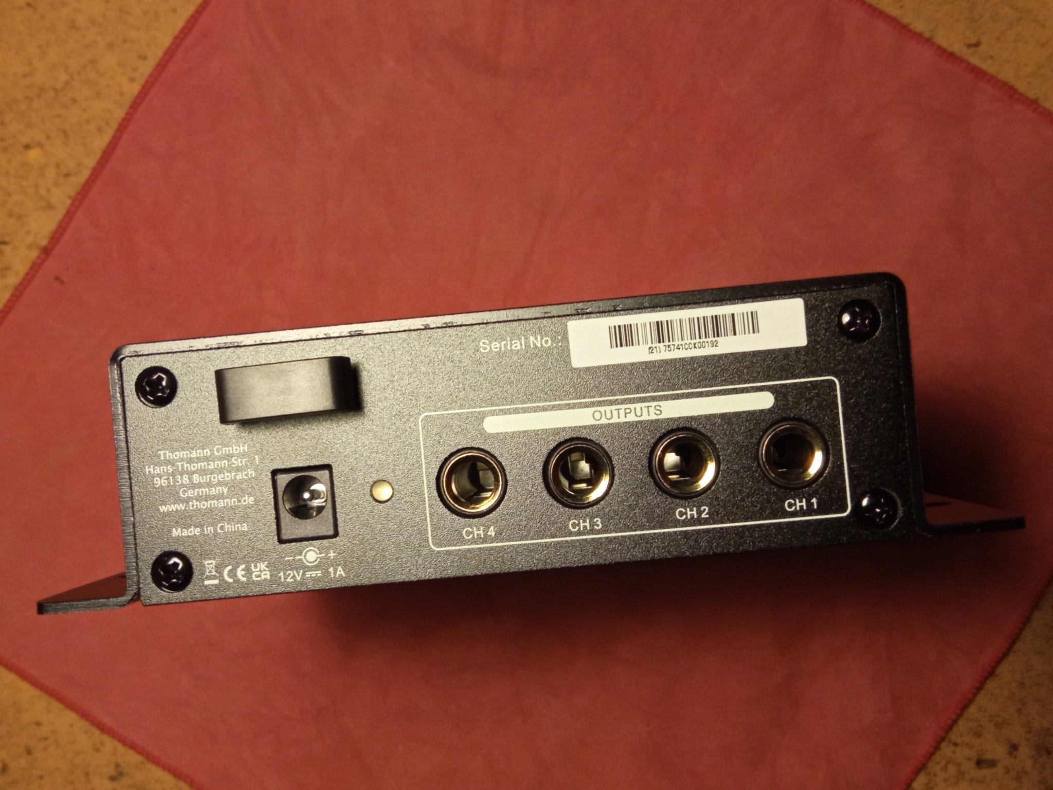

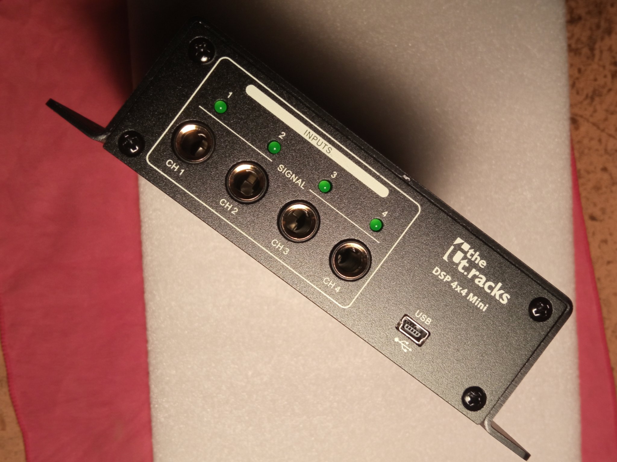

I just received my "Thomann T.racks 4x4 Mini DSP".
These sell in Germany and most of Europe for €119 inc. P&P.
For those frustrated by ADAU 1701 boards like the Sure/Wondom or miniDSP, this may be the thing to get what they expected from a low cost DSP.
By the way, I have some of the DSP boards that need Sigma Studio.
The T.racks 4x4 Mini DSP comes with a Windows software and plugs into USB. No messing around with Cypress interfaces and Sigma Studio Software (which is great if you like mighty, complicated things). just what you would expect from Plug&Play.
The software has all you may need for an active speaker, 2.1 setup or even a small PA system. For the last one IMO it is a must have.
To show you what you get for such littlel money, I made a bunch of pictures. Quite some value compared to others.
The case is steel and aluminum, seems close to indestructable.

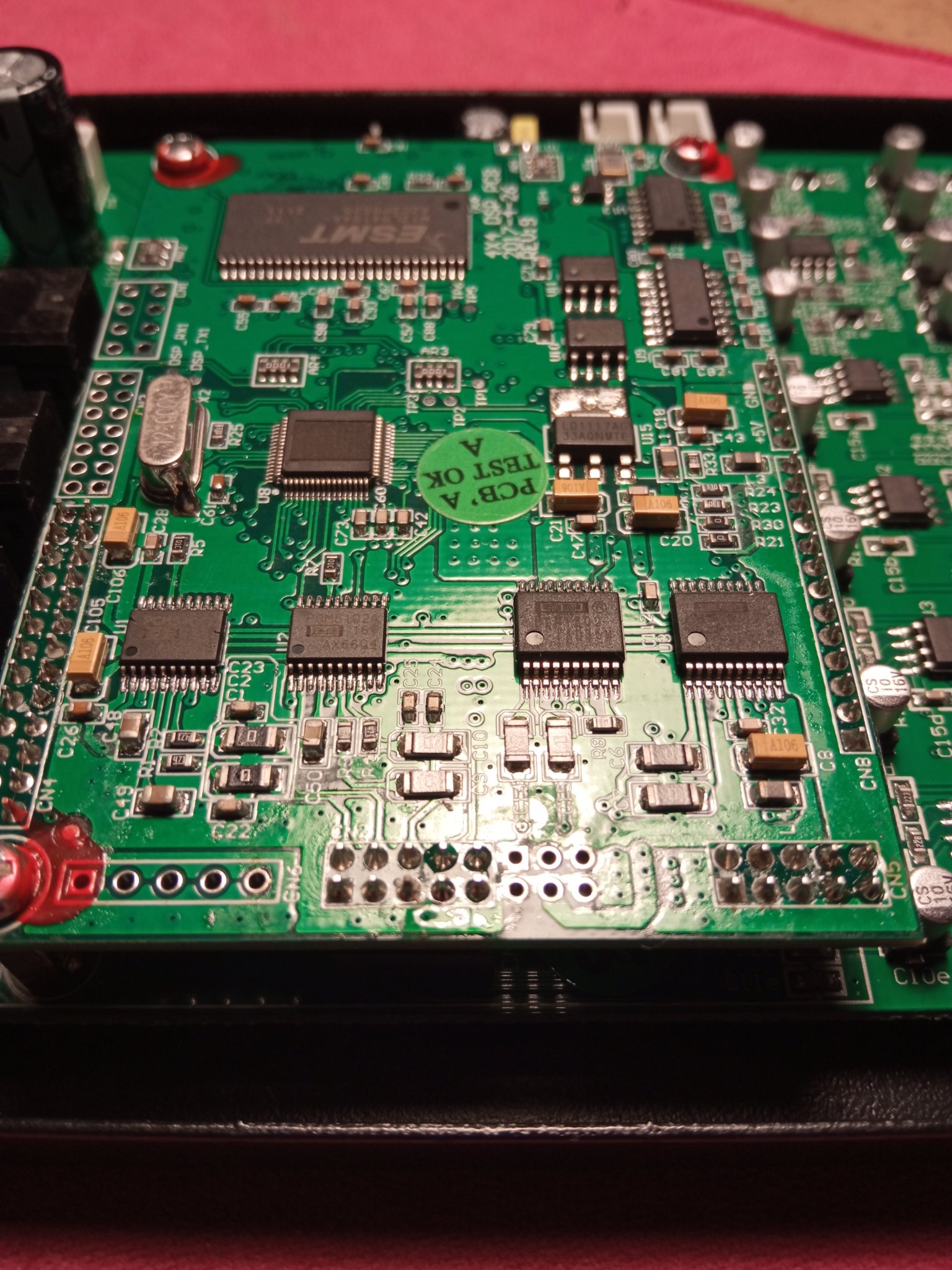

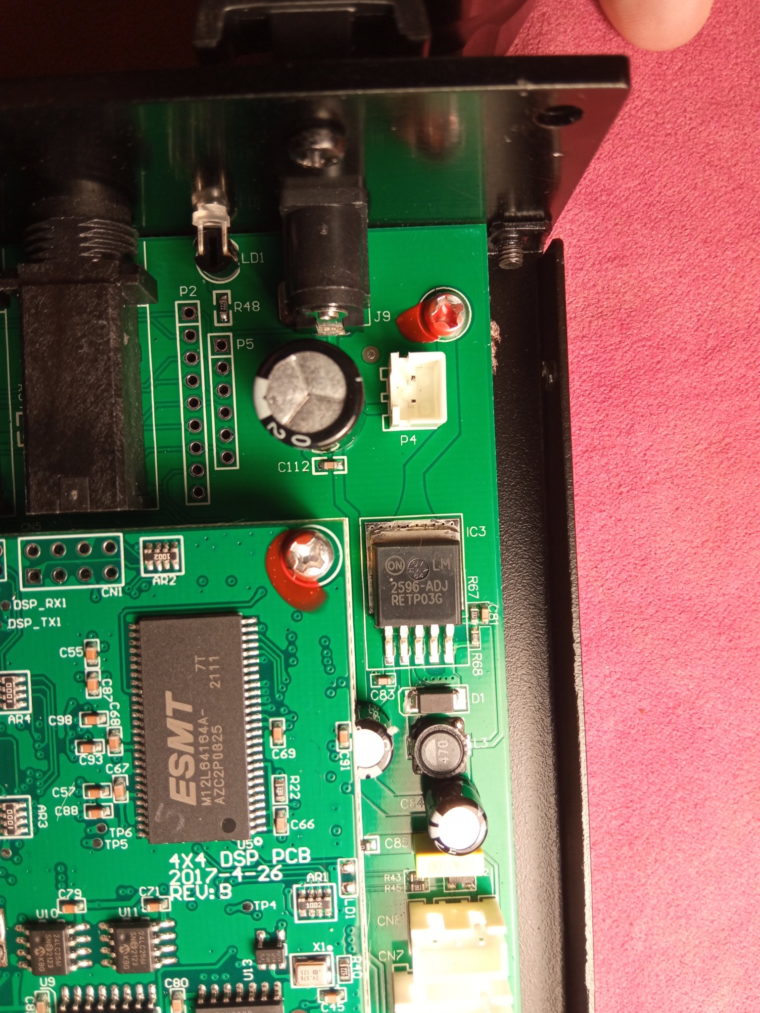

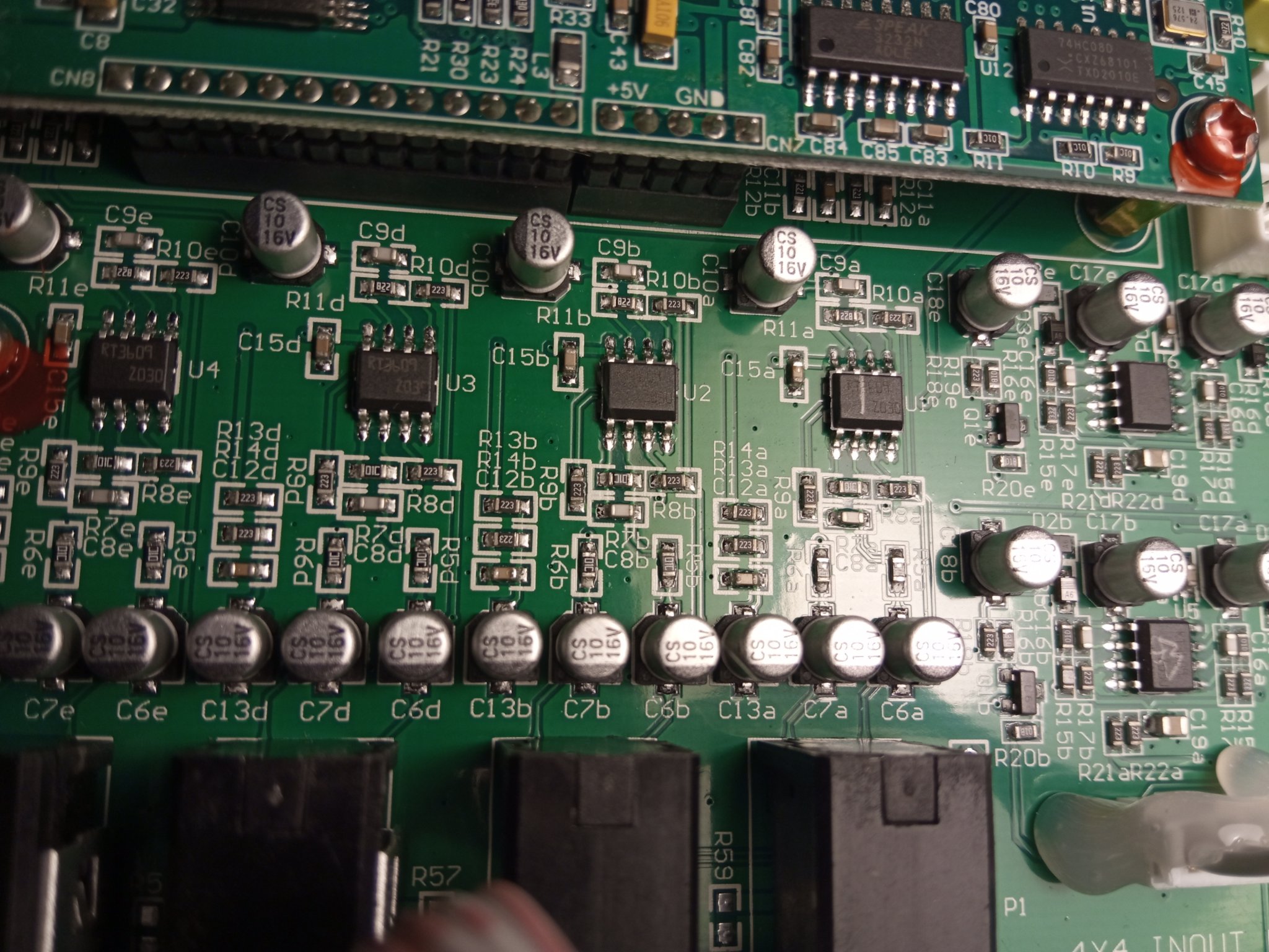

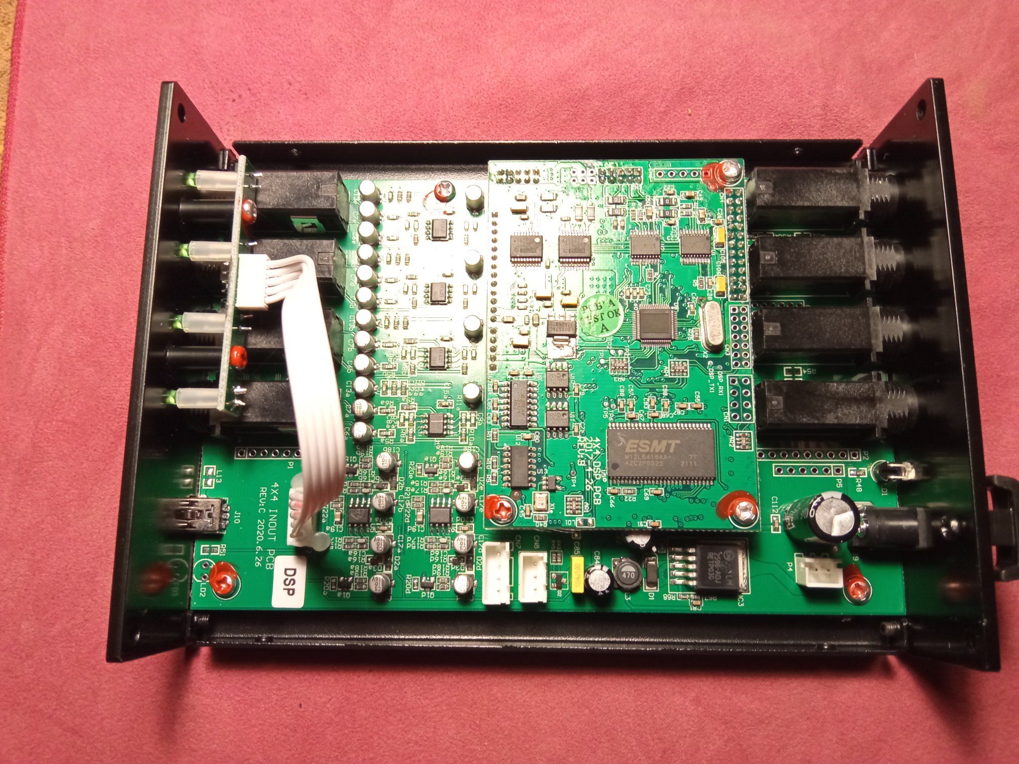

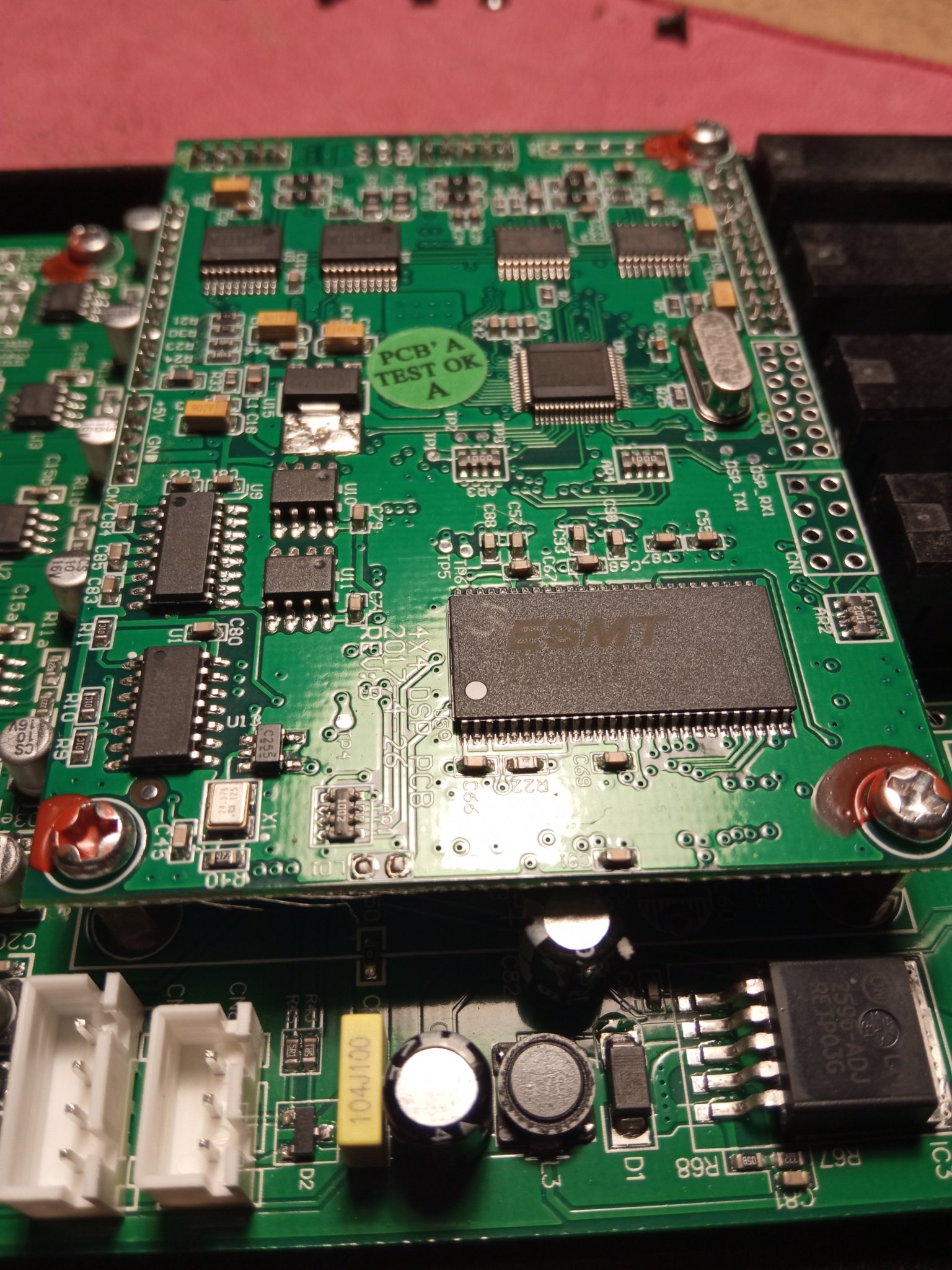

Seem to use 2 x PCM5102A as DACs and PCM1802 as ADCs
Not sure about the DSP at all. If I can count it is a 64 package ... does not seem to be an AD device. The big ESMT chip is a 1M x 16 bit x 4 Banks SDRAM ...... ....
Is there markings on the DSP?
The funny noises at turn on/off is a bit strange as it is not that difficult to get the PCM5102A to stay quiet because of it's muting and anti pop circuits. But if they use buffers after the DAC, then this of course goes away .... is it ballanced out? .... then they for sure have to uses unbal to bal amps/buffers, which probably do not incorporate an good enough muting circuit .. it seems
What is suppose to be the DSP (64 legs chip on top) has it's markings removed professionally. The performance is like an ADAU1701.
I did not remove the stacked PCB, maybe there is more on the inside.
It may be something like an ADSP-BF592, would match the DACs and ADCs around it. At 3$ not too expensive.
I made these pictures, mainly to show how overpriced DSP boards like the Sure/ Wondom DSP are. This product gives you real value for your cash.
The outputs are balanced too, there seem to be some un/bal buffers. The "RT3609" IC I think is used for it, is from a Chinese company that does not hand out data of its components. It seems to be a large scale copy production, which allows Chinese producers to get around common TI parts, avoiding license fees. As anything in China is about...
