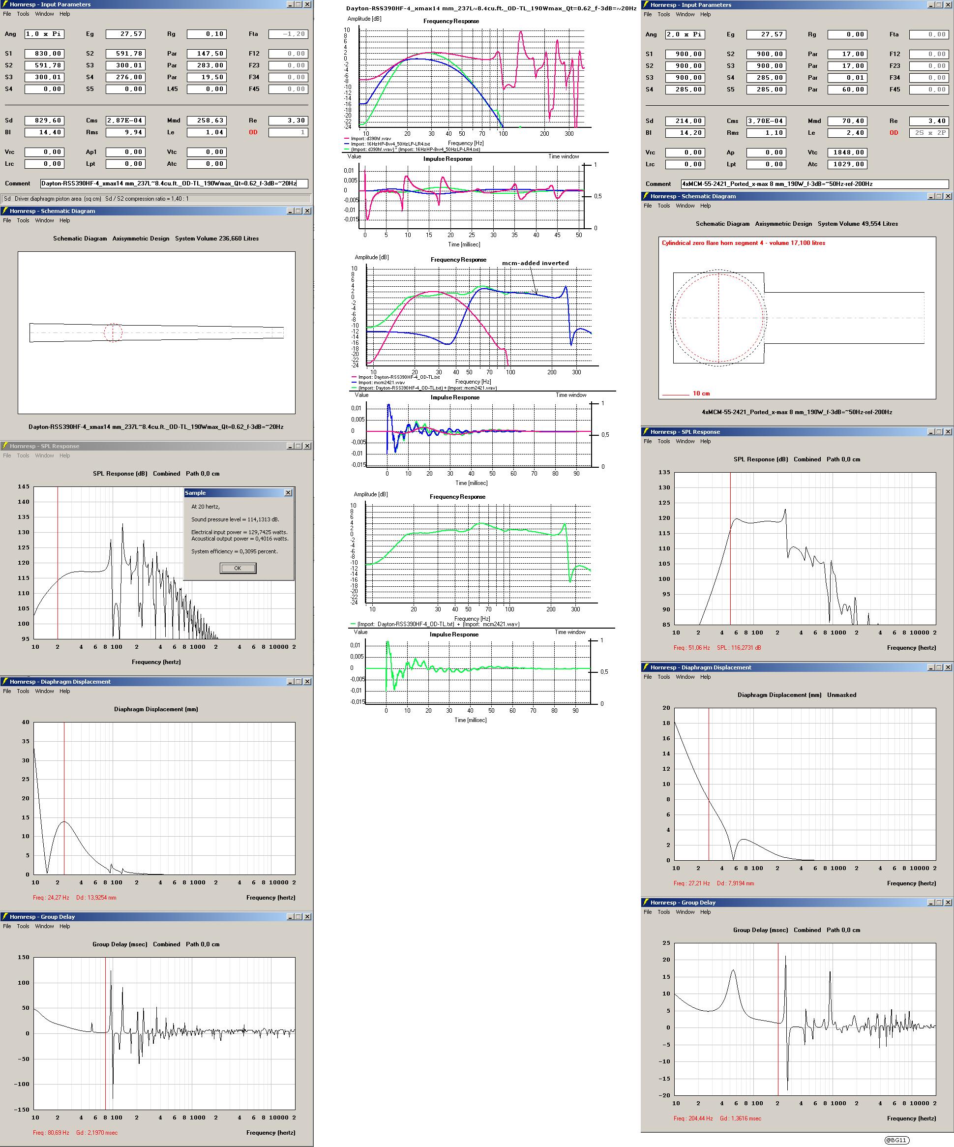

Man thats a lot of data!! Makes me feel like a novice all over again...
I appreciate the effort you put in and I want to get the most out of it, so would you mind explaining to me what some of it is? I can see you plugged in the info for each driver and stuff but what do the graphs down the sides mean? If I understand correctly the single line graph in the middle with a green line is the final frequency response with both subs??

Quite right. The Dayton driver is first HP and LP filtered at 16 Hz-Bw4 and at 50 Hz-LR4, then summed with the unfiltered MCM Top-box showed in green color.
Note: The in reality FR above ~100 Hz would be as flat as the eventual manufacturers graph, if advertised.
In HR Le can be set to 0.01 mH in order to circumvent the influence of the driver 2.4 mH inductance and as both boxes should be at least partly lined (or stuffed with damping materials):
The expected FR:s would then be summed more flatter from ~20 Hz to above 200Hz than seen in the plot.
IMO,Another good idea (not shown in the submitted simulations) is to XO the TL at ~60 Hz(LR4 LP) to the 4 MCM's(1Hz-safe) in a ~0.9 cu.ft closed box(Qtc=~0.5_f-6dB=~59 Hz).

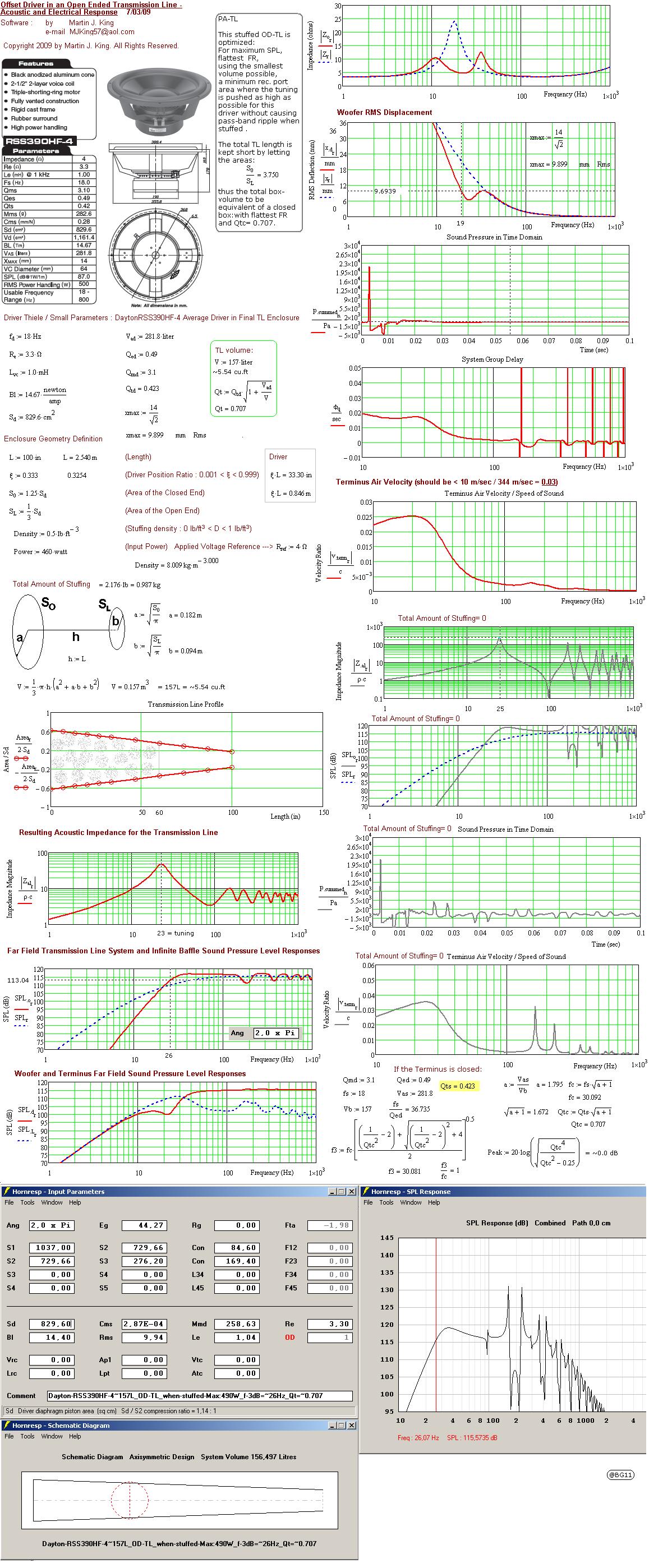

Both HR Hornresponse and HOLMimpulse are very good free down-loadable programs, read the Help files,look for tutorials on the Net.
Hornresponse can be used in TL simulations of OD(Offset Driver) configurations where it's important no notice that the effects of eventual inserted damping materials are not shown in the plots.

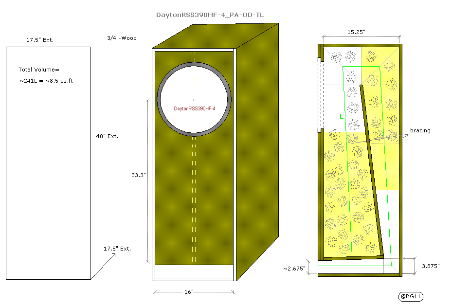

IMO:Your options are to design TL:s using enclosure volumes between 157L(~5.54cu.ft_Qt=~0.71) and 237L(8.4 cu.ft_Qt=~0.62).
The tuning would be below fs for the larger box but above fs for the smaller and below fc(=f-3dB) for an optimal closed box where diminishing returns would soon be reached and if surpassed would not contribute to either the FR smoothness or SQ.
The smaller TL is also more sensitive to distance misalignments, in particular to the suggested Driver offset than the larger one is,but for the latter:
If deviating less than a couple of inches off correct offset:
The occurring effects like (FR peaking) can easily be counteracted by partly tweak(increase-decrease) the damping material density at certain locations (Note: Maintain the weight of Stuffing).
This method doesn't solve the situation for the smaller TL that can only successfully be tamed to FR flatness by inserting additional damping material, best if placed near the Terminus.
The Drawback is that the entire in-band FR would be attenuated too.

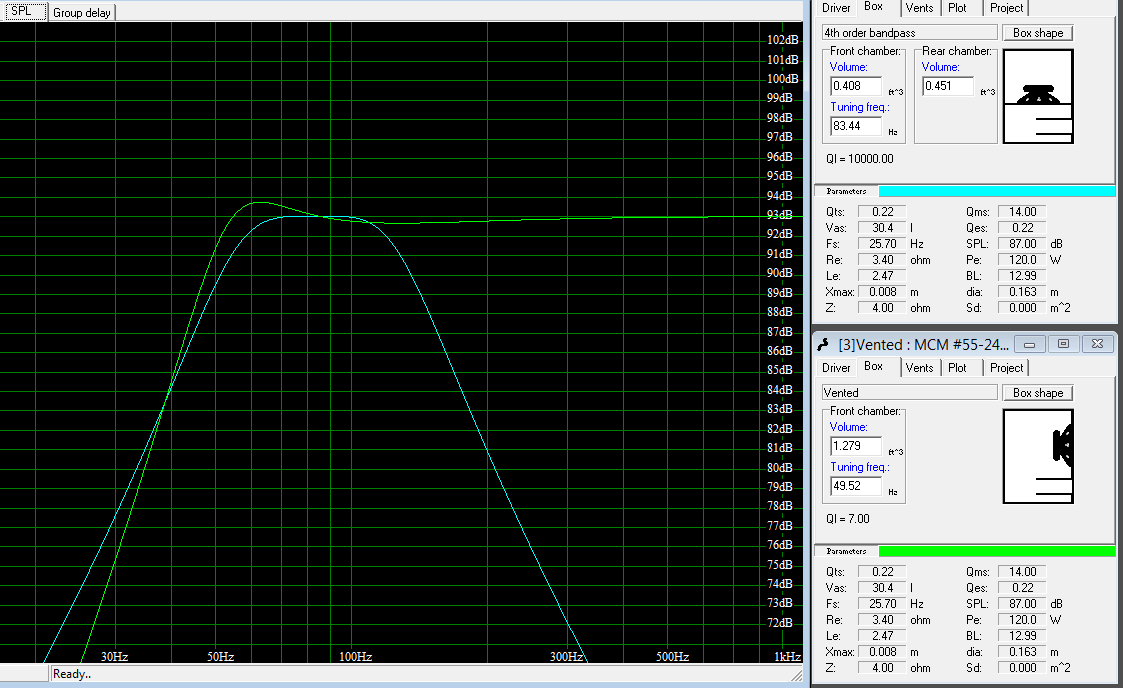

The simulations for the MCM:s suggests a slot-ported BR that would work well using a ~50Hz XO as previously shown but can be substituted with a closed design that only integrates best at ~60 Hz.

Adding a simple sketch showing one possibility for a small TL enclosure:

That T-Line for the Dayton looks great and that is probably the design I will go with. Ill have to look up a bit more about stuffing because besides lining the inside of a few vented boxes with fiberglass I an pretty new to the idea. Any suggested readings or advice?
As for the MCMs I will take your recommendation as to what you think I should do... When I plugged them into WinISD for a 4th Order Bandpass and a Vented Box I got the results in the attached photo. Not sure if these look similar to what you are getting?

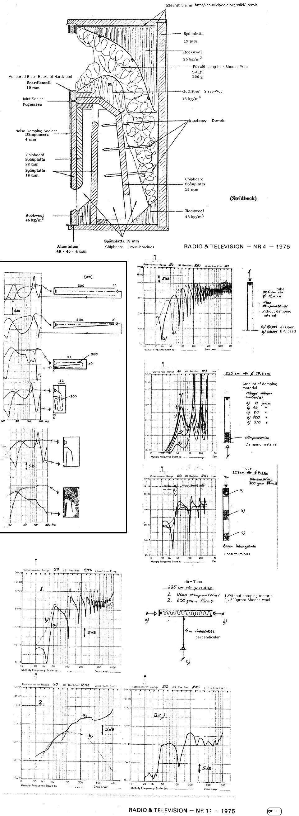

Submitting a picture that can be studied in detail considering TL foldings and impact of different placements of stuffing:
