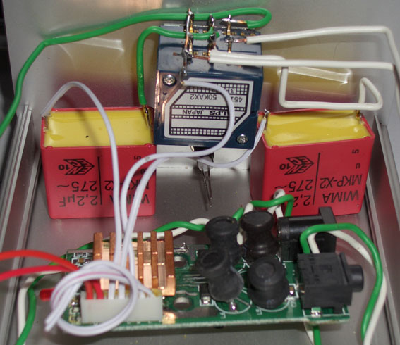

Well, did the stealth mod and put the t-amp in another case. The only problem: nothing coming out. No music, no hiss, no squeal, no nothing.
Power seems ok (light comes on, chip warms up)
C3 and C4 bridges seem ok.
Any idea where to look and what to check for?
Thanks.........

Did you replace the stock SI volume control?
If so, make sure that you wire the VR exactly as shown in the diagram. Insure that the last two wires coming from the board to the VR are not conencted if you replaced the VR.
If these wires are connected to the new VR as grounds - you will be shorting the input to ground. Thus no sound. Check the comnnections to your VR closely.

Yes, I did replace the pot with an Alps. Forgot to mention this earlier.
And yes, the two last wires of the ribbon cable (opposite end to the switch wires) are not connected to anything. Right now, they are just hanging in the air.
Any more ideas?
Any more ideas?

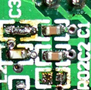

Looking at your photo it is possible that your cap bridges are not good. With the amp on, touch each bridge with the tip of your finger. Do you get a hum or buzz in the speakers?
If you can not get your fingers in there, use a small bit of bare wire. The idea is to couple the noise picked up by your body into the circuit.
panomaniac said:Looking at your photo it is possible that your cap bridges are not good.
I found it far easier to bridge the cap gaps with a bit of tinned wire; just hold in place with a knife edge and touch with the iron.

thanks guys. Here are the answers.....
Can't get any noise out of it at all, touching with a poined metal pin before or after C3
Yes....
cheks about 0 Ohms
checks about 0 Ohms
left + right channel identical:
RCA input(+) to speaker(+): 52.8kOhm
RCA input(+) to speaker(-): infinity
RCA input(-) to speaker(+): 16.7kOhm
RCA input(-) to speaker(-): infinity
additional checks (for whatever they are worth):
after input caps to before R1/R2 (checks the bridges): 1 Ohm each (so bridges are ok)
speaker(+) left to speaker(-) left: infinity (right channel identical)
RCA(+) left to RCA(-) left: 49.5kOhm (right channel the same)
The above checks were obviously done with the amp switched off
I replaced them with 0.1uF MKPs
Any other ideas?

Well I think it's time for an overall picture of the setup and maybe some close-ups.... can't hurt!
Dont worry about it being tidy, my first attempts were awful!

As Lee says, maybe pictures will help us.
Or you may have to find an oscilloscope. Maybe the chip is not running - it happens.
