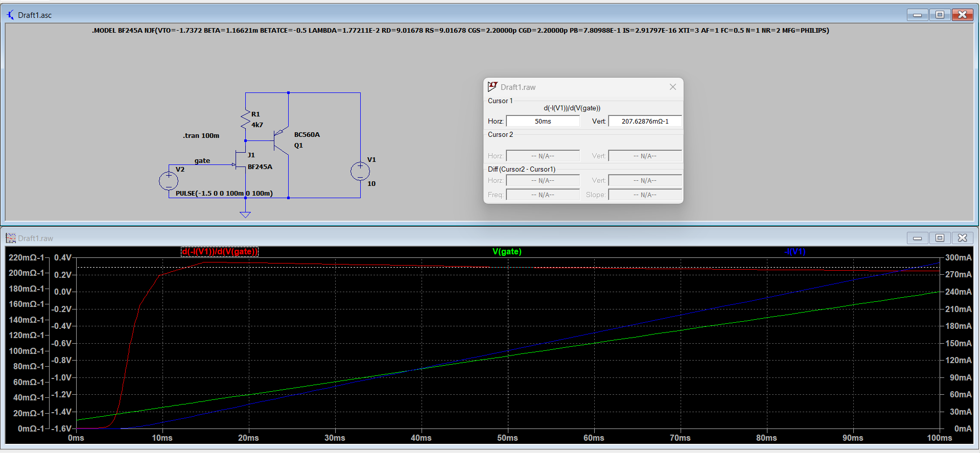

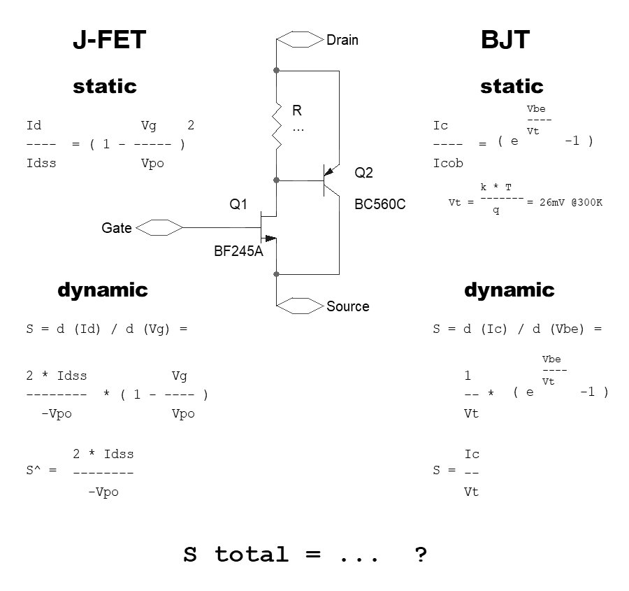

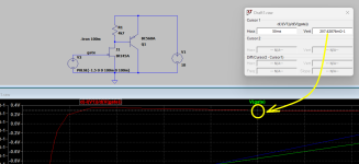

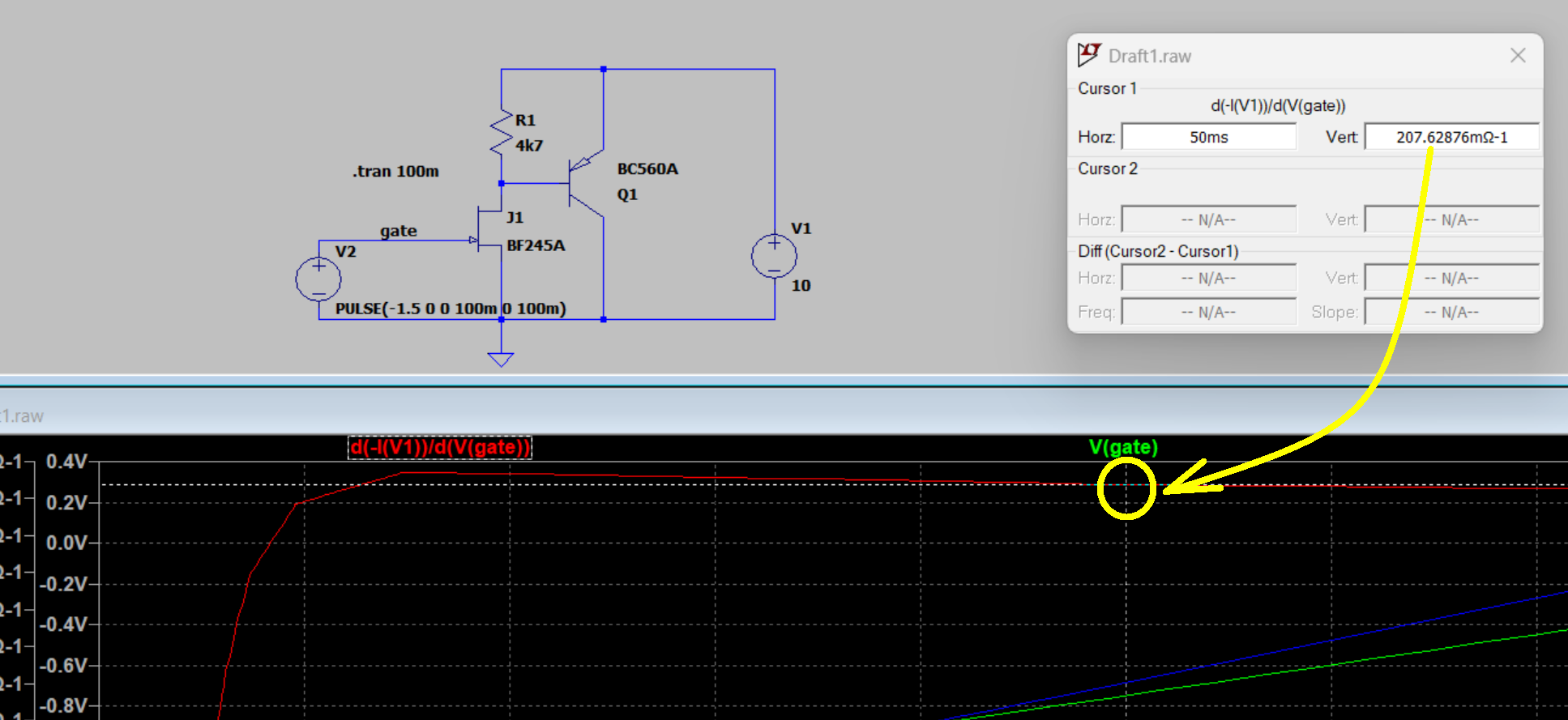

Gave away my Horowitz & Hill to my nephew (somesort of my clone actually), I'm stuck into how to calculate the final compound transconductance of a Sziklai pair consisting of a J-fet and a BJT. Any clue upward pointed appreciated.

perhaps calculate the dynamic input resistance R_π of the bjt as
R_π = β / g_m_bjt
then the dynamic resistive load on the jfet is
R_load = R || R_π
Then the voltage gain of the jfet stage is
A_jfet = g_m_jfet • R_load
So the total transconductance is
g_m_sziklai = A_jfet • g_m_bjt
(I denote by g_m what you denoted as S)
Does this work ?
I learned (many years ago...) that this is a SuperFET, so the transconductance is simply: S = gmxBeta, where gm is the transconductance of the JFET (for the drain current in use) and Beta is the current gain for the transistor (at the used collector current).

It's interesting is that this circuit is not very useful below about 10mA total current. It could be if the resistor was larger, but then the speed of the BJT is compromised. I chose 4k7 to be as large as I felt was useful for audio applications. Operating the FET at half Idss would require a resistor about 330 Ohms. It's interesting that the combination seems to be noticeably more linear than the FET alone.
