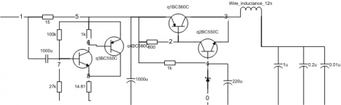

It has been hinted at least by Elso Kwak that you could use a Sziklai pair emitter follower as stabilizer.
Is this a common practice? Quick simulations indicate that there is a bit lower output impedance at the cost of a few dB worse PSRR at the high end.
Circuit:
Circuit:
Lower output Z compared to what? I would expect it to be one or two orders of magnitude better than the single emitter follower.
Lower PSRR compared to what? This should be also (much) better. What are the resistor values? How did you define/measure the PSRR

R1-2 100ohm
R1-4 1k
It was merely to set up an example but you think trimming the values will help?
R1-4 1k
Hjelm,
Increasing R1-4 would help the PSRR as this is influenced by the ratio R1-4 and the zener dynamic impedance. Increasing R1-2 to say 1k would lower the Zout.
But final values can only bedetermined if you know the max load current, because that determines the Q-type for the pass element and the requirements for base current. But at any rate it should be a large improvement from a simple emitter follower.

Jan,
Thanks for the quick replies.
Tried increasing the R1-4 and got a broader dip in the PSRR but the maximum level was unchanged.
If i increased the R1-2 though the PSRR got worse at the high end and the output impedance decreased.
My quick conclusion is that there is,as always, a tradeoff.
Question is it seems worth doing since it is a simple change from the emitter follower why isn't it used more, is there a sonic problem with it? I see one nice feature in the output impedance which seems to be in the 300mohm range and constant in the audio band for these small signal transistors.

Yes, there always is a trade-off, as with everything in life.
How do you test the PSRR? Where/what is the input, what the measuring point?
It IS done often, like in using an integrated regulator like the 317 series with an external pass xsistor. Same concept.

Jan,
I do not know if it is correct but i did a AC sweep at 1 (input) and read it out at three (output) and and did a 20*log10(Voltage_ratio)
I am not that experienced with spice but intuitively i thought it should say something.

Improved this a bit as i thought the PSRR was the major problem with this circuit as a stabilizer.
I found the shunt that was described on this page, finesse voltage regulator, very useful to remove incoming voltage variations.
I modified it to use a Sziklai pair, i like the configuration.
I then needed to modify the resistor at the emitter to achieve optmal rejection.
The final circuit i simulated looks like this.

Yes, that's correct, although it is a small-signal simulation, which may be a bit optimistic. But it's a good indication.
Jan Didden
The capacitors are modelled with ESR and estimated inductance.
With these i extended the frequency before the output impedance started to rise.
I got quite nice figures for the PSRR (i think at least).
When is it good enough?
The application is firstly to decouple a opamp but i think it would work for a DAC as well.
Does anyone have any opinions on criteria for a good supply for a DAC and opamp respectively, or is there no free lunch.

The output impedance is resistive from 10Hz to 500kHz and i get a THD of 0.42% if i load the circuit with 20mA and a 1mA sinus on top, read that linearity might be an important factor in a PSU.
I have also experimented with the shunt to remove the zener noise and it can give a 100dB improvement.
Comments?

Those graphs are not bad. Did you try to increase the 600 ohms (if I read it correctly) on node 2? That would increase the gain of the compound pair and should at least in theory further lower Zout.

I have in the first setup but that would be sort of a optimisation. I do not know exactly what to aim for in this case. I thought it was "low enough" but sure it can be done.
Retried it and quick tests indicate that the 600 is rather optimal.
It got worse when i increased it and when i lowered it.
I am at ~200mohm output impedance throughout the audio band.

The 100dB improvement is most certainly due to simulation or measurement artifacts. That kind of attenuation will not be realised in practise.
I think you are again getting close to the point to decide whether you want substantial improvements, like sub-1-milli-ohm Zout and go to a real regulator (with feedback) or stay with the emitter follower that you have now. I don't think that there is much more to gain except some tweaking as you noted.
Jan Didden
Sorry, didn't see your post above while I was typing. Talk about concurrent engineering...!
I think you're doing fine.
