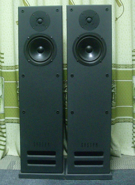

Hai
I really need help to sort out crossover design for TL design that I got older Systemdek systym 937 TL speaker. As I got the speaker without crossover.Please find the below details as it looks similar to PMC fb1
Woofer -
SEAS CB17RCY is a 6.5"
Tweeter -
SEAS H519 25TFFC - 25mm
Cabinet
(width X height X depth): 225 � 915 � 255mm weight ( approx ) : 20KG one
Woofer -
Tweeter -
Cabinet
I can see there is original manufacturer datasheet on these drivers, you have got the enclosures, baffle measures are known, simulation software is free (response modeler to model baffle step, fprawn labs to trace the curves, XSim to model filter networks). Perhaps you can do it yourself.
