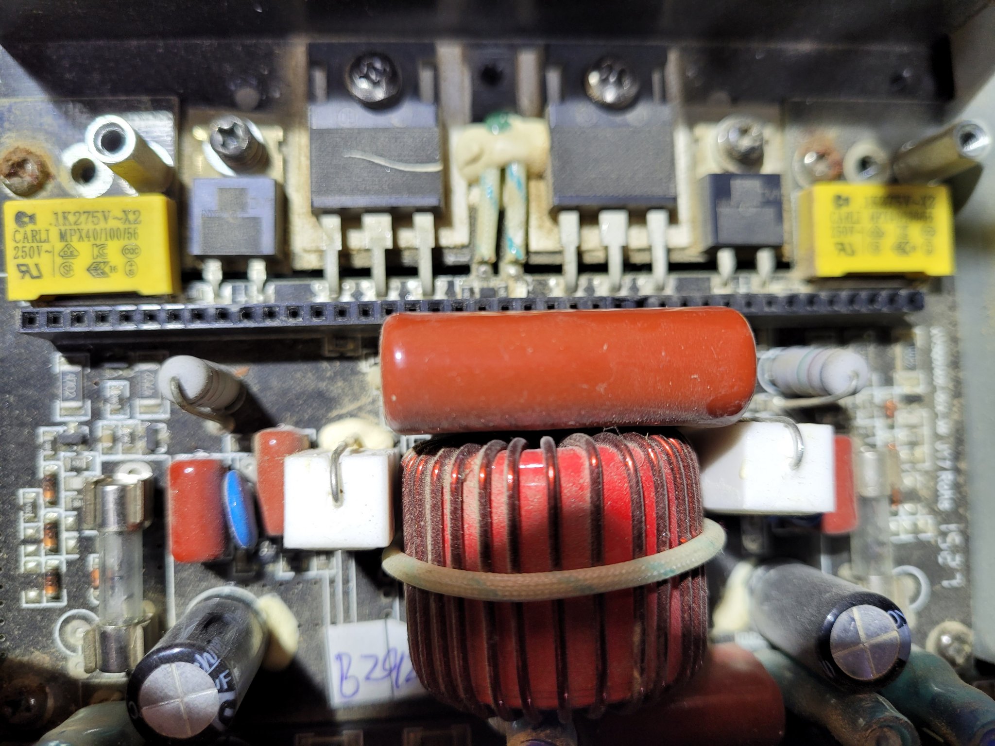

Hello. I have this amp from years ago and it has always worked fine but a few days ago the left channel did not work and it damaged my column. I could smell burning. I have opened it and it has two blown fuses on the amp board.
I have checked the two transistors and they are shorted but it does not let me see which transistor it is. It has the identification erased. That is why I need the service manual to identify those components

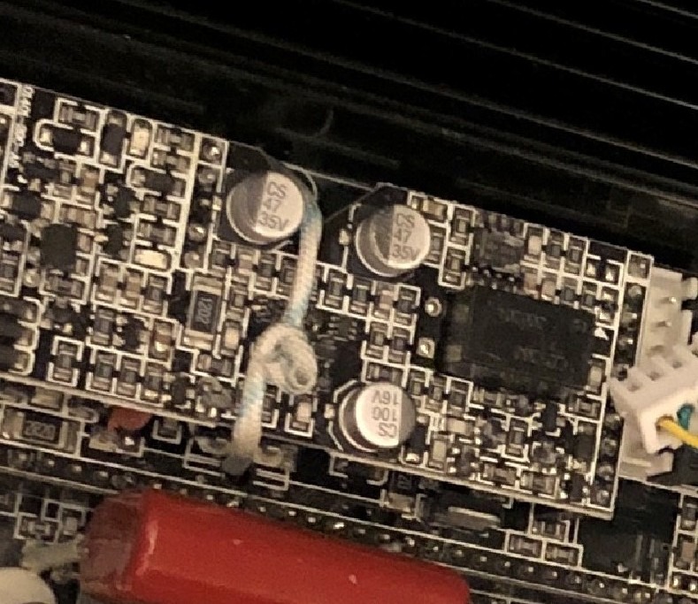

I've been looking at the schematics but they don't match the amplification board. Will there be several versions? I'll put some photos of the transistors

Ok, that of course makes it a bit easier. Still the output mosfet and flyback diodes are using internal code naming i.e. DYQ42 and DYE8, same goes for the driver chips; IC11,12 = DYIN.
As the rail voltage is 147V, the fets need to be at least 400V same for the diodes ... maybe you can find good alternatives that would work, but not that easy
My guess of IRFB4227PBF is for sure wrong 😉
I would start removing / replacing the active parts in the output section, measuring the parts as they come out to see how far back the damage is done

One thought, is to desolder the ouput fet + diodes, then put in new fuses. Turn it on and see if there are suitable signals from the gate drivers.
If so I think you could maybe find some suitable replacements which from the other thread seems to be
Diodes: BYC8-600 PJA1827 D5 4163
Fets: K60N30 CE8P1Y
Some of the other active components in the output part might also be fried ....
