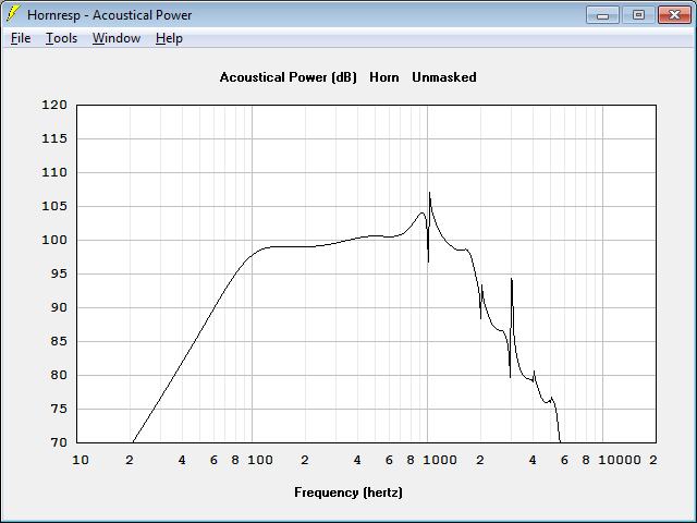

Using Bwaslo's SynCalc v5 excel sheet (thank you VERY much, Bill!) and Hornresp (many thanks David McBean!) I tried various designs. Having done the Synergy calculations before and having learned from various pitfalls doing my first Synergy Horn, the process proceeded a LOT faster this second time 😀. But despite my ferocious halve year studying, reading forums and collecting data BEFORE I even started simulating my first design, I had to go over the material once again to get a grasp of the main design aspects and focus points.
The 8FE200 seemed to simulate quite well right off the bat. I decided on a 90x60 horn. To keep a decent size I had to compromise on the lowest frequency at which horizontal pattern control could be kept. I decided on 500Hz. This resulted in a compact horn: 'Only' 49x32x20 cm. Soon my first proto saw the light. As you can see, I decided to 'cut corners'😀. Makes corner placement much easier 😉.

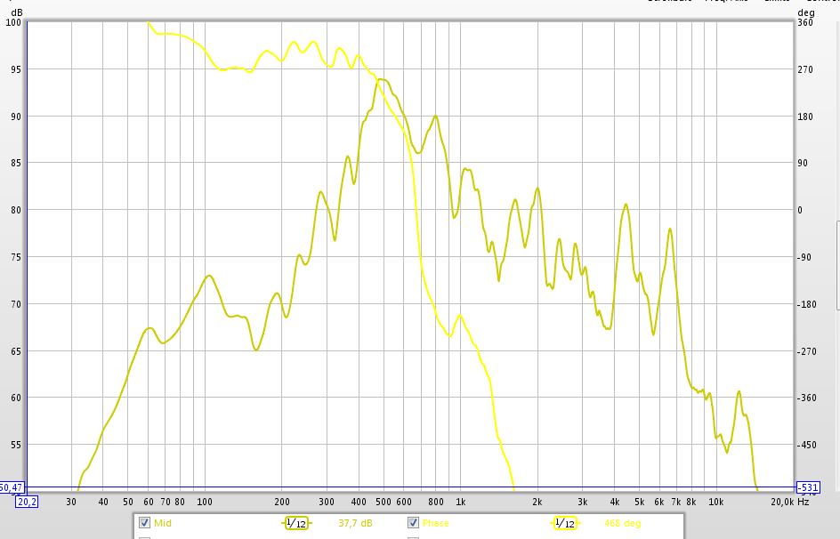

For measurements I used the excellent and free(!) Room Eq Wizard 5 from Hometheatershack (thanks a lot, John Mulcahy!). The yellow graph shows the woofers in an open back configuration (as seen in the picture), so the bottom end is lacking, but the top end is a correct representation of the final (closed) loudspeaker.

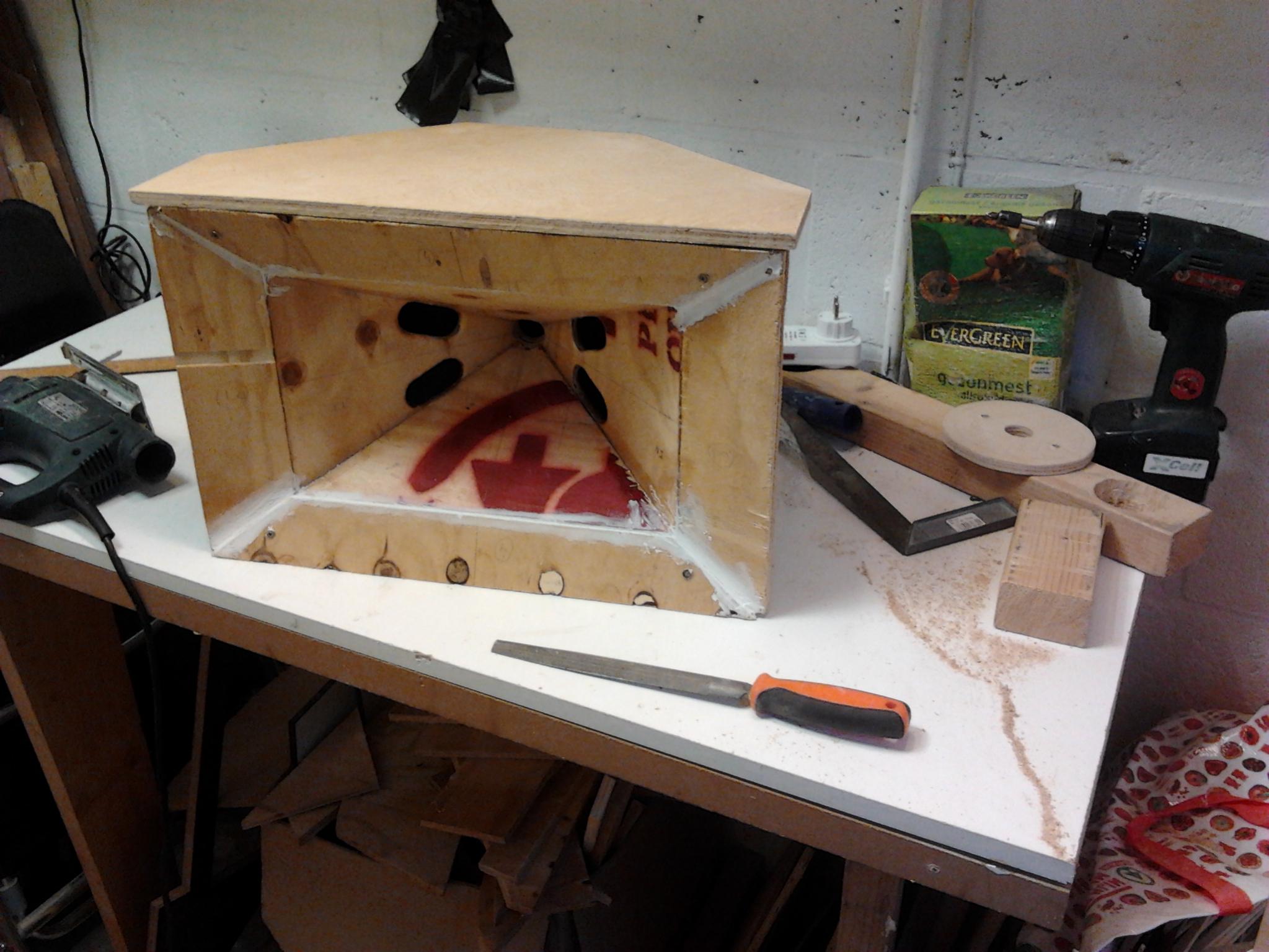

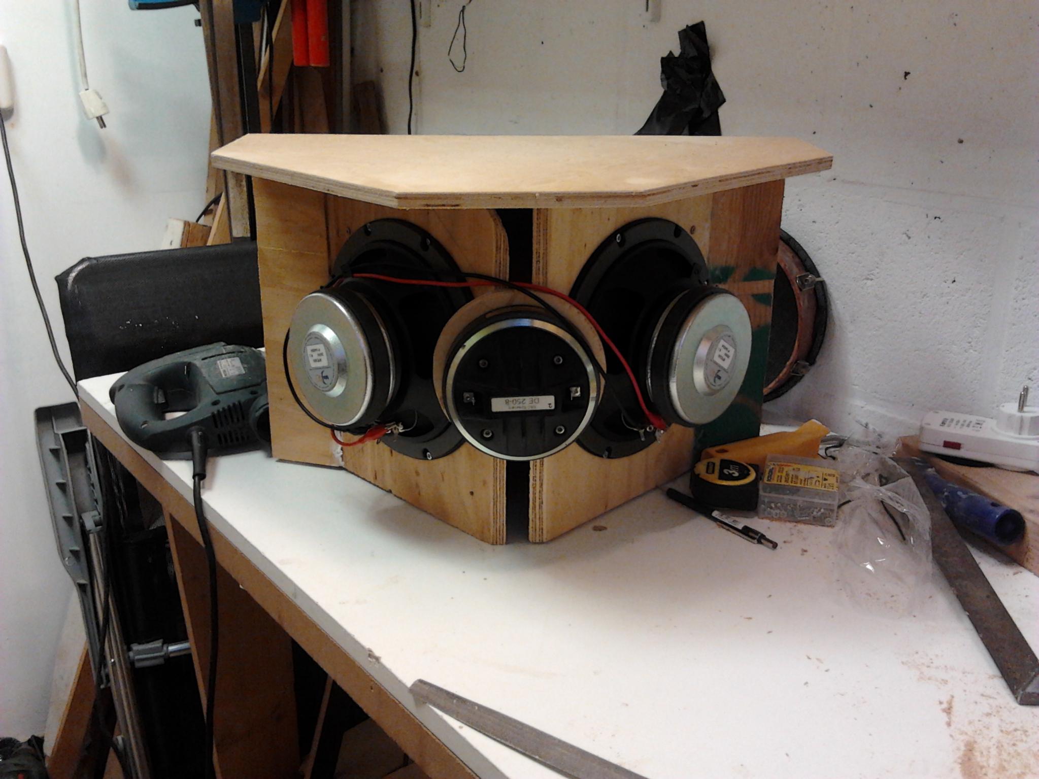

The 50 cm2 total mid tap holes seemed a bit much. So I decided to build a second proto with tap holes a quarter the size. Since those big taps showed no huffing signs AT ALL, I figured I could go smaller. And in case the taps were too small, I could always make them bigger quite easily. By the way, I kept to the golden ratio for the tap holes.
This one measured better. The green graph shows a closed speaker, woofers only (tweeter installed, but shorted), no EQ or crossover whatsoever (and not referenced to 2.83 volts).
Now these aren't exactly HiFi-like loudspeaker graphs, but the measurements proved that the woofer was usable from around 100 Hz to 1 kHz. With a little EQ and not too much SPL, even 70 Hz seems doable.

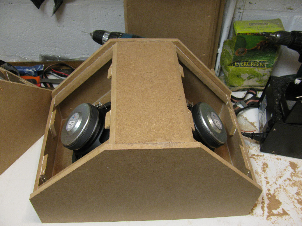

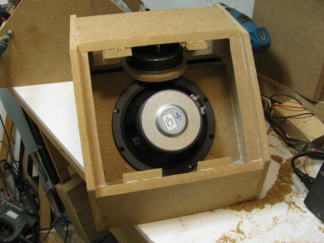

It's been long overdue that I posted an update... So here we go.Did you end this version and is there some update / latest development info you would like to share.
These are now my main left/right speakers in my living room. They are driven by a Denon AVR-4310. I did use its Audyssey room measurement system, but I like the sound better if it's deactivated. It sounds a little dull and processed when Audyssey is enabled.
Here's the SynCalc sheet (thank you Bill Waslo!):
You can find some documentation I used here: https://drive.google.com/open?id=0B85db-5ynA7wV0diWXZiQklSd0U.
They are bass reflex with two ports (not 4 like in the pics below; I tried modelling the vented chamber using WinISD, but that wasn't a success, had to close two up again; It was basically trial and error). The ports are made with standard 32mm diameter 45 degree PVC piping pieces. Angled, because otherwise they wouldn't fit.
I ended up doing a passive crossover:
I think 180 Hz is far too high for a sub. For the record, these 2-way Synergies easily go down to 100 Hz. In my living room they have a large bump at 60 Hz... And from my short 'loudness' tests the bottleneck is the compression driver, not the two 8FE200's, when HP'ed @100 Hz. 120 dB@1m is certainly doable.One thought I have is, make it go down to 180 Hz or so (bigger Horn but still not to big). 180 because that is a nice freq. to cross-over at considering using it for Live / band / P.A. purposes.
They sound fine and have the same kind of sound usually found in Synergy horns. Good imaging and a sound 'image' that is floating in front of you. But to be honest, my 3-way Synergies sound better. I suspect the BMS4550 driver to be more 'hifi'-ish, or maybe it's the additional mids that couple better in the horn... But my girlfriend once said that she had been spoiled by them, because when she hears music somewhere else almost all of the times she thinks it sounds worse than at home 😀.
I almost forgot to mention: my living room sub is a Bill Fitzmaurice Table Tuba, but when casually listening music it's not really missed if it is switched off. You're still listening to four 8" woofers after all...

Reg. A (S1):
Well, I disagree here, I'm afraid. Its not how its built, since everybody reams it to 5.06 cm2, but perhaps how its designed.
Trouble is: If you simulate/design with 5.06 cm2 throat you get A LOT different Hornresp data than Bill shows, and later documents by measurement.
So, something is still rotten....
