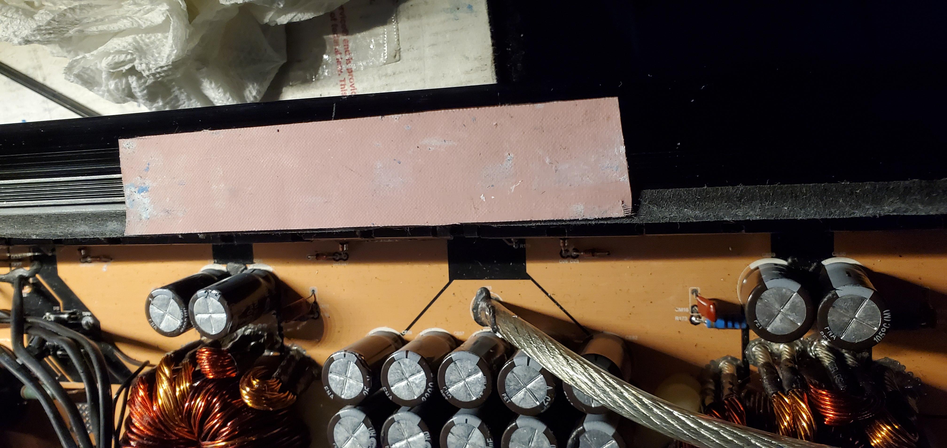

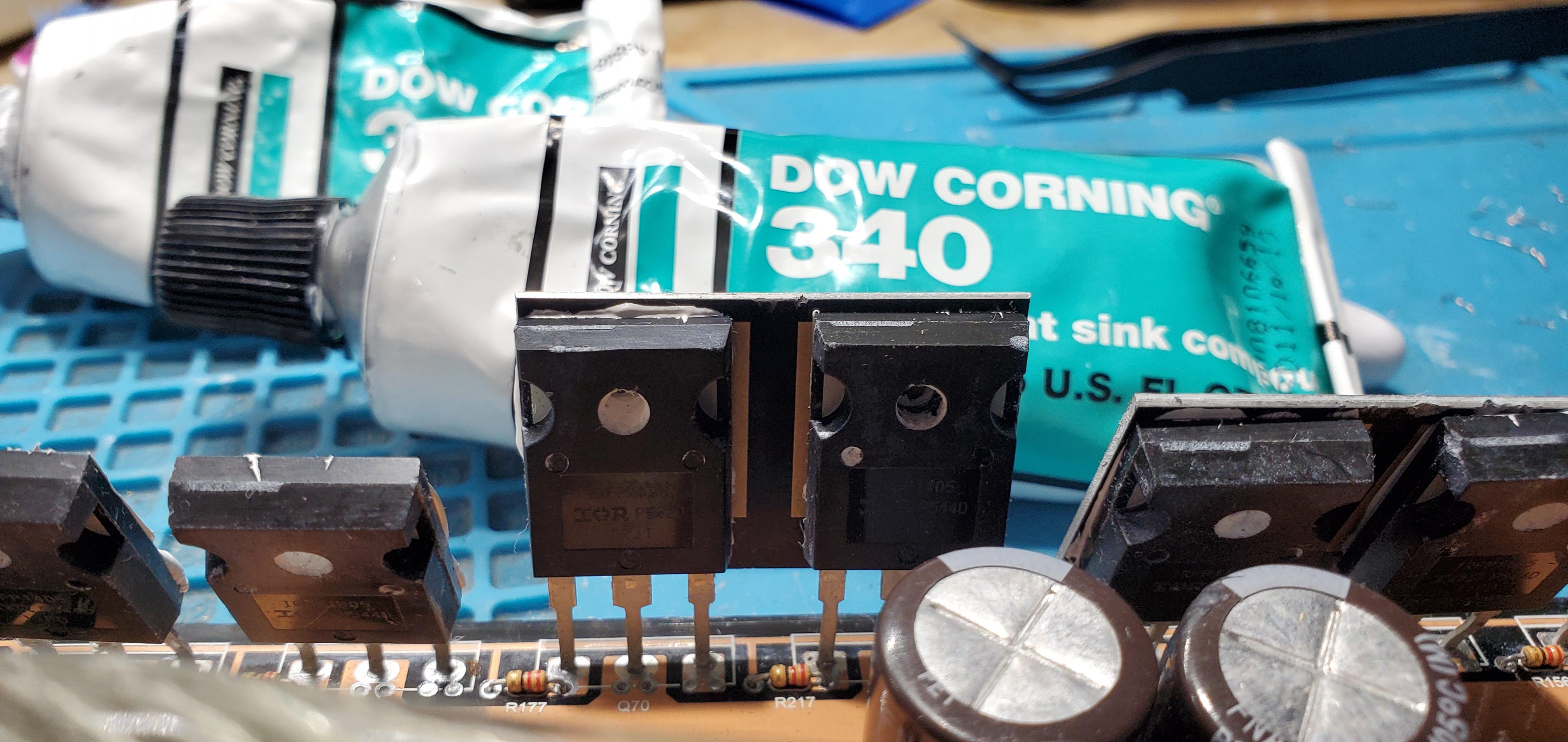

So does anyone have a photo of what this amplifier used originally on the power supply mosfets.
This amplifier had thermal spreader pads on the power supply mosfets.
And the tan silicone tape on the outputs but the blue sticky type tape still stuck to the backs of the transistors and the new tape, none of the outputs were seated properly.
Im just wondering if these pads are supposed to be on this amplifier?

He confirmed that the heat spreaders are common.
I was responding to him about the noise.
Adding mica to the stack would make things worse. The heat spreaders generally only make the transfer of heat better when they're soldered to the transistors or when the heatsink is rough.

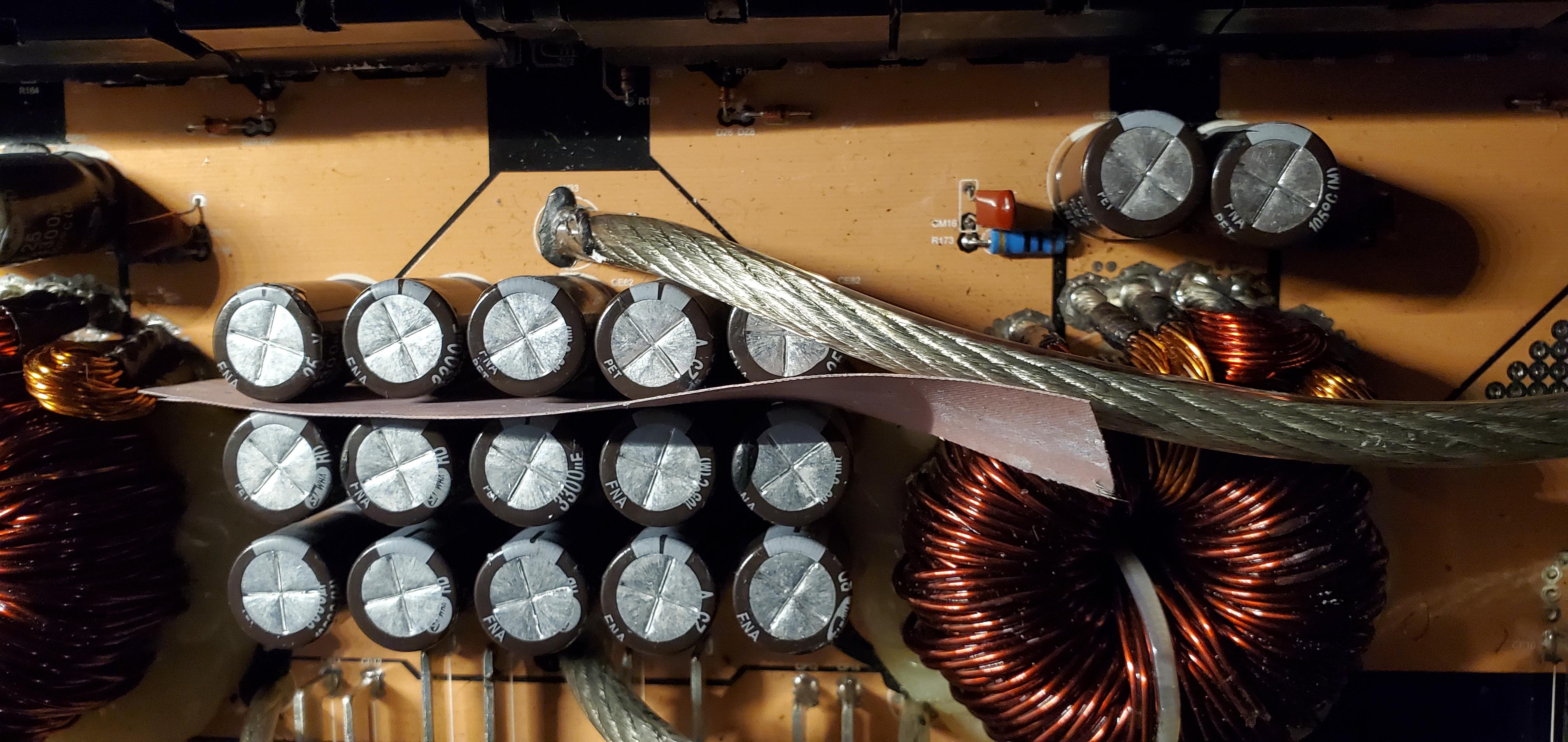

Where can i purchase this type of pad or something like it? I would like large enough pads to ensure no fet is passing voltage to the sink.
