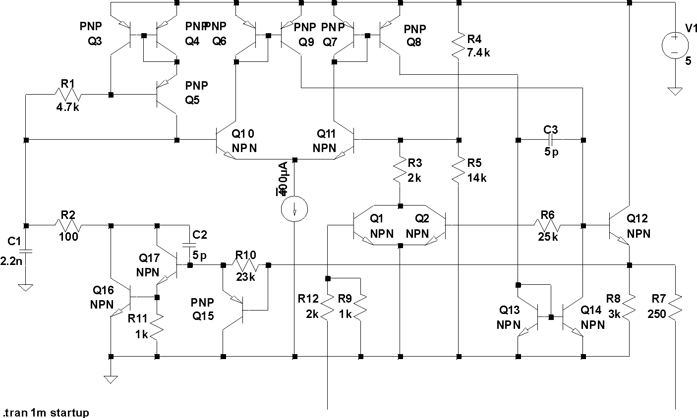

Hello all,
I find mistake in SG3525 datasheet, the comparator have wrong polarity transistors. I did simulation because still cant figure how to synchronize two or more of them. I have spice model for LTSpice, but i am not sure in accuration of the model in osc section.
I will do some tries, include hardware. But if someone have real circuit with use of these SYNC and OSC pins, i will be grateful ....

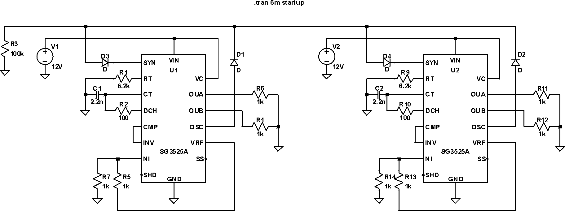

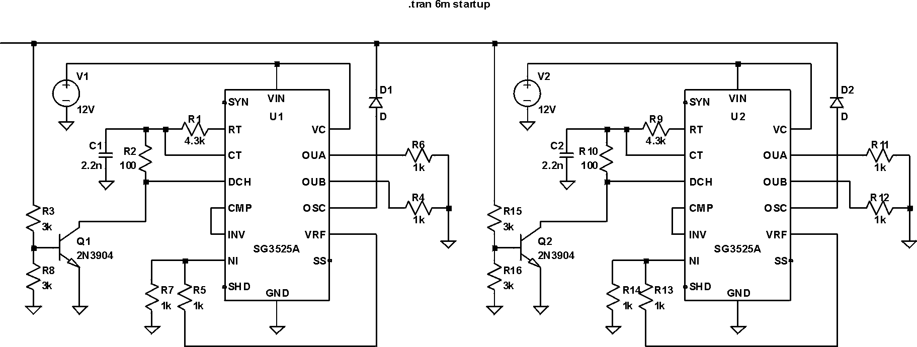

There is just an idea in second picture - terminate the slower cycle with pulse from fastest one. But still without this SYNC pin.
Hello all,
