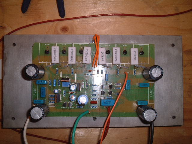

I am trying to get the first channel of my symmetrical amplifier (designed by Anthony Holton) running, but I'm having some trouble setting up the output stage. I've been waiting for an e-mail response from him for a few days but I'm quite eager to fix this problem so I figured I would ask the forum.
The power supply works fine, voltage is a little high at +/- 74-76V, and the voltages on the board all checked out before installing the output stage.
I first plugged the amplifier in, DC offset was a few millivolts, and set the bias as usual, then realized that some of the output Mosfets were getting no bias (there was no voltage across their source resistors). After a few minutes there was a small spark and two of the output stage Mosfets blew (I unplugged it immediately). The rest of those along with Q10, the biasing transistor, checked out OK with multimeter tests. It turns out a few connections were loose since the pins on the Mosfets did not reach fully through the PCB (I'm not sure if this is an error in the PCB's mounting system or if I made a silly mistake). Nothing was burnt, no smoke or anything, just the gate was shorted to drain on those two fets.
Anyway I got two more Mosfets that were matched close enough, soldered small pieces of wire to extend all the pins to ensure good connections, and double checked everything before powering up again. So when I plug it in, I see DC offset varying from 1 to 1.2 volts, and there is no voltage across any of the source resistors in the output stage. Where did the bias go?
My questions would be: what parts of the circuit should I check to verify that the rest of the amplifier has not been damaged? And what would cause a DC offset and lack of bias? I am not familiar enough with the amplifier's design to troubleshoot this myself.
Thanks very much for any help, I really appreciate it.

The above post can be mostly ignored because it turned out that I had switched the base and collector leads of Q10 (wired off-board) after I had taken it out to check it. What a stupid mistake... I fixed this. All the other transistors on the board are working as well. I had some solderpads come off the board in my, but this was easily fixed with a few jumper wires.
Of course however, there is no free lunch.
After looking over the connections yet again, I turned on the amplifier and found 3mv DC offset. I set the bias to 18mv across a source resistor and kept adjusting it because it was decreasing over time (a few minutes).
Then there was a big pop, so loud it scared me. I think the red clipping indicator LED lit momentarily as well, but I'm not sure. Of course I shut the thing down (actually the fuses did for me) and checked everything. There was a little burning smell around the Mosfets, and no visual damage. I removed one of them from the board and it tested OK, thankfully. (In the circuit they all produce the same readings so I think they're probably all intact). Q10 looks like it's still working too. I am quite afraid to turn the amplifier on again and check it in operation (since that could endanger expensive components and my safety), until I have some idea of what is going on.
I've considered power-supply over voltage as a problem... I forget the exact value when I was running the amplifier, but now (30 minutes later) it is +/- 76.8V at no load. This is with a 50V transformer (which is recommended for the circuit), so I would think such a discrepancy would be acceptable.
I had read about N-channel amplifiers going up in flames because of not mounting the thermal sensing device on the same heatsink on the output stage, so I had piggybacked it on Q11 (one of the N-channel Mosfets) with silver thermal paste and held it down with superglue on the edges. So I don't think that's the problem either.
What happened? This time I really thought I had it right. Sorry to bother you guys... and even some moral support would be greatly appreciated. Thanks again.

Halojoy,
The 18 millivolts is across a .22 ohm source resistor, and there are four Mosfets per output bank (N and P channel), setting the bias current at about 330mA. There is no protection anywhere in the circuit except a 5 amp slow blow fuse on each voltage rail.
Another thing I thought of was that maybe because of imperfect matching, the bias on some of the Mosfets was way high. The amplifier uses a 20 turn pot for biasing... it took like 15 turns to get any measurable voltage, and then the next turn took it past 18mv. Possibly the bias on the other Mosfets was very high because of this sensitivity to adjustment... well, I don't know. The resistors are 5% tolerance and the Mosfets were matched within 0.03v if I remember correctly.
The sound reminded me of when I was carrying my other power supply around and the wires touched for a moment... a snap or pop leaving a warm smell. I don't remember seeing a spark or anything. I think I will take out the rest of the Mosfets and make sure they are all in working order, because it would be really something if this failure didn't damage anything.
Well, at this point I may as well just check all the components again, probe around with the circuit off and wait for some more ideas to pop up. I guess I'm just a bit paranoid in not wanting to fire this one up again (or the other channel which is ready and waiting) until I know what the deal is.

Looks very nice Jason, I see that is the N-channel amplifier that seems to be more popular than the one I have? How does it sound?
I have Xicon 0.22 ohm 5W/5% wirewound resistors soldered to the bottom of the board. And I hope heat is not a problem, since the heatsink is at worst 0.28 C/W. I have two channels of Zen V4 at 1.3 amps (~140 watts dissipated all the time) mounted horizontally on one of those and it's at a safe temperature.

Sam,
On this board the N-channel devices were matched to between 3.94-3.96v and the P-channel between 3.88-3.90v. This was done by simply hooking the Mosfet up with an 18v power supply and 120 ohm resistor in the matching circuit given by Holton, and measuring the voltage across the pins. He does state they should be matched to +/- 100mv, which is a pretty wide tolerance.
Thanks for the suggestions, I will check all the components this afternoon. I don't have another transformer readily available, but I think I can temporarily wire this one's primaries in series to halve the voltage. I can't say I have an hFe tester or oscilloscope either - just analog and digital multimeters. Don't have enough non-inductive power resistors on hand to try that modification, either. I'm afraid I am poorly equipped.
So I will definitely try adding power supply coupling caps and grounding the heatsink... along with checking over everything again and removing all but one pair of Mosfets. I'm low on spare parts but I can borrow from my other channel for the time being.
Is it safe to run this amplifier at full supply voltage using just one pair of output stage Mosfets? Heck, I should rather be asking if it is safe for a person like me to be running this amplifier at all. 🙂
Anyway, thanks a lot guys. I'll see how my detective work goes today.

Naula,
Good to see someone else is taking on this project. Hopefully with good testing equipment and more experience you will not have the same problems as I did.
I have read the construction manual and did the pre-flight test... all the voltages were right on the mark. It was only when I tried to bias the output stage that I started having problems. The first problems were due to my stupid mis-wiring and now I have damaged some things because of that. Just be careful with your own amp... I am a good example of what not to do.
So anyway, I removed the output stage and performed the pre-flight test again. This was the result (correct values in parentheses):
R3: (1.6V) 0.60V
R5: (1.6V) 0V
R15: (1.0V) 0.06V
R12: (0.5V) 0V
R13: (0.5V) 0V
R8: (14.6V) 14.61V
ZD1: (15V) 15.14V
R11 (offset): (0-0.1V) 51.5V... wow.
I lost another P-channel Mosfet and two N-channel Mosfets from the output stage. Let's hope I don't destroy any more.
Judging from these results it appears as if the input stage current source is OK, but everything else is screwed up. It looks like I will be replacing all of the transistors. Does anyone know of a U.S. source for these small signal devices that does not charge high shipping and handling?
What I'll do is pre-flight test the other channel... re-drill the PCB's mounting holes so the Mosfet pins are long enough... and be extra careful. It would be nice to get one channel running to boost my confidence. Thanks again for the help so far.

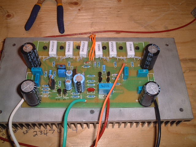

2nd channel worked
Hi again,
I have completed the second (first one working) channel of the amplifier and it works, which to me is quite a relief. However, I connected the output to the large solderpad on the PCB next to ground (which I assumed was the right place for the - output) and after a few minutes of music at moderate levels, R9 (10 ohm resistor to ground; I used 0.6W version) started smoking. It's quite burnt as you can see, it used to be light blue.
Duh! Well, of course if you connect 10 ohms between the speaker and ground you will pass a lot of current through the 10 ohm resistor. This is the kind of brain-fart I'm trying to avoid. 🙂
The lesson here: if you are building the symmetrical amplifier, don't solder your output wire into the spot on the PCB where you might think it should go - connect it directly to ground.
So I replaced the resistor, reconnected the output and it works again. But who knows, this could have damaged something else. The replacement parts for the first channel are on the way. Again, thanks for the help.
Hi again,
Hi, I have one last question. 🙂
How am I supposed to mount Q10, the Vbe multiplier device, on top of the output stage Mosfets?
I used a dab of silver thermal paste in the middle and applied superglue to the edges to hold it down, which I assumed would create a good enough thermal coupling. However, the tops of the Mosfet cases are noticeably warmer than the top of the BD139 casing... they are around 45C I think (fairly hot) whereas Q10 is barely warm, which I assume cannot be a good thing for the stability of the amp. I am wondering how others who built the N-channel amp mounted the similar device from that project?
I read the thread where Arne K's amp went up in smoke from improper thermal stability and I've been reluctant to turn up the volume on this one because of those concerns.
Is the thermal coupling I have adequate, and if not, what do I do with this thing?

I would also like to know!
Hi!
Have been woundering how to do that myself..... "piggyback"
Use thermal paste or a silicon pad between??!!
Wouldnt it be possible to mount Q10 on top of the O/P device with the same screw?? or wouldnt Q10 come close enough to the "core" of the O/P?
Richard

As you can see the mounting hole on the BD139 is far smaller than that of the IRFP240 and I would be afraid of damaging the die by drilling to enlarge it. Electrical isolation is not a problem with the plastic case of the Mosfet.
Arne, I have an overvoltage (as high as 77V) power supply and difficult speakers as well. Degenerative resistor power should not be a problem... at 500 watts output into 4 ohms there would be 11 amps RMS current, spaced over eight 0.22 ohm resistors so each would have to dissipate less than one watt.
BTW, how does it sound?
Did Mr. Holton ever tell you just how closely coupled Q10 should be? Maybe I could rip it off the Mosfet, put in longer wires and bolt it to the aluminum bracket there? (Actually, that would probably be an improvement over what I have now). I am having trouble reaching him by e-mail.
but...
The IRFP240 has Ø-3.6mm and the BD139 has Ø-3.1.
I used a M3 bolt to mount the BD139 on top of the IRFP240, worked out well, but is it good enough?
